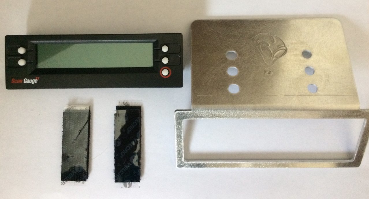

    I got my Paranoid Fabrications Scan Gauge ash tray mount today.
    Some rattle can flat black and a little more Velcro tape and I'll be good to go.

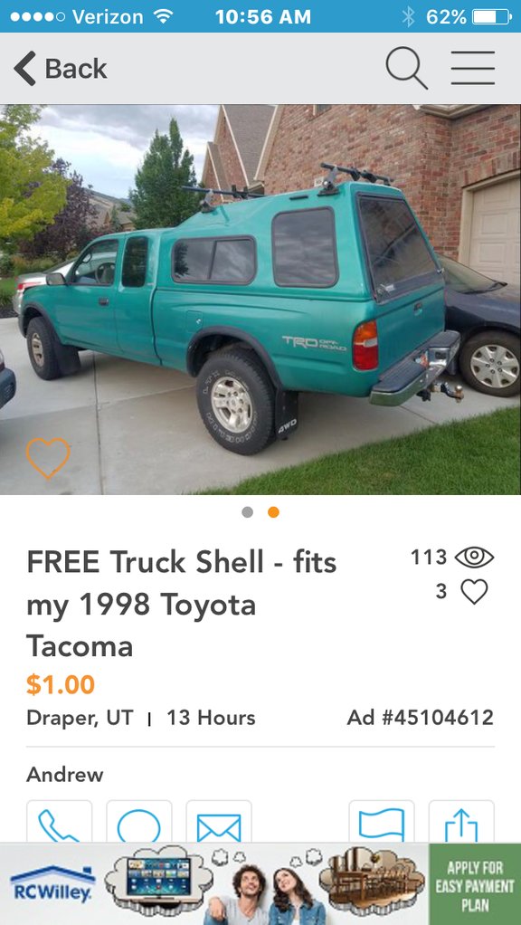

    I was tempted. Just don't have time.
