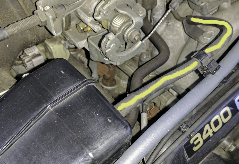

    Roman
    Elk,WA
    1st gen Trd Tacoma
    ChadsPride likes this.

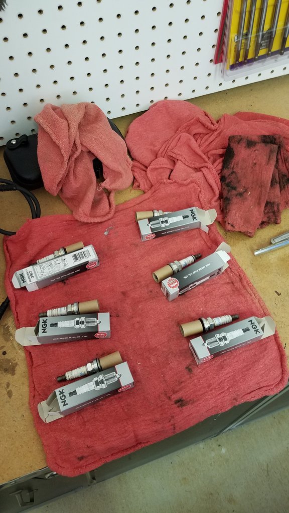

    Swapped spark plugs in record time! Continuation of some PM I've been trying to tackle lately. Additionally, I'm chasing an intermittent single detonation that seems to coincide with the A/C compressor kicking on. Been hearing it at higher RPMs/Highway speed.
