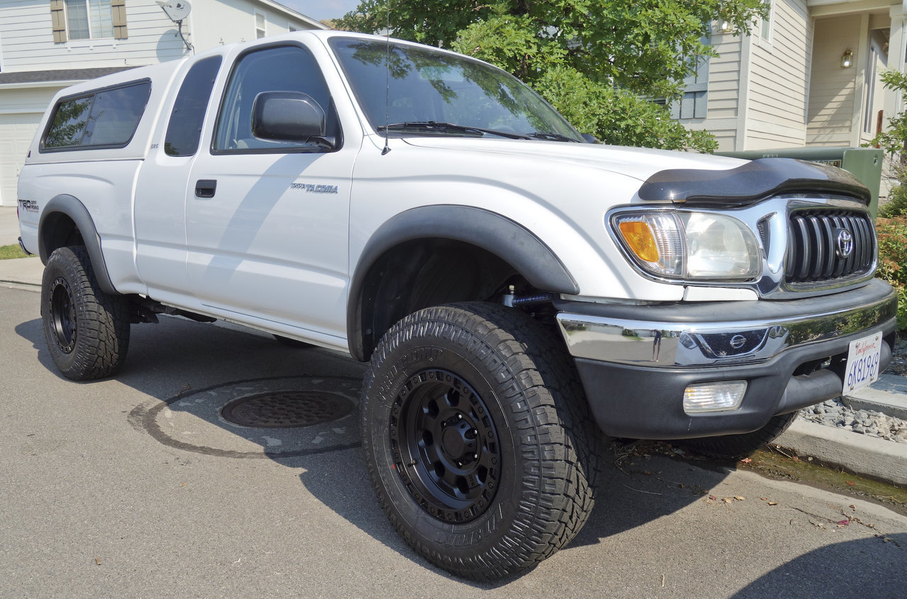

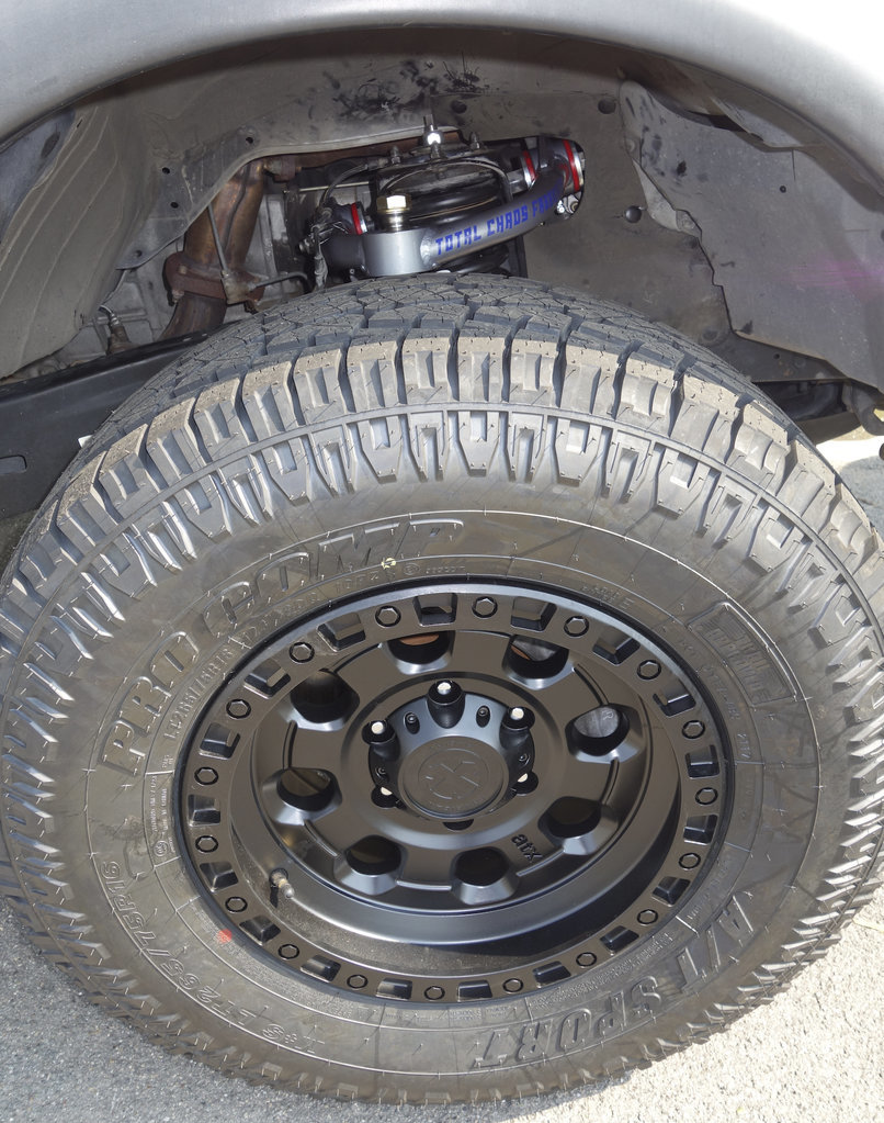

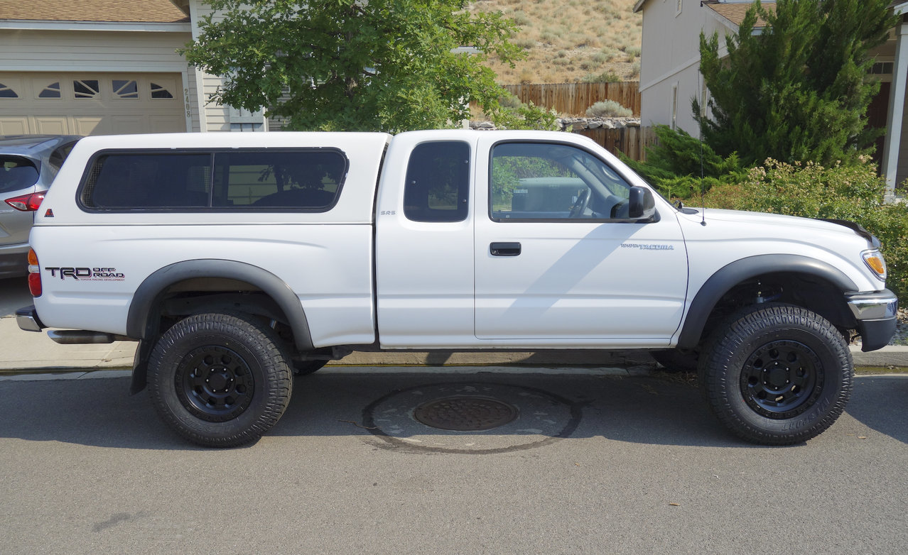

    This is my first post on the forum. I'm not very mechanically inclined nor much of a truck guy but I love Tacomas and I figured it's not too late to learn. This is my 4th Tacoma. I bought it off a kid who put a spacer lift with 2" spacers on cheap 17" pro comp wheels (134k miles). It drove like shit and I really didn't want a lifted truck anyway, but it was super clean underneath and couldn't pass it up (it's a manual). Well, I got a hair up my arse and did some research, talked to a buddy who's into modded 4 runners, and decided to open my wallet and get some mods. So far:
    -Bilstein 5100's all around set at 2.5" on stock TRD springs.
    -Total Chaos UCA's
    -Icon progressive AAL pack
    -American Racing ATX wheels
    -Pro Comp A/T Sport tires 265/75/16

    Welcome!!! Nice find :thumbsup:
