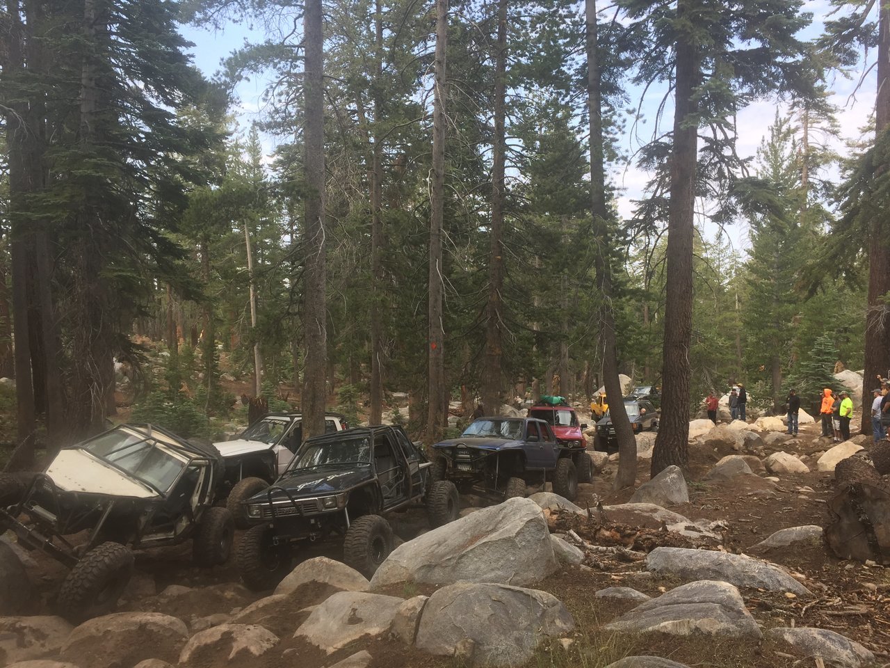

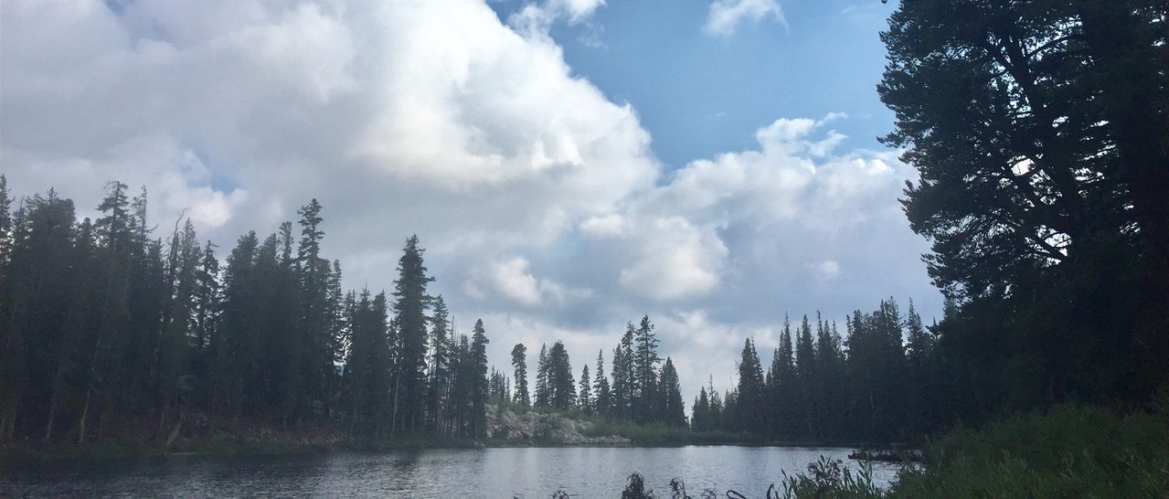

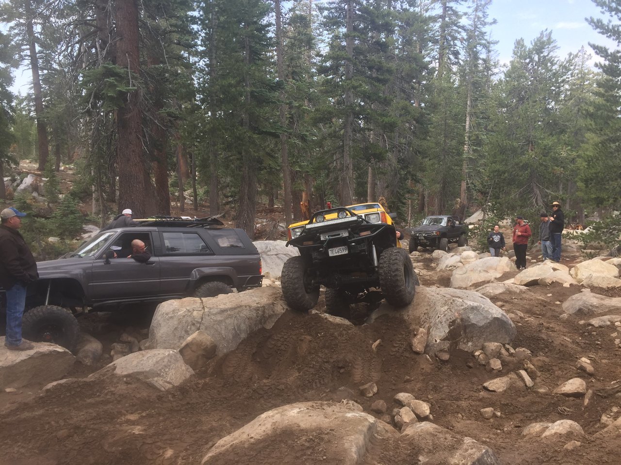

    IMG_8376.jpg IMG_8371.jpg IMG_8367.jpg IMG_8366.jpg IMG_8341.jpg IMG_8332.jpg IMG_8334.jpg IMG_8336.jpg IMG_8325.jpg IMG_8350.jpgRed&Cayote Lake trails ton of rigs hella good shows

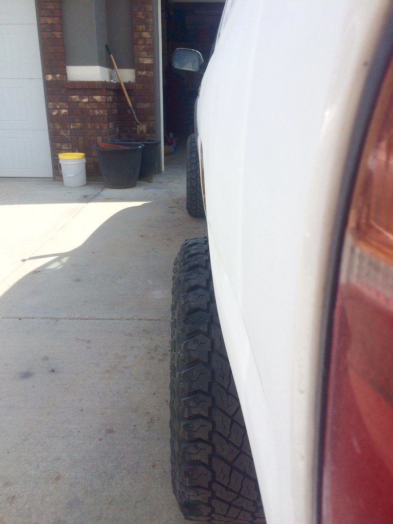

    Almost got all the sanding done. Just gotta pull the bed and do where I couldn't reach and some other small minor things...
    Loooks like shit but hopefully it turns out good.
    Also, my tires stick out like 1.5 inches without the flares...
    Is that what "the kids" are calling the stance game?

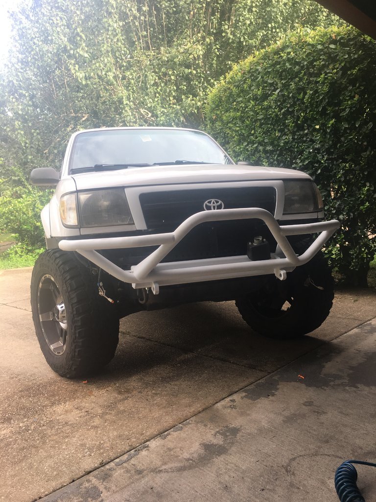

    When you're just a broke college student with a jeep bumper laying around you make due

    It's less Tacoma and more mod
    Looks pretty good to me, does it tie into the frame well? More pics?

    Just used the pre existing holes and ran bolts through, it'll make due for now until I get a winch plate then I'm going to weld it on for more support, still have to get some more pipe and get it to be flush under the fender

    Well that's convenient, Jeeps must have similar width frames. :thumbsup:
    Just a tip though, I'd weld on support plates to the bumper that you can line up with frame holes and more securely bolt the bumper on rather than have it permanently stuck on, plus you don't have much surface for only a frame weld to hold the forces of winching.

    Yeah I was thinking about adding some more to be able to mount to the original bumper mounts and give it more strength

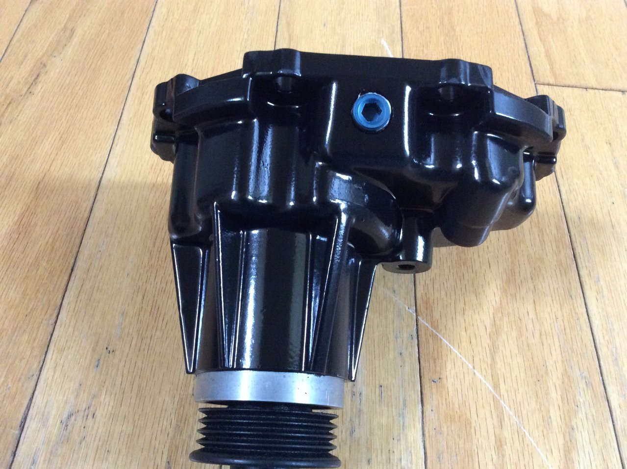

    New paint and Did an oil change for the TRD supercharger at 35,000 miles and added a butt screw to the top of the supercharger nose housing for an easier change next time, so will not have to take the snout off again,
    You would think I would have done this years ago :)
