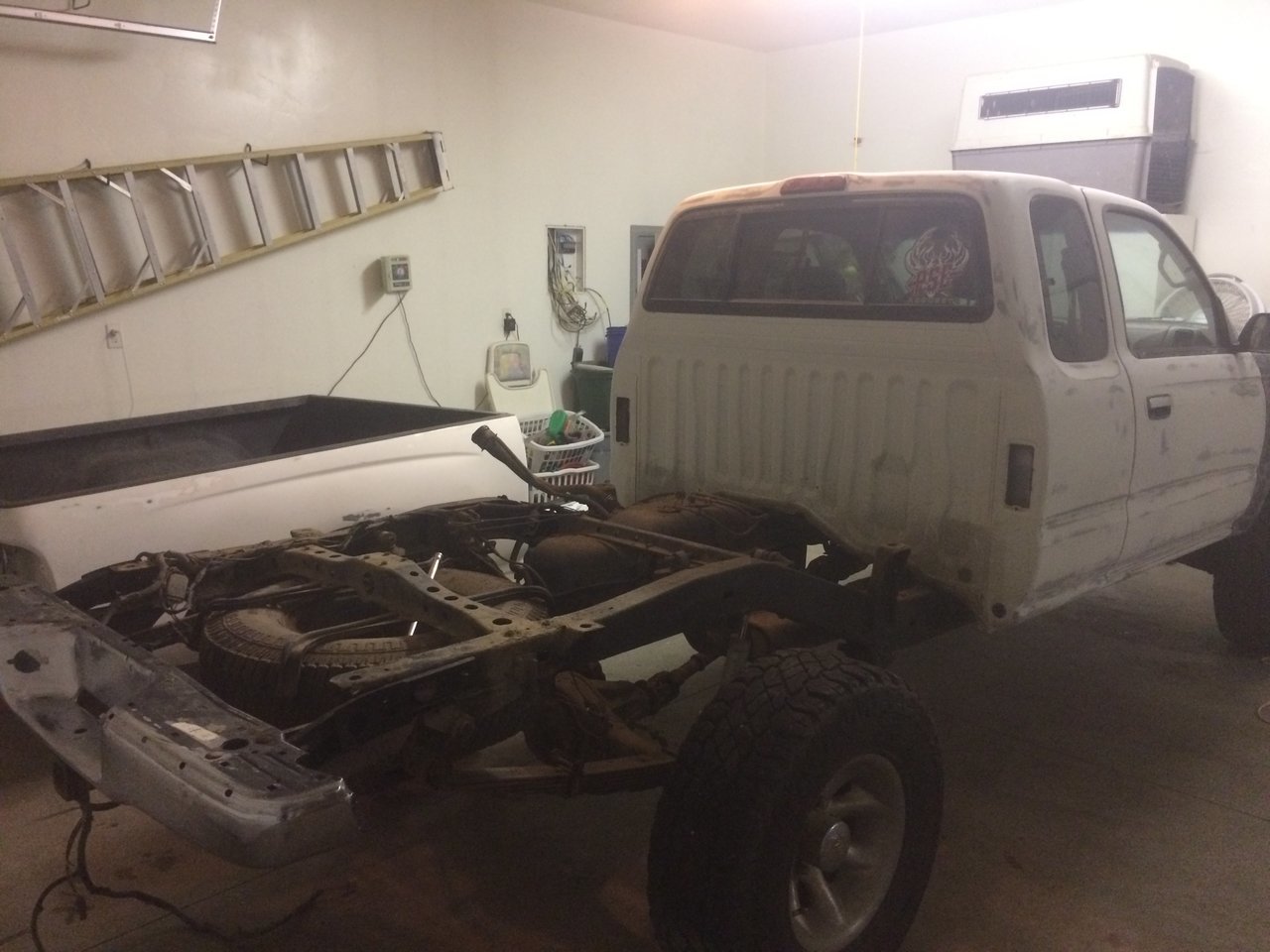

  15. Aug 7, 2017 at 8:02 PM
    JKO1998
    JKO1998 Well-Known Member
    Jun 2, 2015
    #156578
    53,022
    Utah
    Well that was harder than expected...
  16. Aug 7, 2017 at 8:03 PM
    Dalandser
    Dalandser ¡Me Gustan Las Tacos-mas!
    Feb 19, 2015
    #149090
    17,630
    Anthony
    Downey
    08 PreRunner Regular Cab / 98 4x4 Extra Cab
    Empty Wallet Mod
    How many people did it take vs how many you would have liked?
  17. Aug 7, 2017 at 8:21 PM
    JKO1998
    Jun 2, 2015
    #156578
    53,022
    Utah
    It took 2.
    The hardest part of getting the bolts and stuff off... could tell they had been there awhile.

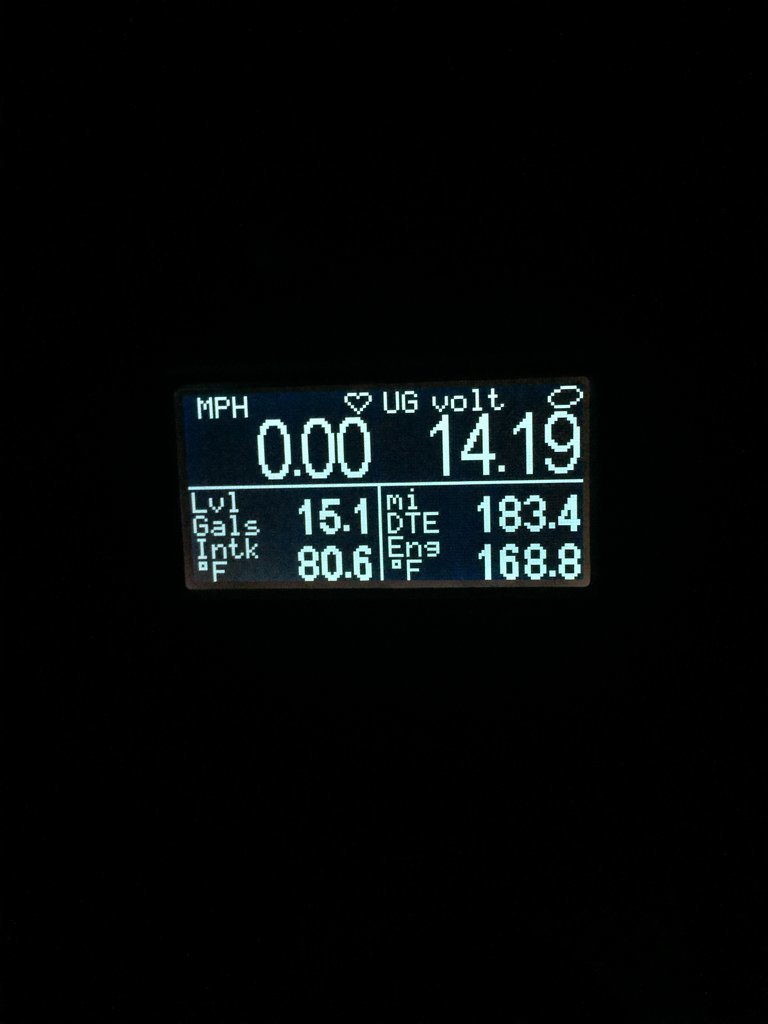

  20. Aug 7, 2017 at 8:34 PM
    SUGABEAR
    SUGABEAR Well-Known Member
    May 16, 2015
    #155357
    282
    MR.M
    SoCal
    Freshly waxed after a good wash. Finally got this little shit calibrated.
