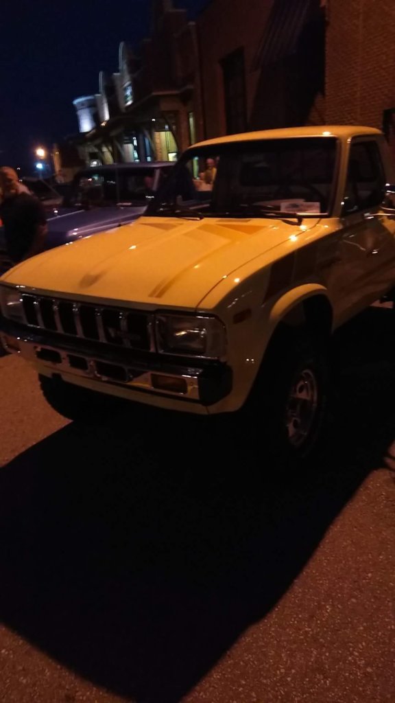

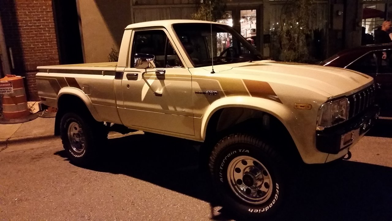

    Something I seen in town
    This thing is flawless

    That's badass.
