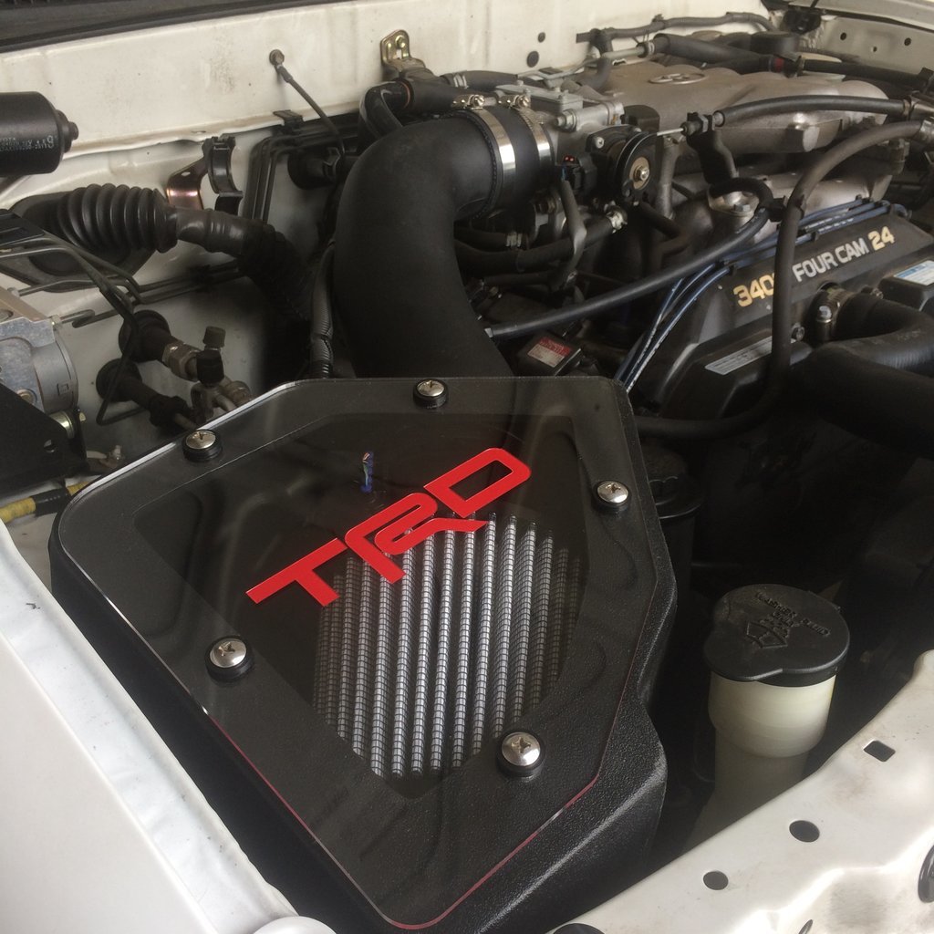

    Thanks for the info! I guess I should have qualified my statement by saying "without any major engine work." Would you see a performance gain by upgrading your exhaust + CAI without first doing the headers, or are the headers? I'm just curious, I don't think I'll be doing any of this to mine.

    The stock exhaust is perfect for the motor. For all around performance.
    Opening it up on our motors you'll loose low end torque but gain some upper end power.
    With fai opening the exhaust helps a lot.

    Without engine work it's not going to make that big of a difference. Headers and intake then exhaust, but if you're going to go that route then you might as well turbo or supercharge :oops:

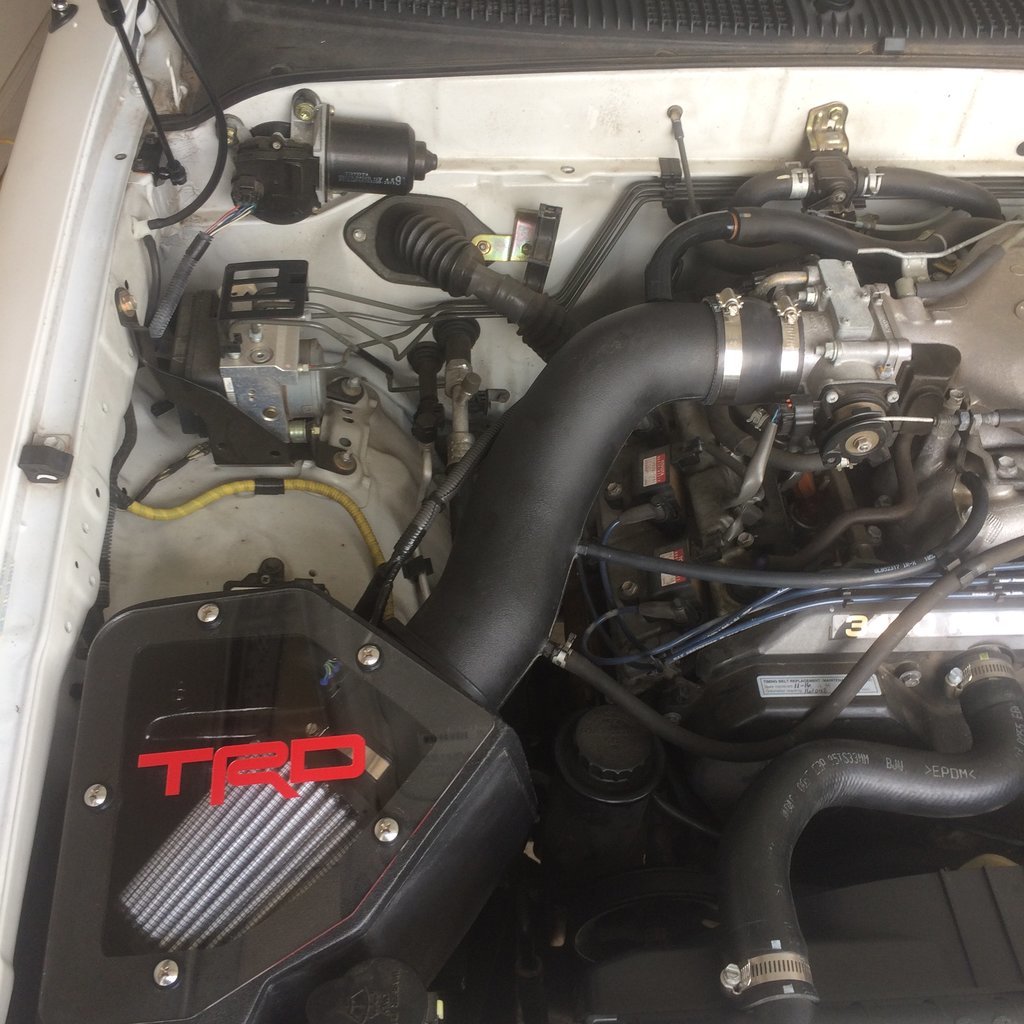

    Yeah I might have been a little touchy and if so I apologize to @Thurman Merman.
    I debated even posting about it because a CAI usually comes with some sort of chastising about how one has paid for snake oil. I'm proud of what I did today so I shared anyway.
    If there is an exact choke point I don't where it exists.

    Haha I didn't know you were the one that did that CAI install. It's super clean. I don't care about if people are making horsepower if they're happy with their mods.
    The numbers don't lie. Porting cylinder heads will make more difference than any other flow mod in power short of forced induction and that's how you can see it as the primary choke point. I liked your install on the CAI - I'd mess with mine if I lived in a state that didn't frown upon that sort of thing lol.

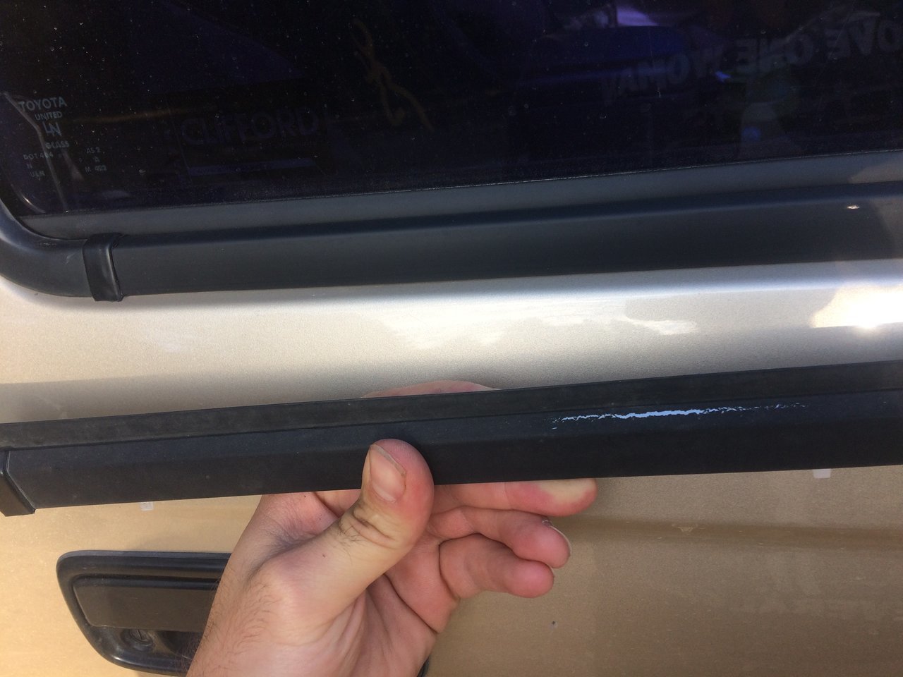

    Changed old door moldings
    One thing i learned the white tabs dont come aligned so it help to get them close to where old ones are to help with install
