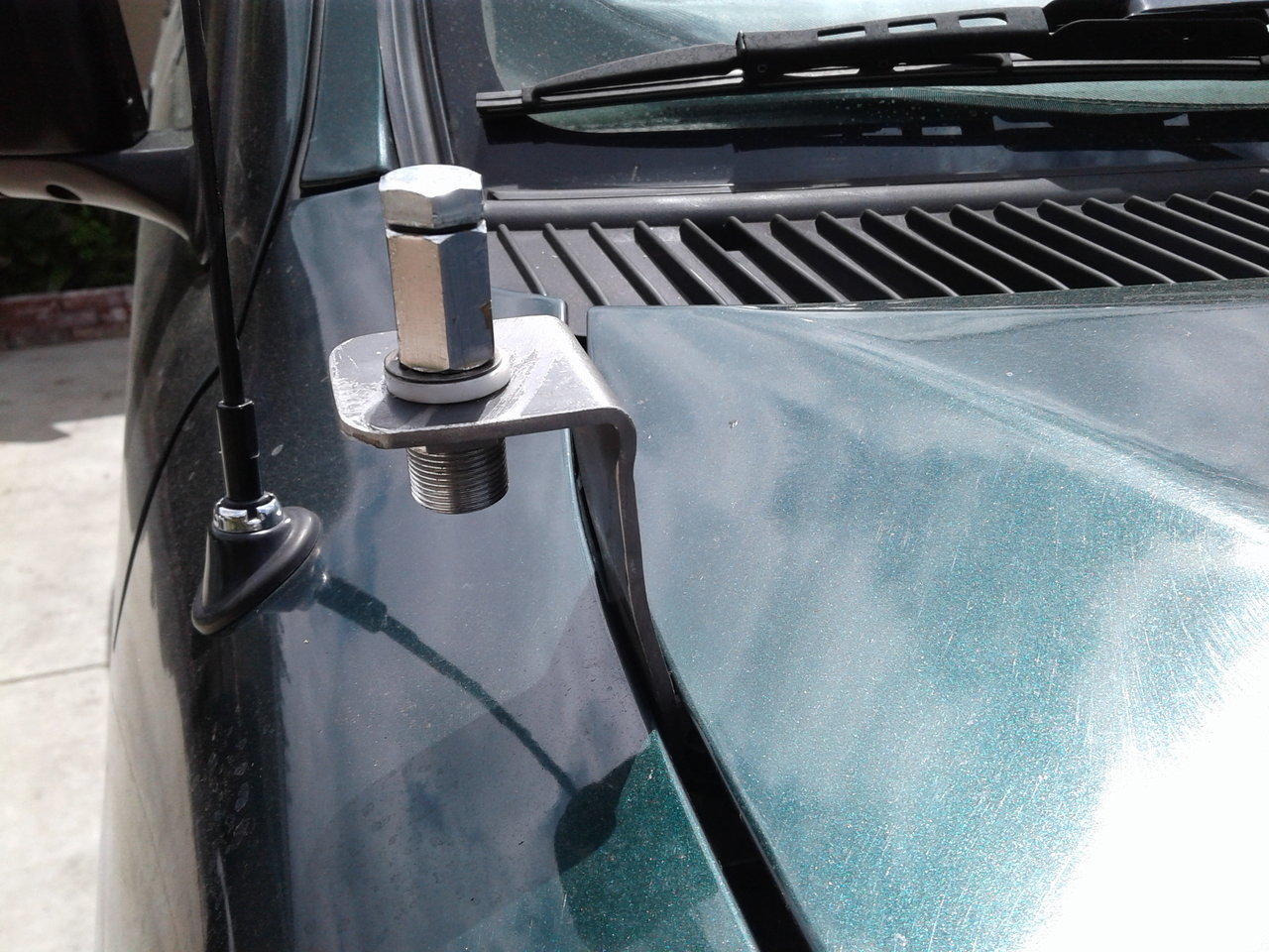

    I built my cb antenna mount, now ready for paint. Can I paint the whole thing or do I need to leave it bare metal underneath where the mount contacts the bracket?20170815_134350.jpg

    Bare metal where mount contact the bracket it's for ground.

    I thought so, but wanted confirmatiom.
    Thanks for the input.

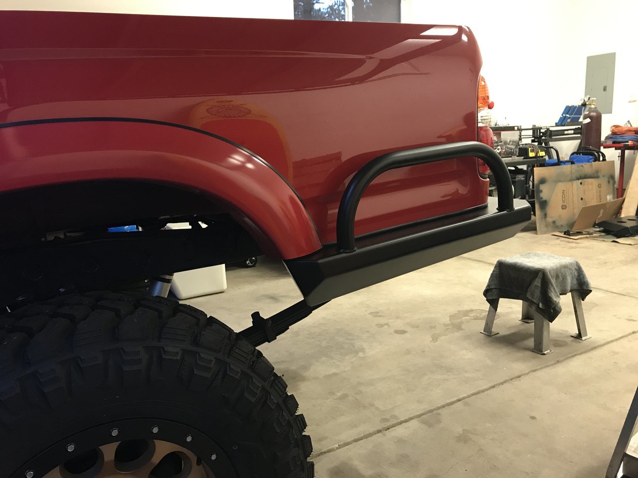

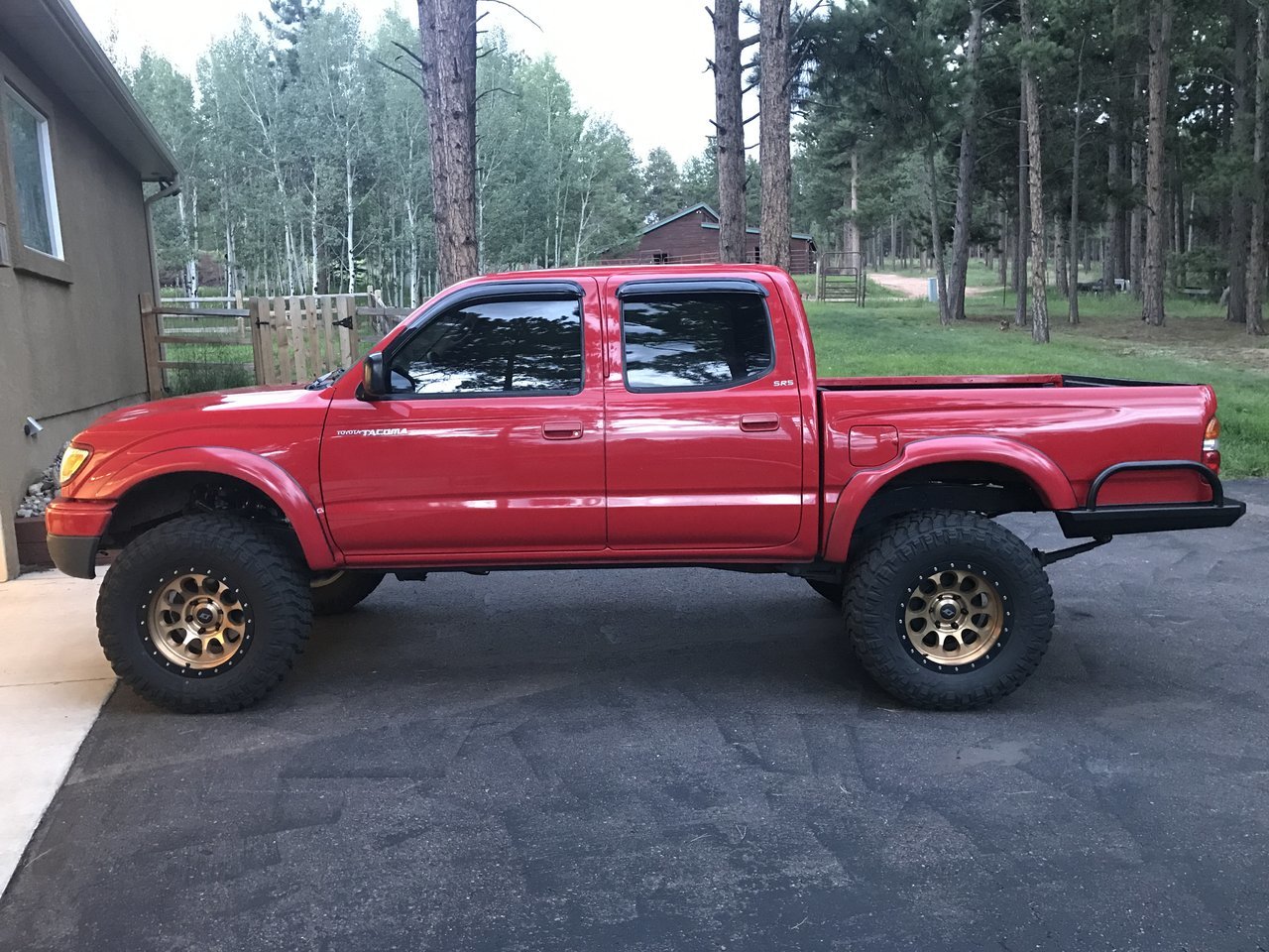

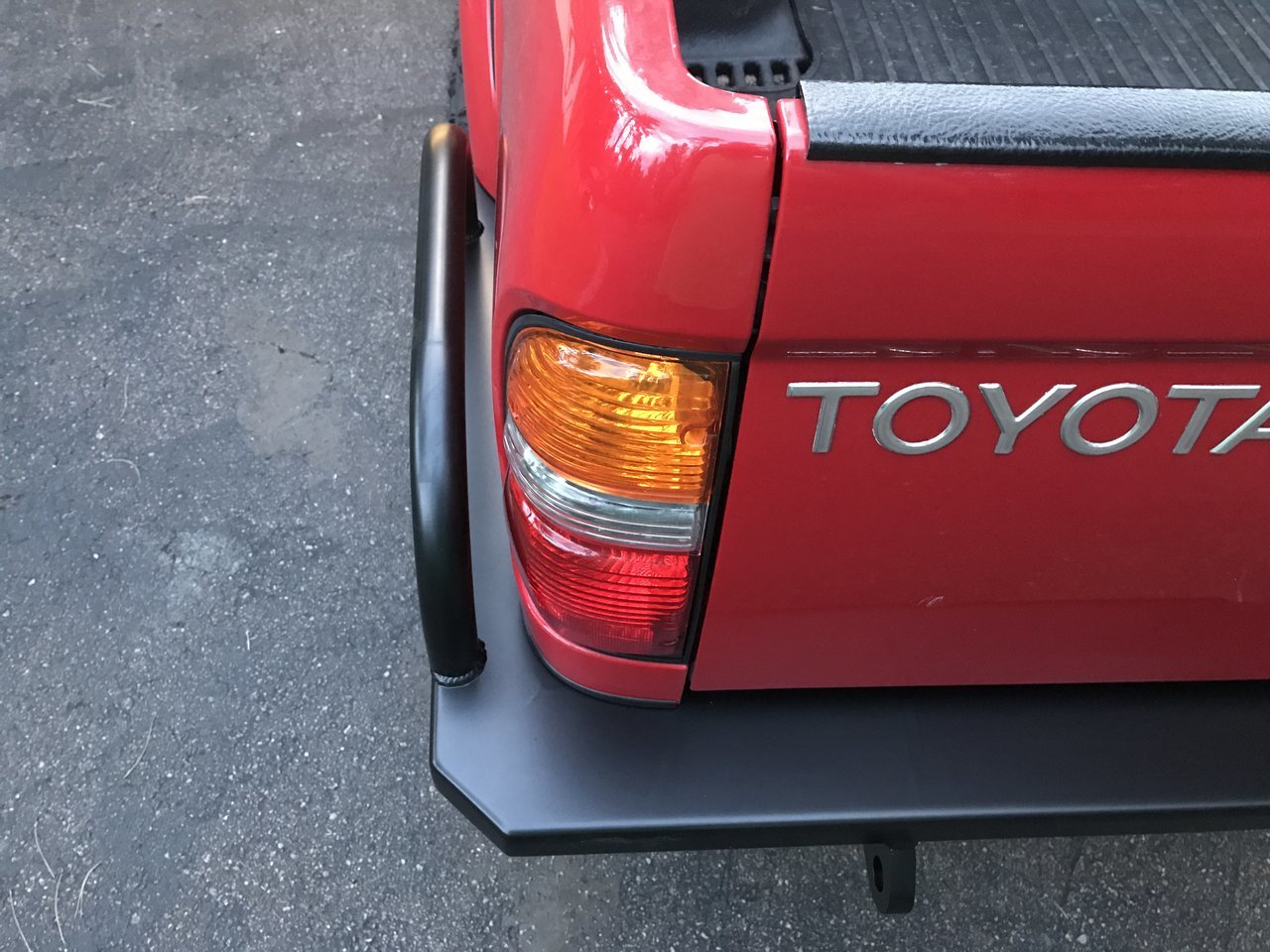

    Got my rear bumper installed for hopefully the last time. This past weekend I finished trimming the bedsides, smoothed it all out nice, painted the exposed metal and then got busy for the rest of the weekend with other stuff.
    Hard to see because of the black trim/molding over the sharp edge left from cutting the bedsides, but there is a small gap between the bed and bumper, hopefully its enough to not hit when flexing, if its not, I'll pull the bumper down and take some more sheet metal away with the flap wheel. Here are some pics to show different clearances and angles and such, really pleased with the fit and finish, install was super easy, everything lined up perfectly and was super square and flush...

    That is absolutely one of the prettiest truck's on here. The red and bronze is tits.
    Side note - does your rear tire fit into the well? Looks way off center to the front. Maybe it's just the angle. If it is off, you Might consider some axle relocate plates.
    Did I mention your truck is gorgeous?

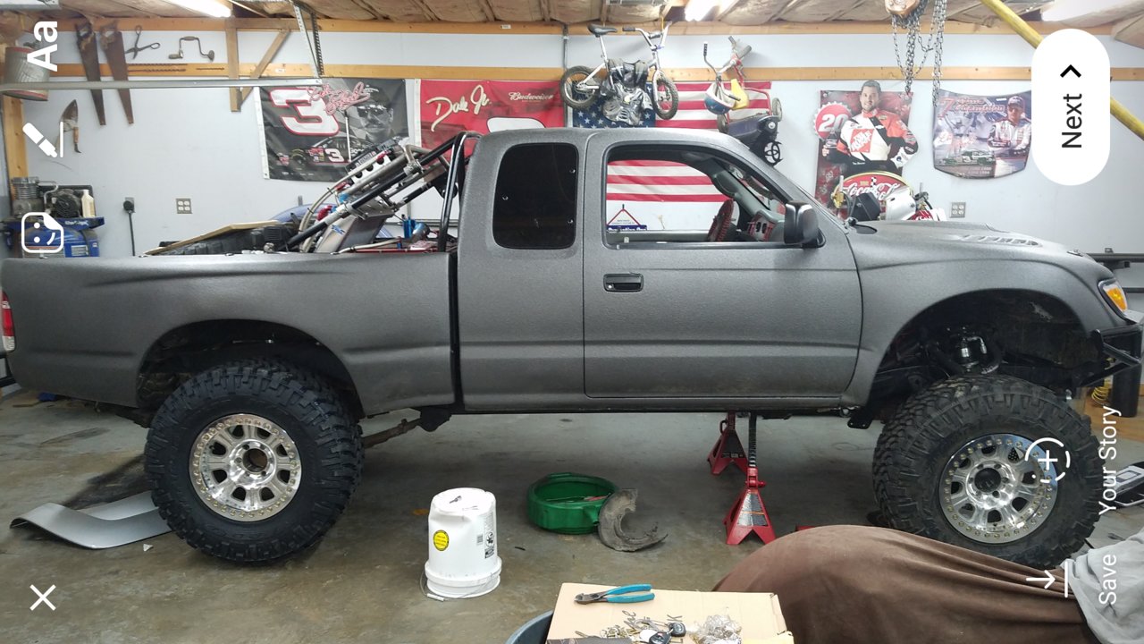

    Put my ray 10s and 285s on my 2011 so today i got these raceline monter beadlocks and 315/70/17 nitto trail grapps. Its on jack stands on front and rear, doesnt sit quite this high. 20170815_210316.jpg

    Is that a CBI Bushmaster 1.0 with custom side protection? Regardless if it is or not, that looks great! I was pretty much sold on one without the side hoops but decided to wait for Pelfreybilt to come out with theirs first, then I'll decide.
    Those OME leaf packs man. I still have axle relocation plates with mine to center the rear axle.

    As for the gap on the rear bumper - haven't had a problem with that on mine. Being the bed is solid mounted it doesn't really move and doesn't require a gap like the front bumper.
