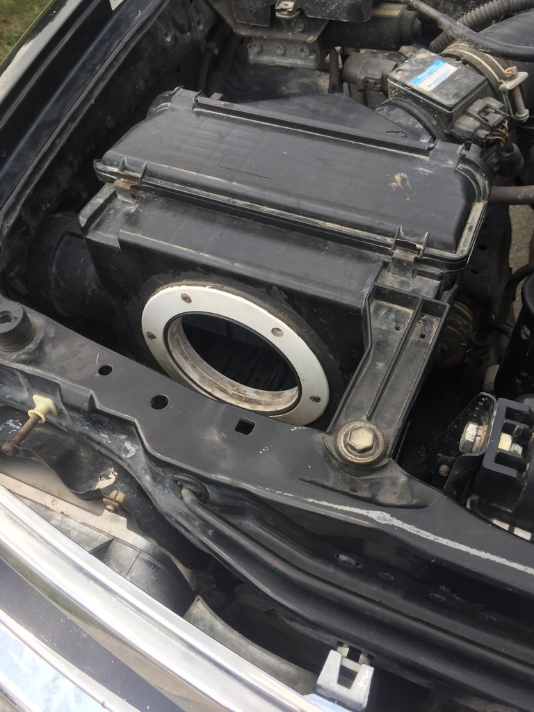

    Any idea why the PO did this to the airbox?

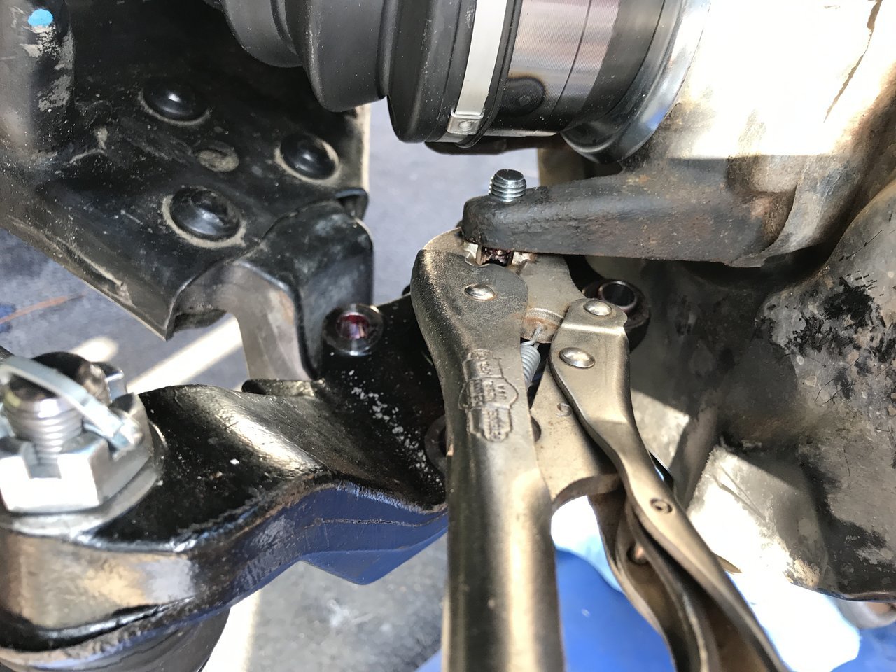

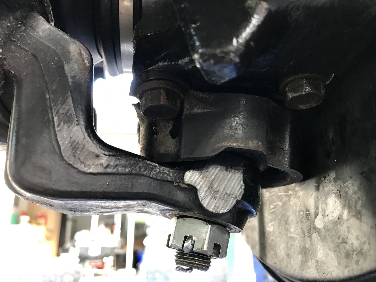

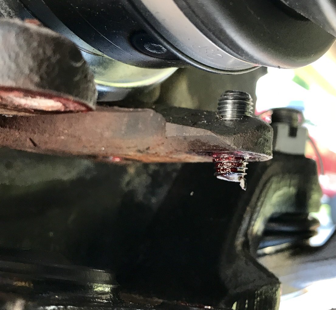

    This happened :eek:
    But it could have been worse though
    Misread the dang manual and overtorqued the bolt (dialed the N•m number and not the ft-lb number into my ft-lb torque wrench ). Threw the old bolts back in and ordered new bolts!

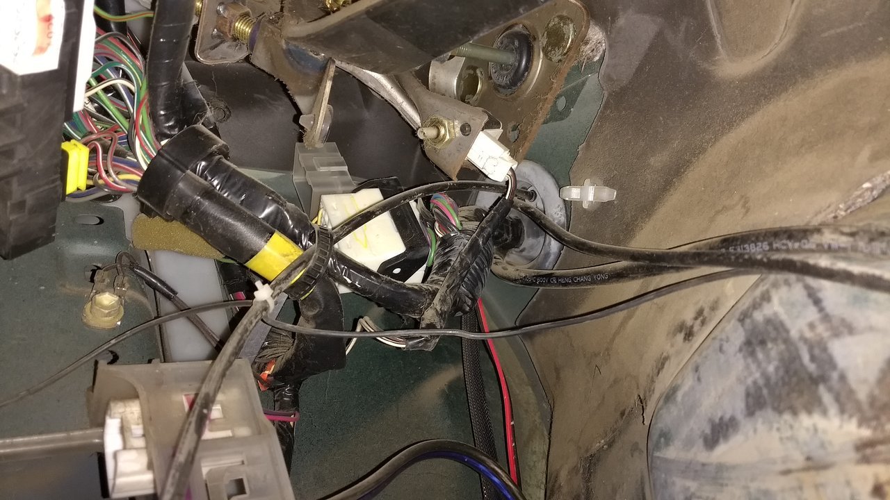

    I get that, but once in the cab does it split from the rest of the dash harness. How does one get it all out?

    Because they thought it would provide a performance boost, probably was a forum user. It's called the deckplate mod and it is a right of passage in the TW placebo effect dept.

    bunch of crap
    Amen man, none the less great springs

    Guess I'm not fully a TW member o_O

    Don't worry I'm not either, but I try to convince third genners it's worth it

    I'll never do it, as far as I can see it's not worth the time or money

    helps clear 95-97 retrofits is all i know

    PITA is how.
    I think most of it goes into the fuse box under the driver side.
    Why are you doing that? Aren't both the trucks the same?

    Oh okay, well hopefully that has some sort of plug back there. I am doing it because the evap harness is tied into the fuse box harness on the 95 but tied in the engine harness in the 96. And they have different connectors and valves so it's getting swapped too.

    oh...well that sucks.
    Thats gonna be a major pain. Might as well pull the dash then.

    I am going to, just couldn't see the truck until 5mins ago. Here's a pic, you were right. Looks actually pretty easy, just some plugs and a big grommet haha.15029392386431760958496.jpg

    Nice. Good. Been forever since i've done that haha

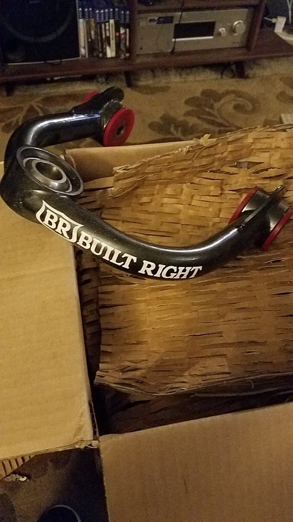

    20170816_175825.jpgGot these bad mofos today! Also changed out my plugs and wires and did a full maf and throttle body cleaning.
