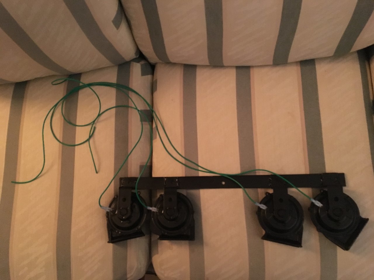

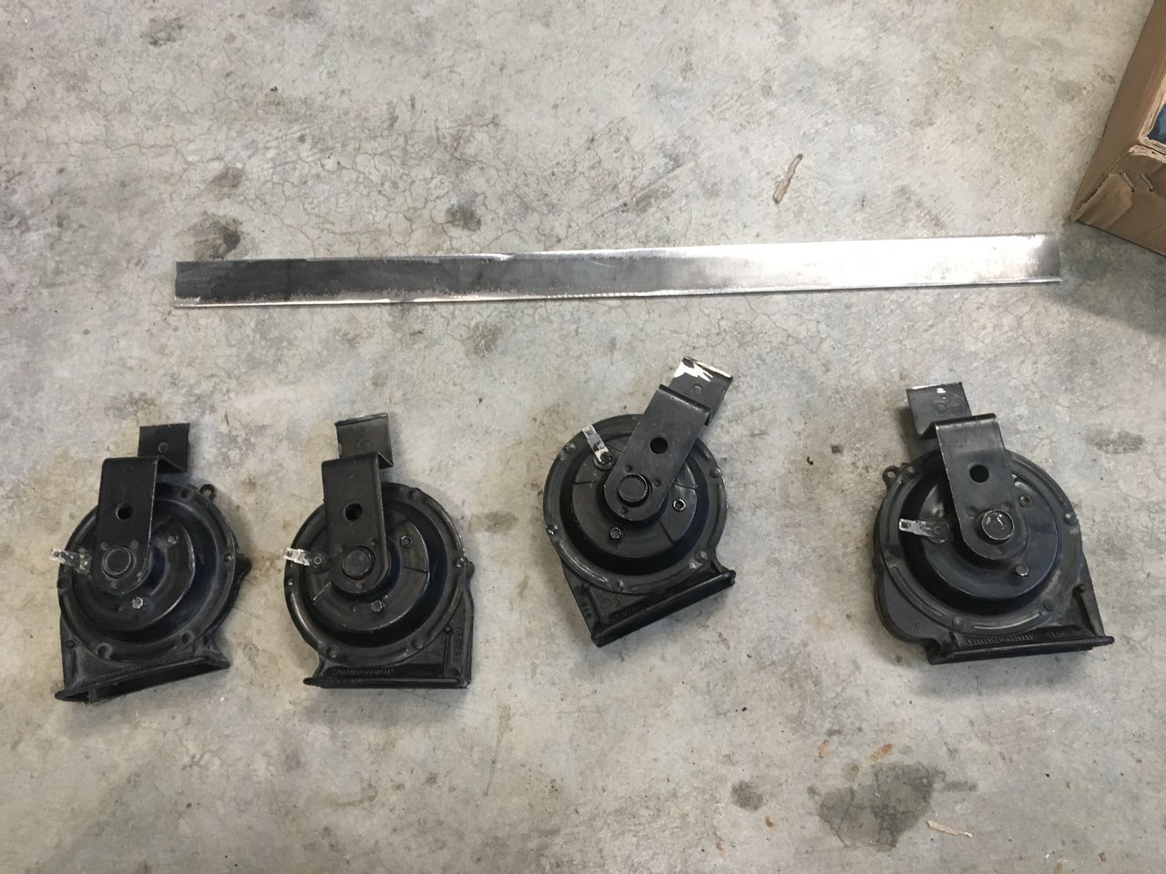

    So I was tired of the single stock Toyota high tone horn which made the truck sound like a Japanese Scooter.
    So I went to the junkyard and found a 1985 Cadillac DeVille that came with 4 horns, took them off, and put them on. Now it sounds like an actual goddamn truck! The horns in question were Delco-Remy A, C, D, and F note horns.
    I cut off the stock Cadillac mounting brackets and welded them to a flat stock of steel. I ran the four 12v wires and spliced them into one that fed into a relay that in turn plugs into the stock Tacoma horn system. I tried going without the relay but these horns draw something like 5 Amps each and it fried my stock fuse pretty damn quickly. I sanded, primed, and painted the whole thing so it looks presentable, even though no one is ever going to see it.
    I wired it in a way where I can have 5 TOTAL HORNS (yes, I'm crazy) if I really wanted to by utilizing the existing stock high-tone horn. I don't really like how it sounds with the stock horn so I just keep it unplugged. I bolted the whole assembly in the front valence where the radiator crossmember attaches, firing downwards. Now let me be the first to tell you there is a hell of a difference in volume. My buddy could hear it blocks away compared to my stock horn.
    Would anyone be interested in a setup for their truck? I wouldn't mind making a few of these. There's definitely no shortage of mid 80's Cadillac sedans around here in the Bay Area...
    Here's a video:
    Not Pictured: Complete Wiring Harness - this is just a portion of the 12v leads coming out of the horns.
    lucky13don, FLBAdrian, j0shu4 and 5 others like this.
