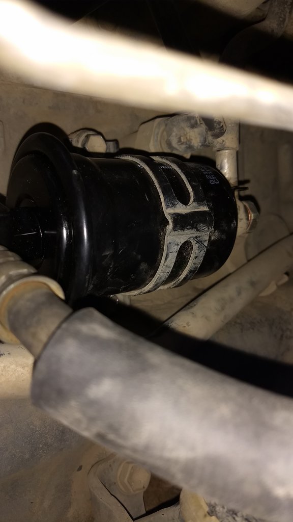

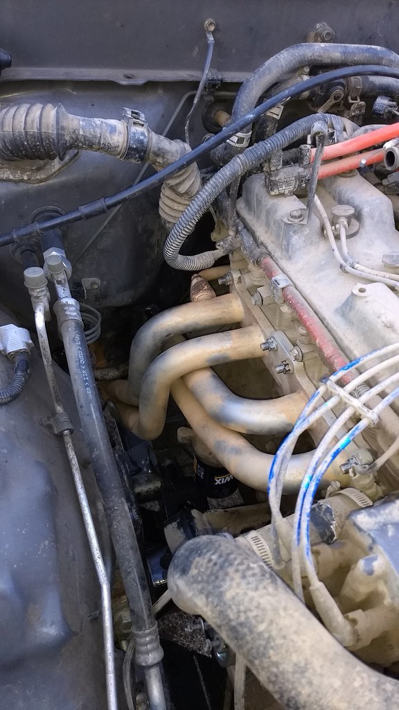

    Header is back in...

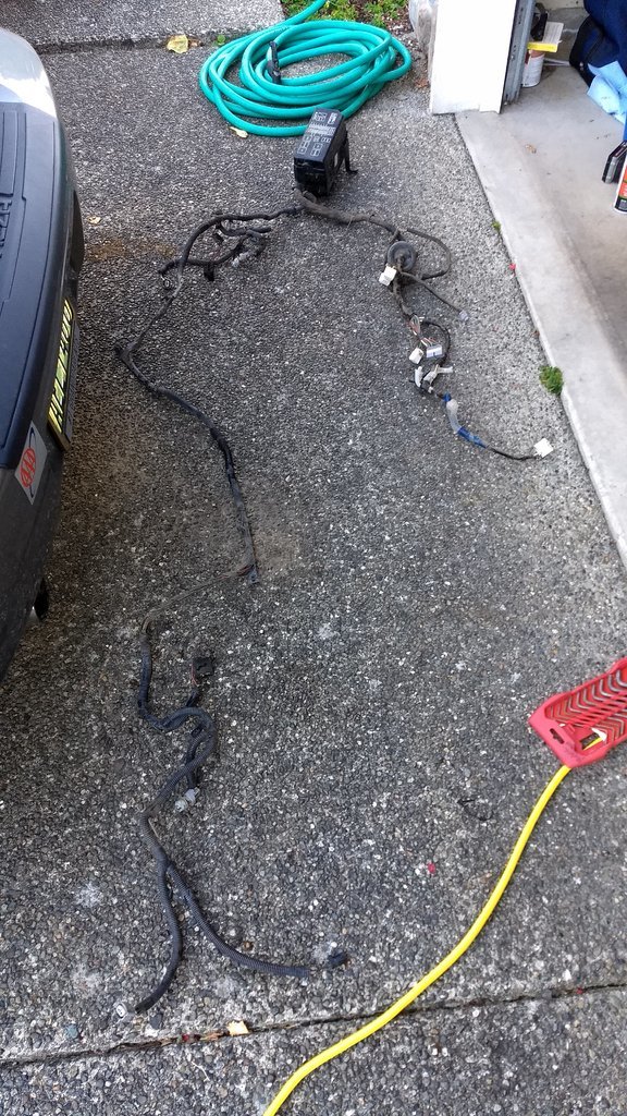

    Engine fuse box harness and various accompanying wires like headlights and turn signals came out too...
    Shiny new fuel filter too because I was in there anyway...
    For those wondering if I did that while it was easy to reach, no I didn't. I did it that hard way, intake installed and engine in the truck haha because the shipment didn't arrive in time.

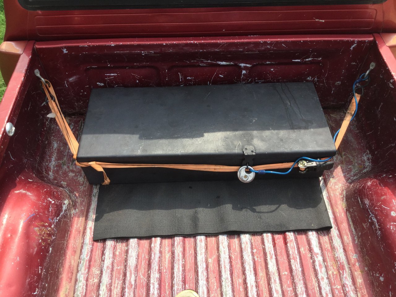

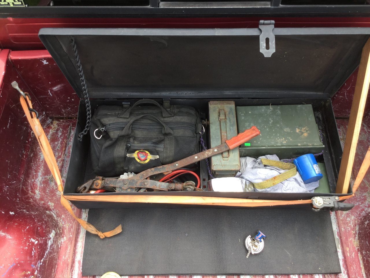

    I could never find a tool chest/box that would fit in that spot for the Tacoma. All of them are either made for mid-size trucks or full sized truck. I had to refinish an old Delta crossover box, but the small is small and I'm going to be running a rollbar so I need the clearance on each side to mount the arms. I found a really nice Weatherguard aluminum chest, but they don't fit by 3 or 4 inches because of the wheel wells. Fit fine in an old Ford Ranger, but our wheel wells are so far forward.
    I don't have the provisions to weld Aluminum plate, so I might just have to custom make my own toolbox or Frankenstein one off Craigslist. Seems like the only box that would fit are trailer tongue boxes.

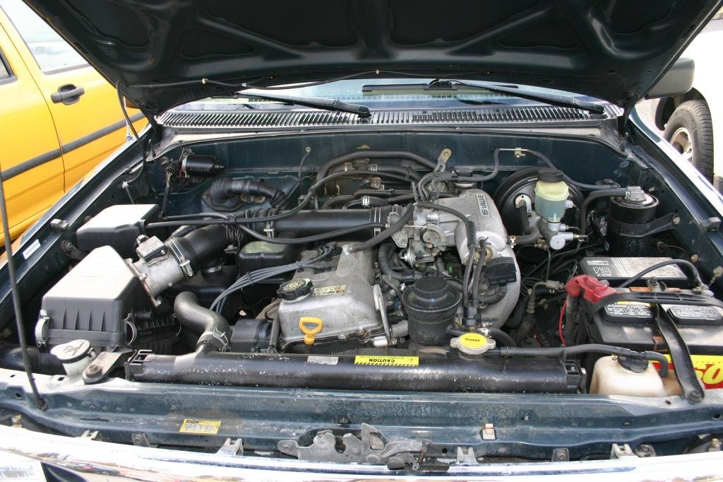

    I'm just curious, are you shoving all that emissions/EVAP crap back in there like the charcoal canister? The one on my '98 is a pain in the ass and takes up so much damn room above the battery. The '01+ ones were nice because it was mounted under the bed.
    Nice work so far.
  12. Aug 24, 2017 at 9:43 PM
    Speedytech7
    Feb 20, 2014
    #123587
    57,816
    FCQM+VG Cheney, Washington
    It's less Tacoma and more mod
    Yeah, 95 (only year this applies to) has a very tiny evap canister with one VSV. Every other year has the big one you're describing with 3 VSVs and a pressure transducer. I will be turning this 96 into a 95 for all intents and purposes. So it can pass emissions and such, it will look stock vacuum and emissions wise. Once I'm in Arizona I'll probably ditch the EGR just because it is a nuisance, but I'll retain all the emissions because they are a safety measure for gas tank pressure and fumes too. My evap looks like this for reference though (very old truck photo incoming)...

    Huh. I didn't realize they came with Evap canisters that small. I hate how big they got in the following years - what's the problem with the EGR?
  14. Aug 24, 2017 at 10:02 PM
    Speedytech7
    Feb 20, 2014
    #123587
    57,816
    The EGR on the 3RZ is just in a really tough place when working on the truck. It also is a very rudimentary system and contributes to the overall harsh idle they tend to have. Plus it just gunks up intake tracts because it is literally the same sooty exhaust right back into the intake. This reduces the cyl temps (look that one up if you don't believe it) and supposedly reburns anything that was unburnt the first time. It is mostly a tertiary system for meeting C.A.F.E requirements of the year. Super easy to bypass though with a single 10k ohm resistor and two block off plates. It wouldn't be so annoying if its duty cycle mapping was more responsive to vehicle load and temp. But since it is basically open all the time when the engine is up to temp it throws A/F ratios off and intake mass air off enough to cause roughness.
