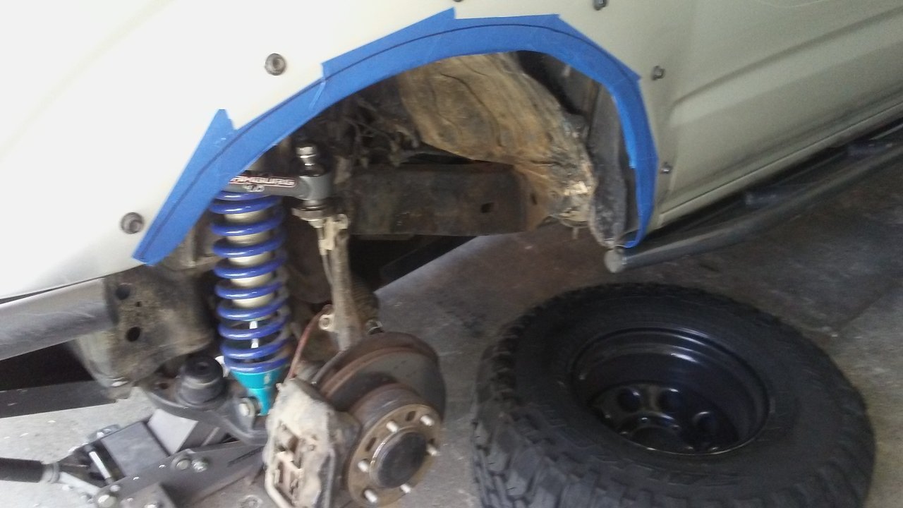

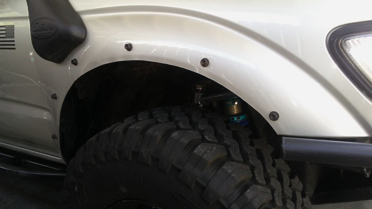

    Replaced my OTRE and took an inch off the fenders. She looks great
