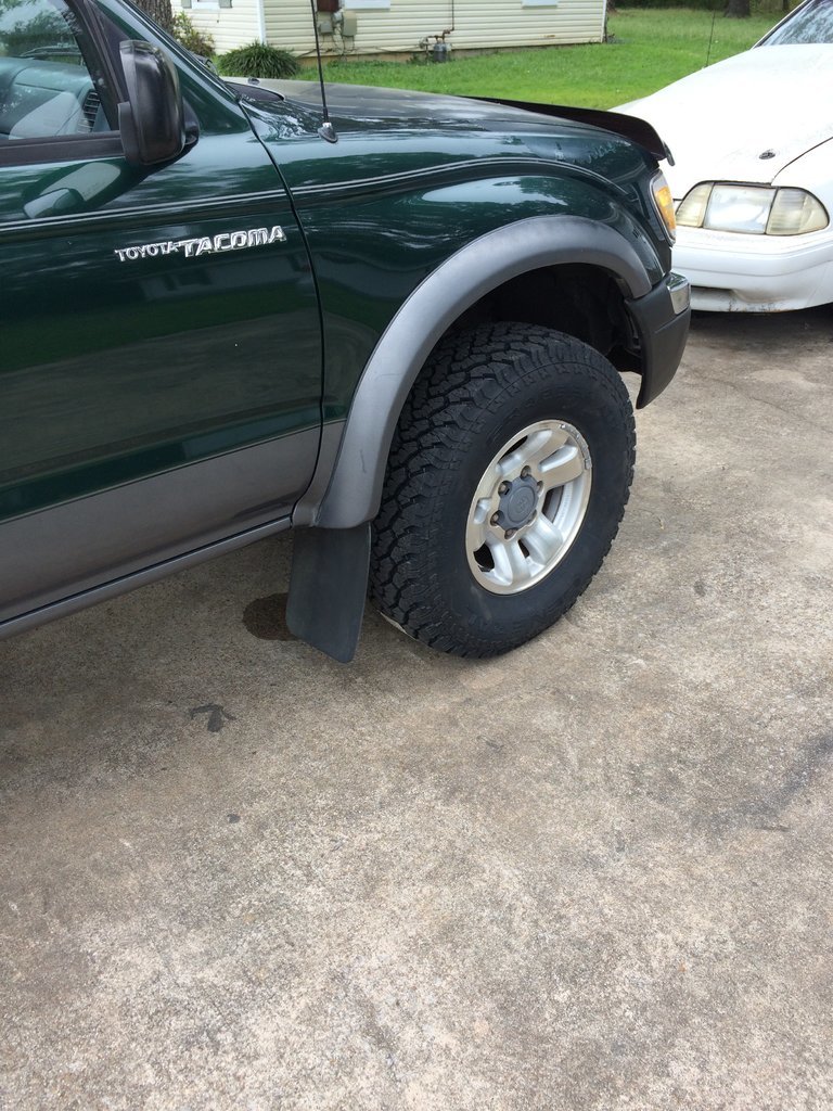

    New set of grabber AT 2. 31 10.5 15s. Love em.
    JKU3000, Caquon, sente3 and 4 others like this.
