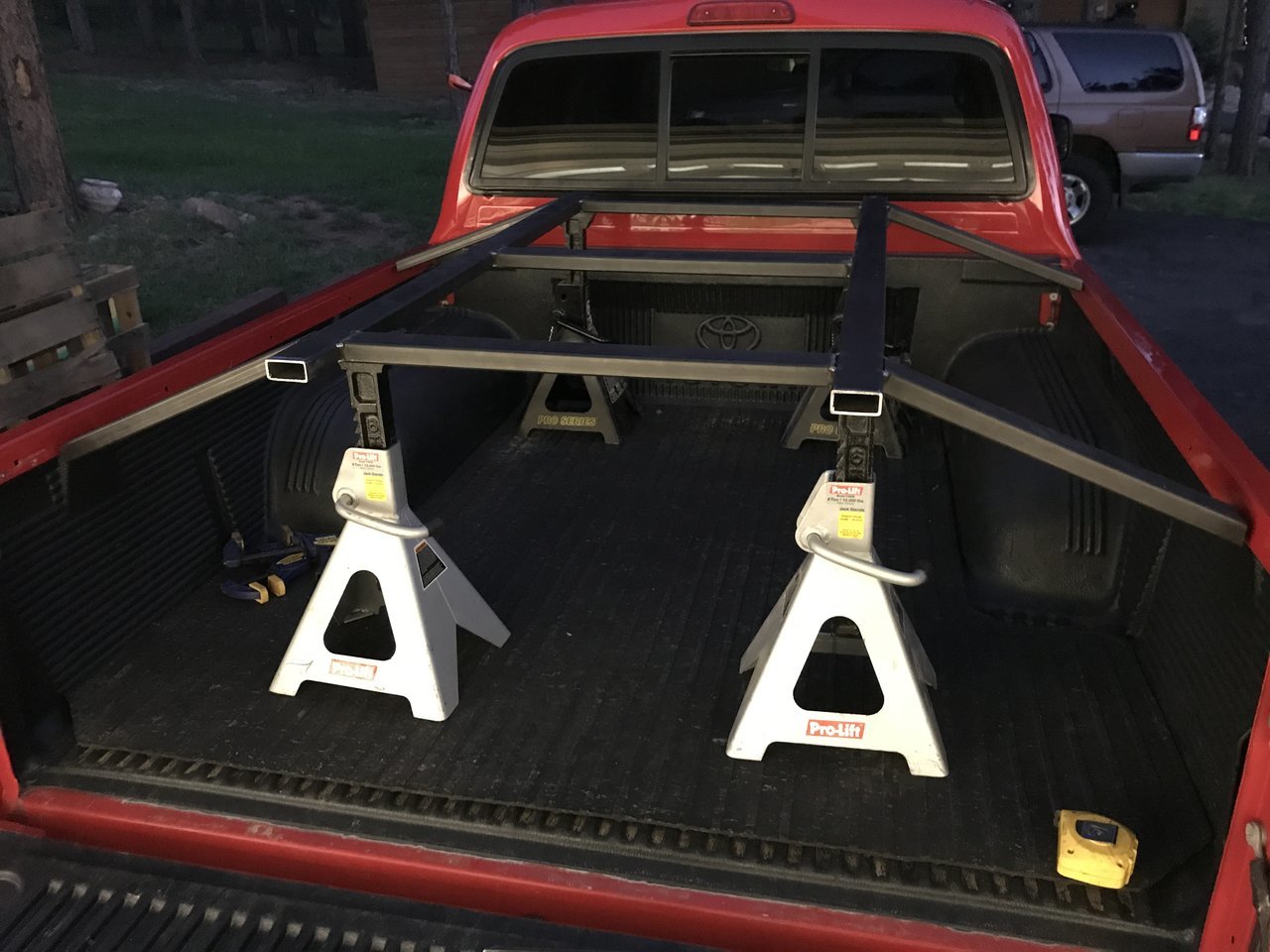

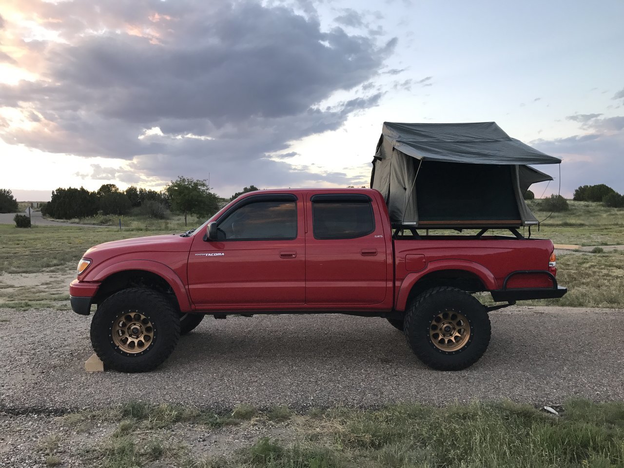

    Not today but, got a call thursday night from some friends that they were headed down to the reservoir to go wake boarding and camping saturday/sunday and wanted to know if we wanted to go. Planned to just ground camp in the sake of being short on time, but left work a little early friday so I decided to stop at the steel shop on the way home and build a really quick bedrack to hold our roof top tent.
    Turned out just fine and served its purpose for the weekend! Gonna pull it off in a day or two, throw some paint on it and sell it. Will build another in the near future but personally I want one that sits higher.
    Didn't take any detailed pics of it completed, but you get the idea from this one...
    All setup and holding the tent for a cpl nights...

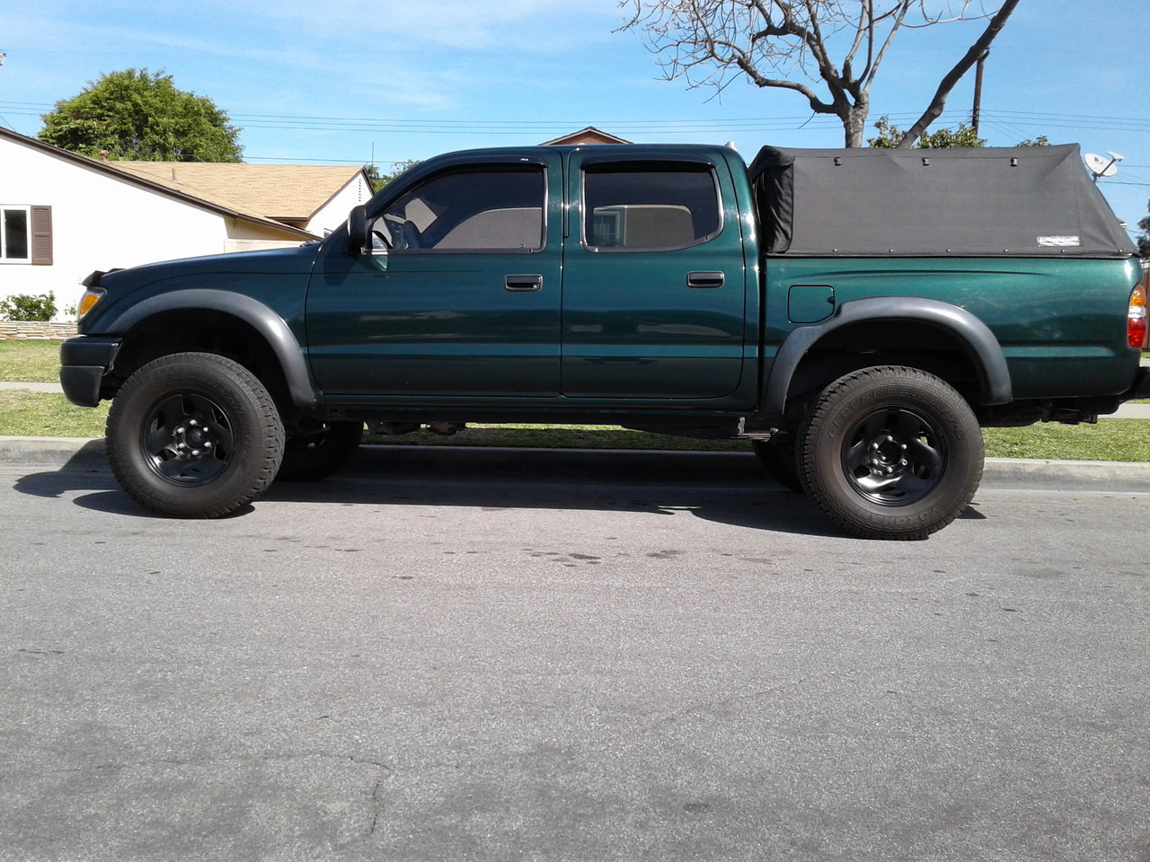

    I think it is due to the dakar leafpack. It is intended for lift and load carrying. If you had plate bumper, swingout, RTT, etc it would not be an issue. But with stock bumper and empty bed this is what you get. I went with 881, trim packer and 10mm lift enhancer and wheelers 5 leaf pack on my 03 dcsb and got 2" net after settling with good on road driveability and good off road performance, although a little soft for really big loads.20170307_095651.jpg

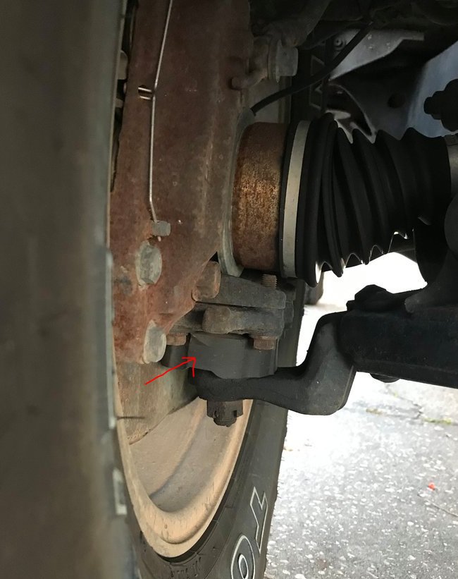

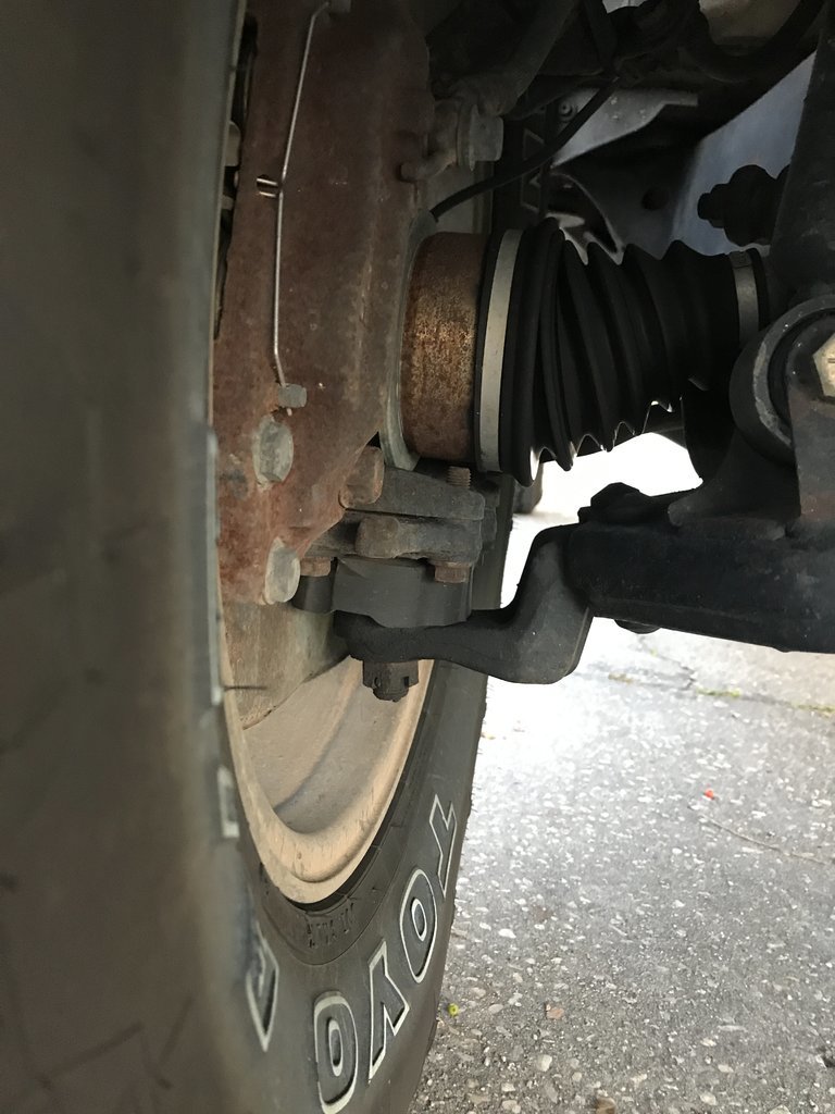

    I think they look weird. That boot looks less like a boot and more like a solid piece...

    That's just a cover for the boot, I have only seen them on stock ones. So I believe it's a separate piece that can be ordered. But I rarely see people do that, but I could be wrong :notsure:

    Correct, just a protective cover for the joint and boot. It can be reused with the new assembly.
    Replace with OEM

    Thanks guys. Mine did not have that...you learn something new every day :)

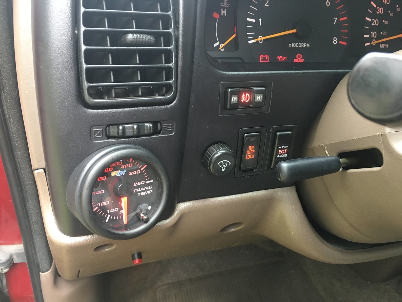

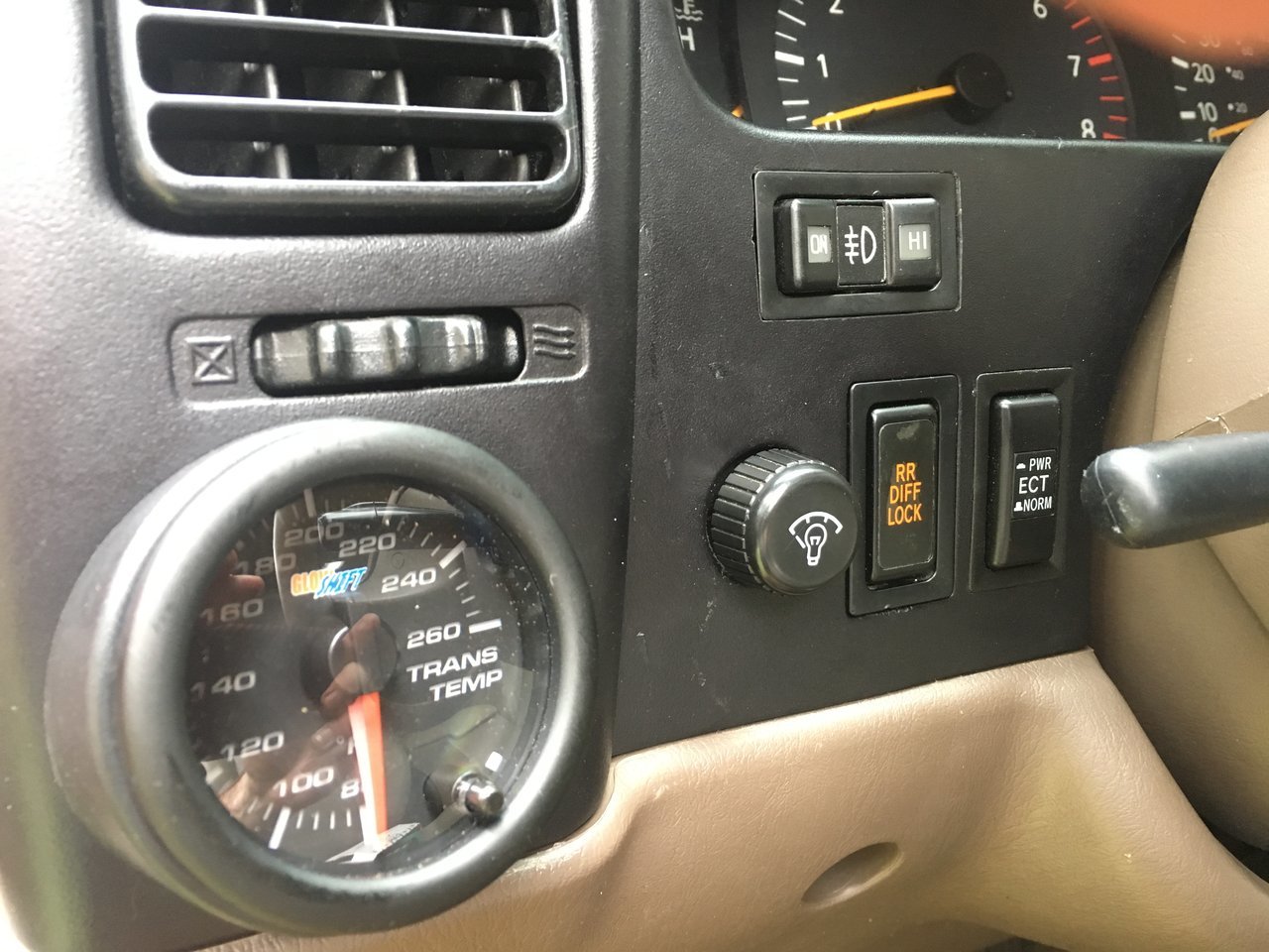

    Relocated my ECT switch next to the Diff lock switch. Also Installed a modified Land Cruiser Rear Heat Switch to use as an offload light switch. It will be trigger from the high beam but also be able to turn on whenever. To mount these in the dash I had to carefully cut the holes and then epoxy the mounts to the back that I got from the junkyard.

    What trans temp gauge is that, I'd like to put one in on my Land Cruiser, it doesn't have OBDII so I guess I need a separate gauge and sender unit and this one looks nice.

    It's a glow shift https://smile.amazon.com/gp/product/B007IK2CHO/ref=oh_aui_detailpage_o02_s00?ie=UTF8&psc=1
    but I would honestly recommend getting something else. The issues I have with this gauge is that you cannot connect it to the dimmer circuit, you can only attach a wire to the headlight circuit to dim the backlight 30%. While this works fine, it doesn't match the rest of the dash. There is no way around it since the backlighting is integrated into the circuitry and everything shares the same ground. Also, you cannot turn off the backlight, it is always on.
    I suggest getting one from speedhut. They are a little more expensive, but you can pretty much build it exactly the way you want. I may end up swapping this one out for a speedhut gauge in the future.

    Nice job on those switches, look great.

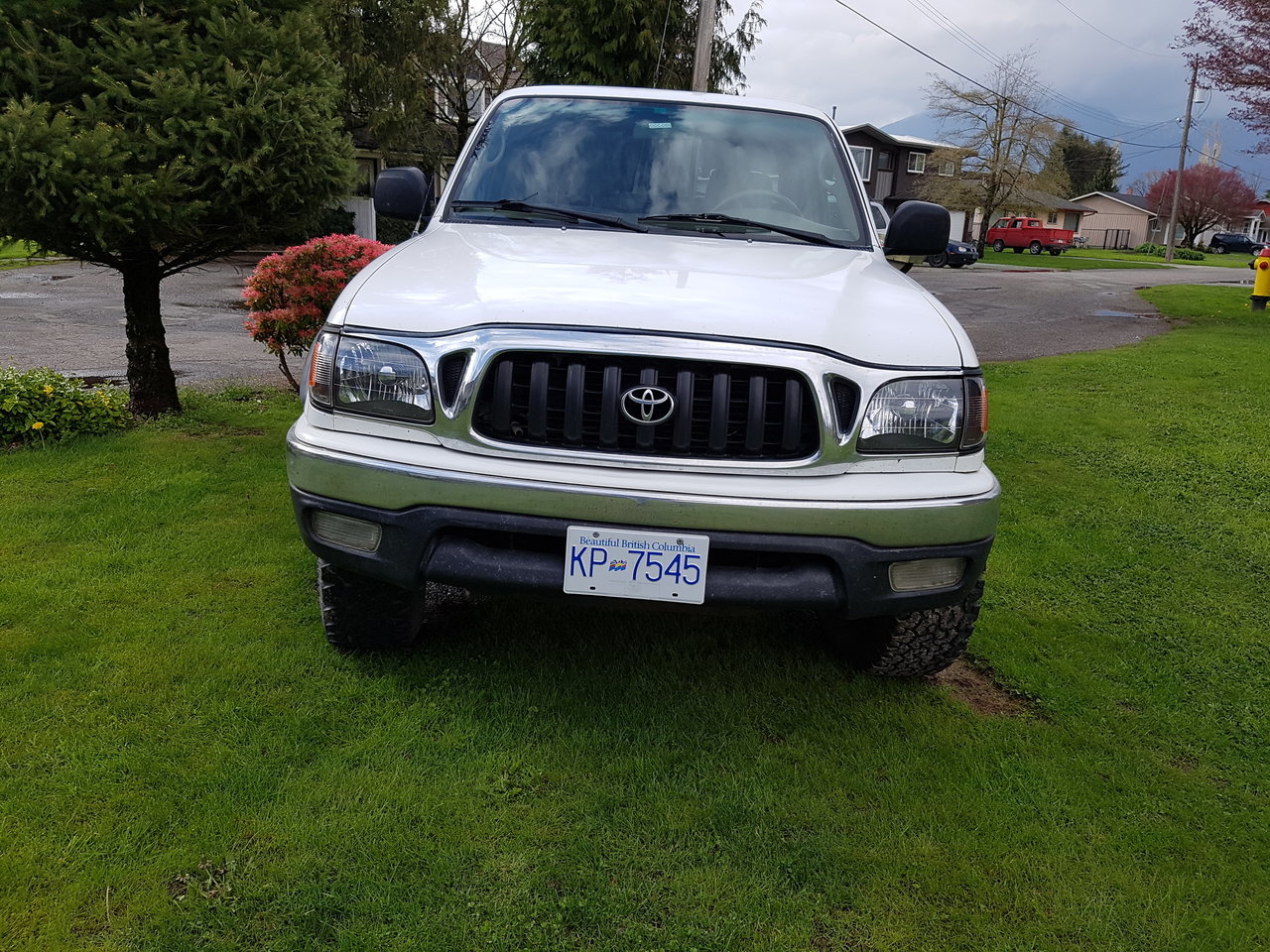

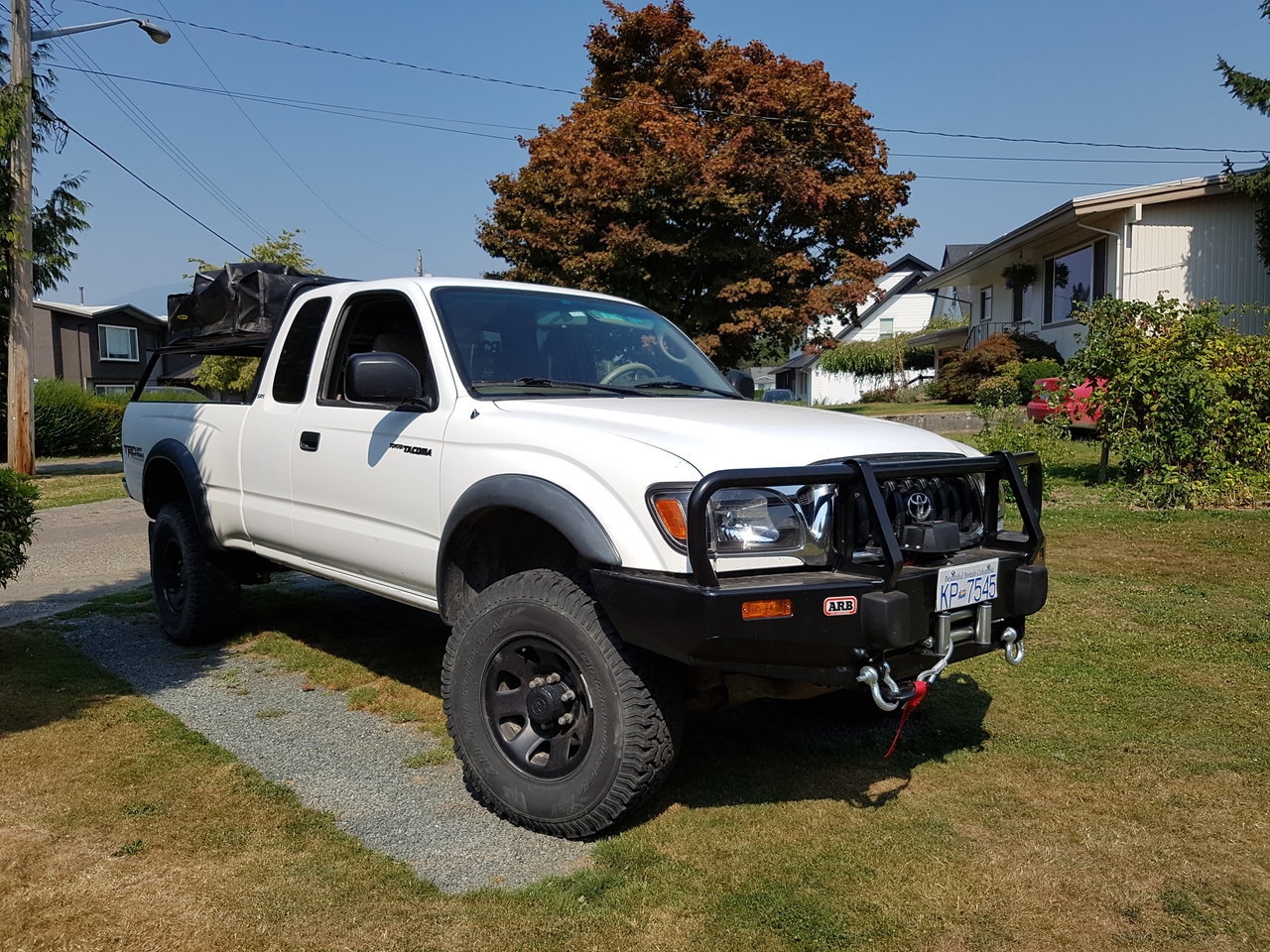

    Bought this truck in November and installed a 2.5" OME lift, Arb bumper, and RTT20170420_165514.jpg 150403700525755984136.jpg
