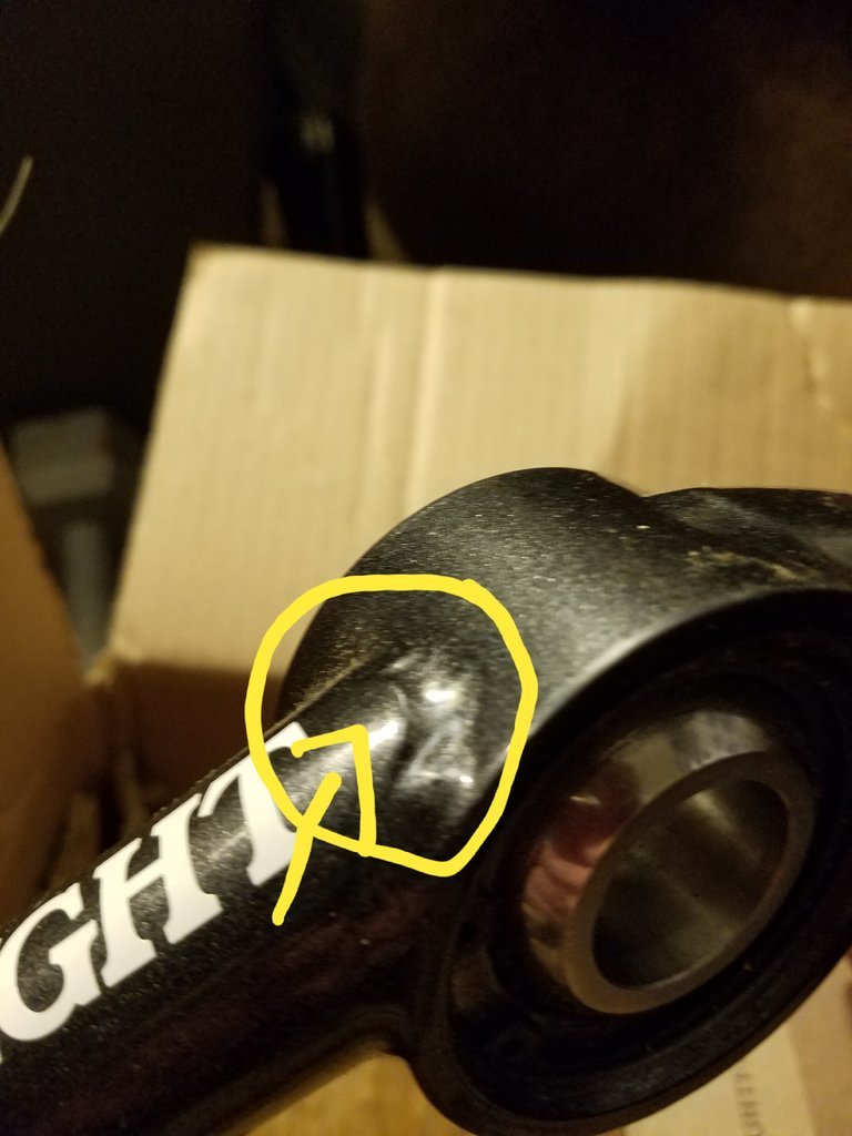

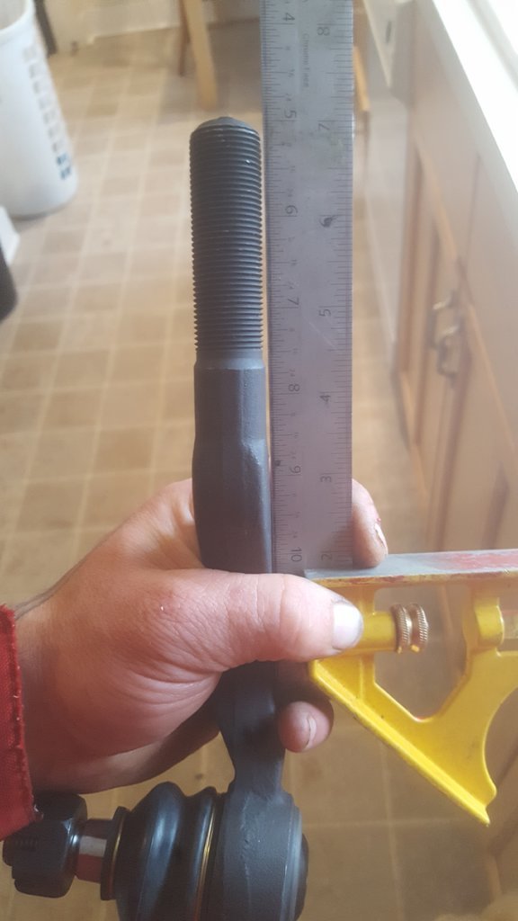

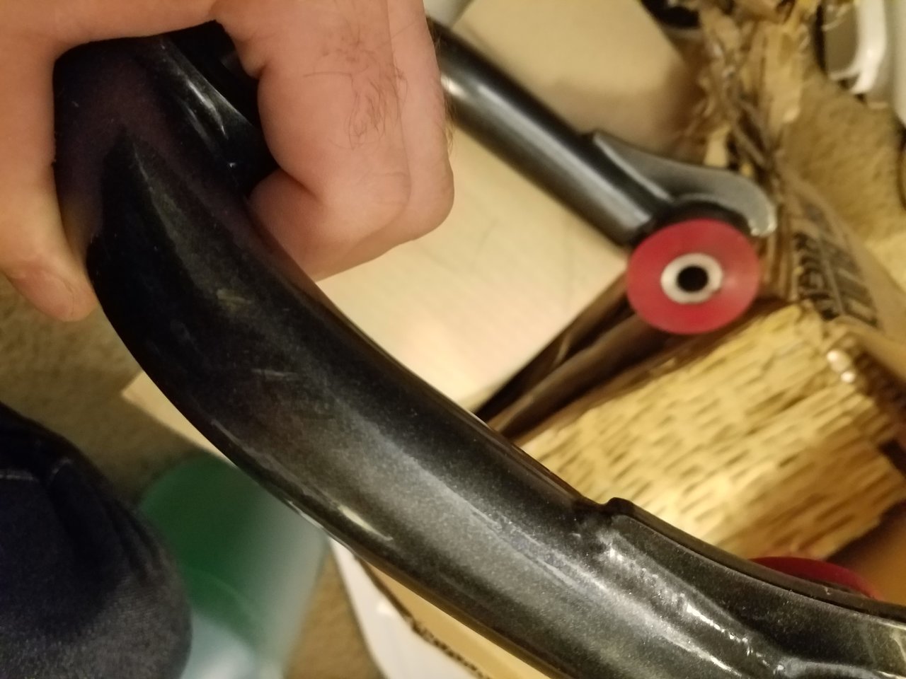

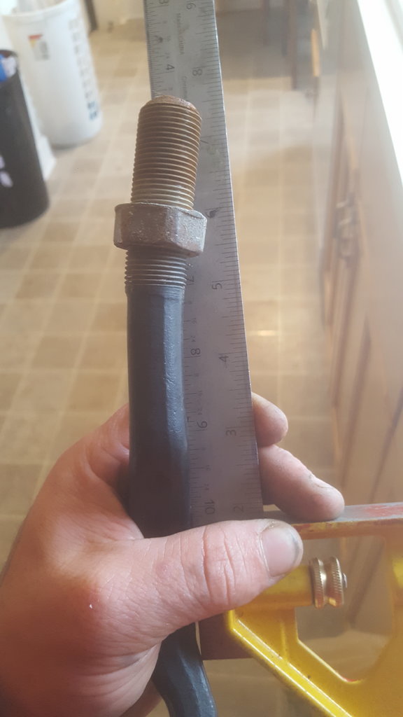

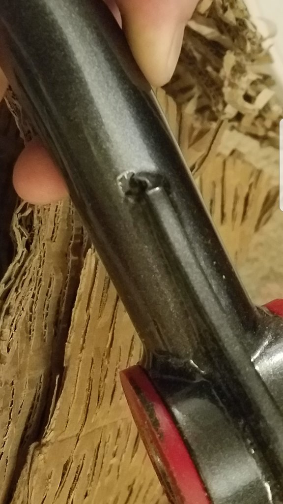

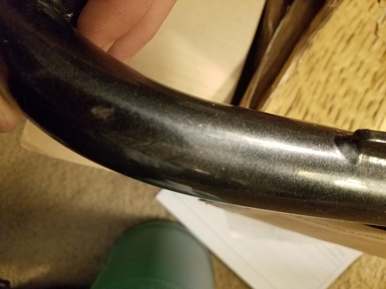

    The pics don't really show the knicks, maybe I'm just being overly ocd about it, I'm honestly more concerned about the powder coating.Screenshot_20170825-111607.jpg 20170824_223209.jpg 20170824_223218.jpg 20170830_223602.jpgand this right here feels like a gap where the lip of the tube sticks out almost, the other arm isn't like that.:notsure: Not trying to bash James or The truck shop/built right but what really got me obsessing over every detail was their response to my email about the powder coating was to just use touch up paint and blamed ups for it.

    It looks like the weld got a little hot in your last pic, I would imagine they're going pretty fast if these are production pieces and it's easy to get too hot when TIG welding quickly. Better too hot than too cold anyway.
    As for the PC, I have yet to see a high quality powder coating job from one of these small scale off-road fabrication shops. It's time intensive to properly prep small pieces like UCAs, they would probably need to charge a lot more and run them in larger batches.

    Looks like a bit of undercut from going hot on the weld. Pretty typical should still be strong, the rest of the PC area wasn't going to stay clean anyway unless you planned on using the truck as a lawn ornament.

    Doesnt look to bad, I wouldnt call that undercut cause it doesnt dig into the tubing. More or less just a little error on the cope fitiment. They look good to run, and the powder coat is going to get dirty and chipped off road anyways right.
    My black and white thinking, if I dont care for a certain finish product, I just build it my self. Then you have to consider cost of time, materials, tools, and knowledge. To each there own on that though.
    Im sure the truck will look and perform awesome.

    Cool thanks for the reassurance, these are my first big purchase for my suspension and I just got carried away looking for issues that aren't actually issues at all. It definitely won't be a lawn ornament!
