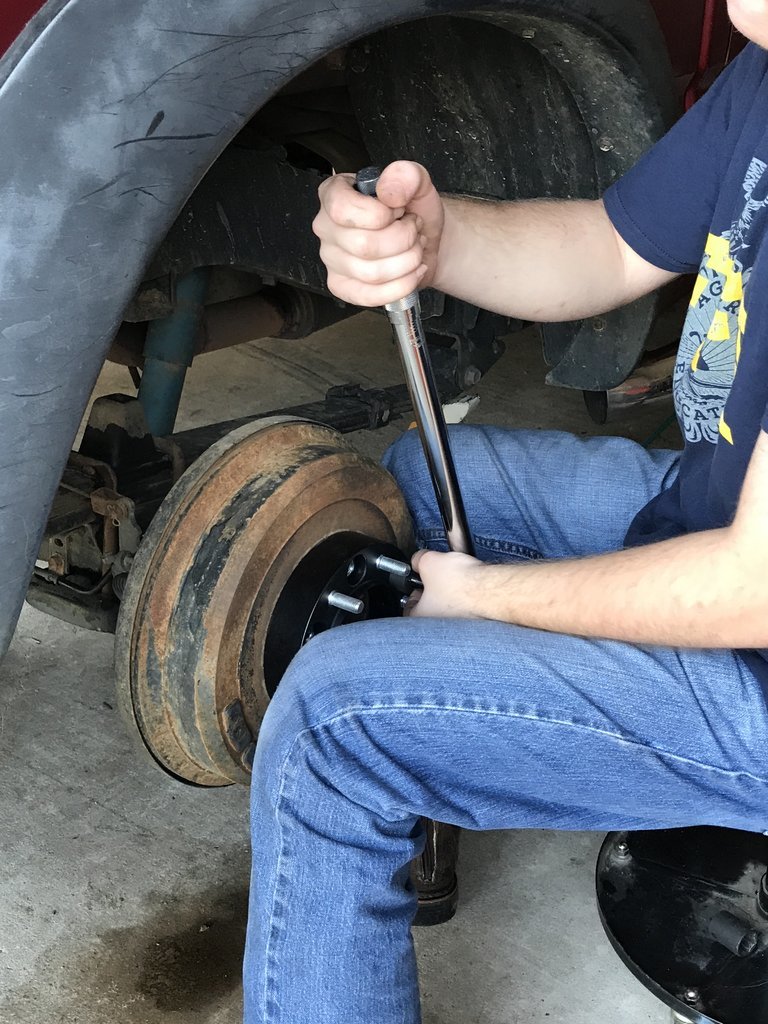

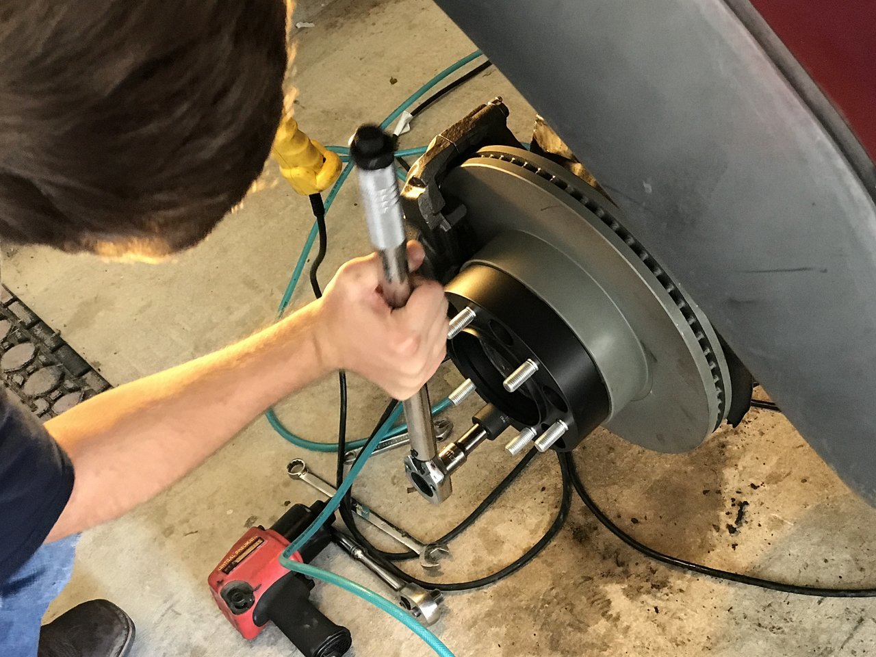

    Replaced the front rotors, calipers, pads, and brake lines. This was well worth the time and money, it will stop on a dime and give you 9 cents change. We also added 1.5" wheel spacers- red thread locker, 83 ft-lbs of torque, drove 100 miles, and re-torqued the lugs.

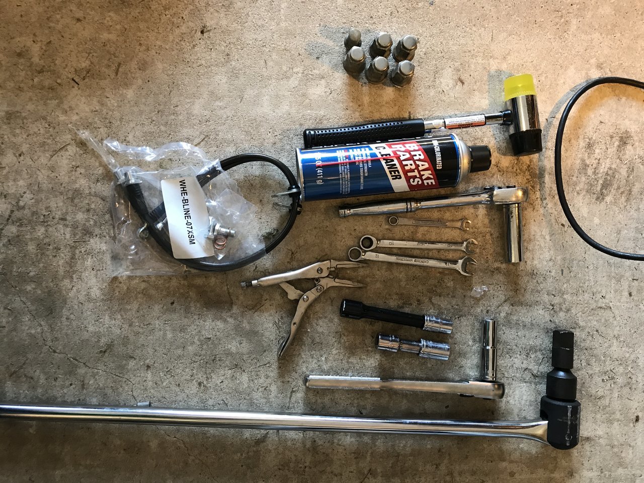

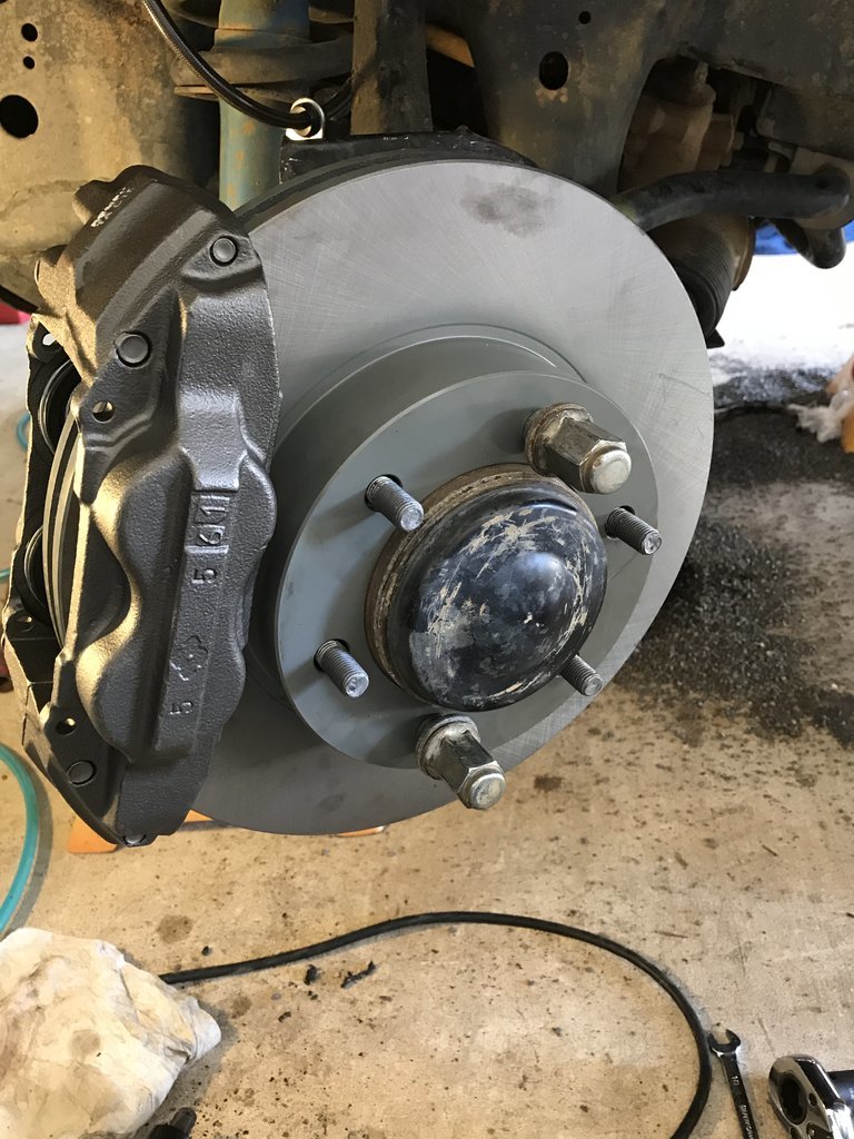

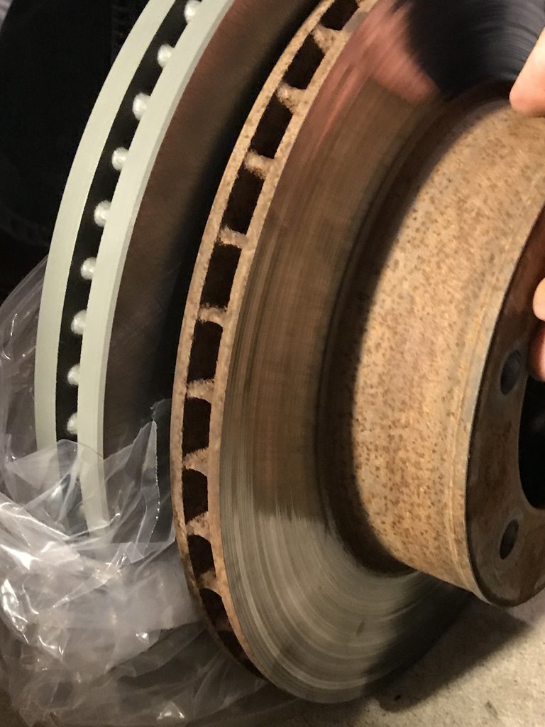

    I'll add a few photos...the pictures removing wheel, then the stock '02 Taco rotor/caliper/pads, next the difference in the Taco vs '04 Tundra rotor(13WL), then new Tundra rotor installed, next new caliper, last pic all installed. The two 17mm caliper bolts are at 90 ft-lbs, banjo bolt 11 ft-lbs(be careful with the banjo, it will and did break off. so I had to back off on the torque), spacer & lug nuts 83 ft-lbs. We installed "Wheeler Tacoma brake lines" they'll bolt straight up (no drilling required), bleed the lines(10mm & 8mm) (this is also a good time to flush)- start at the rear passenger, then rear drivers, next front passenger, then last front drivers. Keep the DOT3 brake fluid reservoir full. Lay a paper towel under the bleeder or connect a hose on the bleeder, also buy some bleeder dust caps to keep mud/dirt/grim/salt out of the orifice. You'll also need to bend the dust cover back away from the rotor & calipers.
    Tools needed: socket & wrench (mm)- 8, 10, 14, 17, 19, 21; paper towels, alligator nose vise grips to clamp off the brake line, rubber hammer, sand paper or wire brush, brake cleaner, oil dry, breaker bar(caliper bolts are @ 90ft-lbs and can be tough to break loose), red thread locker, 10 mm brake line wrench(important-these little brake line fittings are also very easy to round off the shoulders). This project is well worth the time, money and upgrade time. This '02 Tacoma will flat out stop in a hurry. We bought '04 Tacoma 17" rims from Craigslist and are now saving for mud tires.
