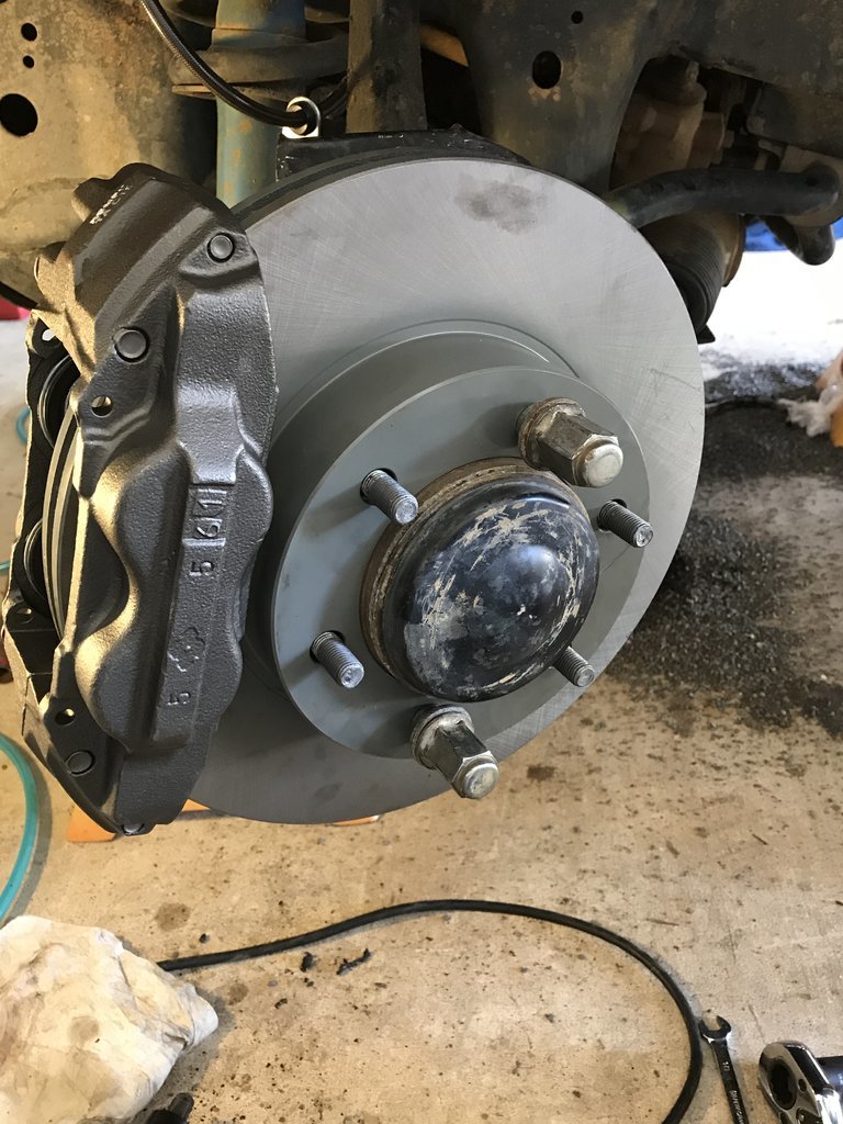

    I bought the rotors, calipers and pads from O'reilly's; my brake lines came from Wheelers off-road('02 Tacoma lines). I told(O'reilly's) them to give me parts for a 2004 Toyota Tundra 4.7liter, SR5, 4wd, dbl. They have a lifetime warranty.
    I looked at the kit on Amazon, it seemed ok, but when I googled company names it all got real blurry. I backed out and emptied my amazon cart. That was just how it was for me, I think the cooling vanes were 1/2 of the OEM to. Just give them a good thorough look over before buying, the darn item & seller changed up several times. NAPA, also has a good set you can look at. Goodluck. Either way you go, it will be well worth it.

    Rotors #96931RGS $57.99ea X 2= $115.98
    Caliper #19-2712 $77.99
    Caliper #19-2713 $77.99
    Ceramic pads #SC976 $39.99
    The Amazon parts might be ok, just check them out from every angle.

    I posted this on page 6407...here's how the O'reilly rotors & calipers look installed

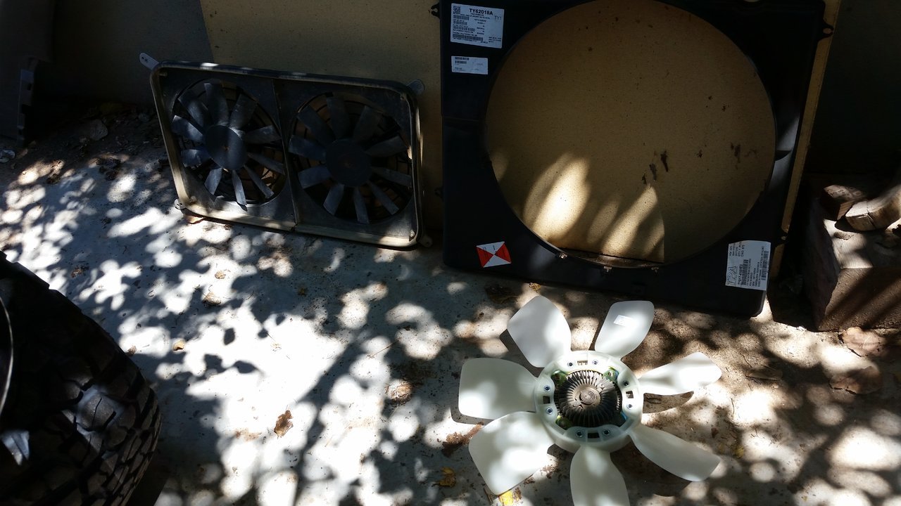

    Changed out dual electric fan and went back to crank fan on 96 4x4 LT taco. E-fan couldn't take the heat...fine for city driving and light offroad, but sand wash and hill climbs would send the temps over the hill.
    Going back to stock was a good decision. Temps hold solid, actually run cooler on the trail than freeway, says the Ultraguage.

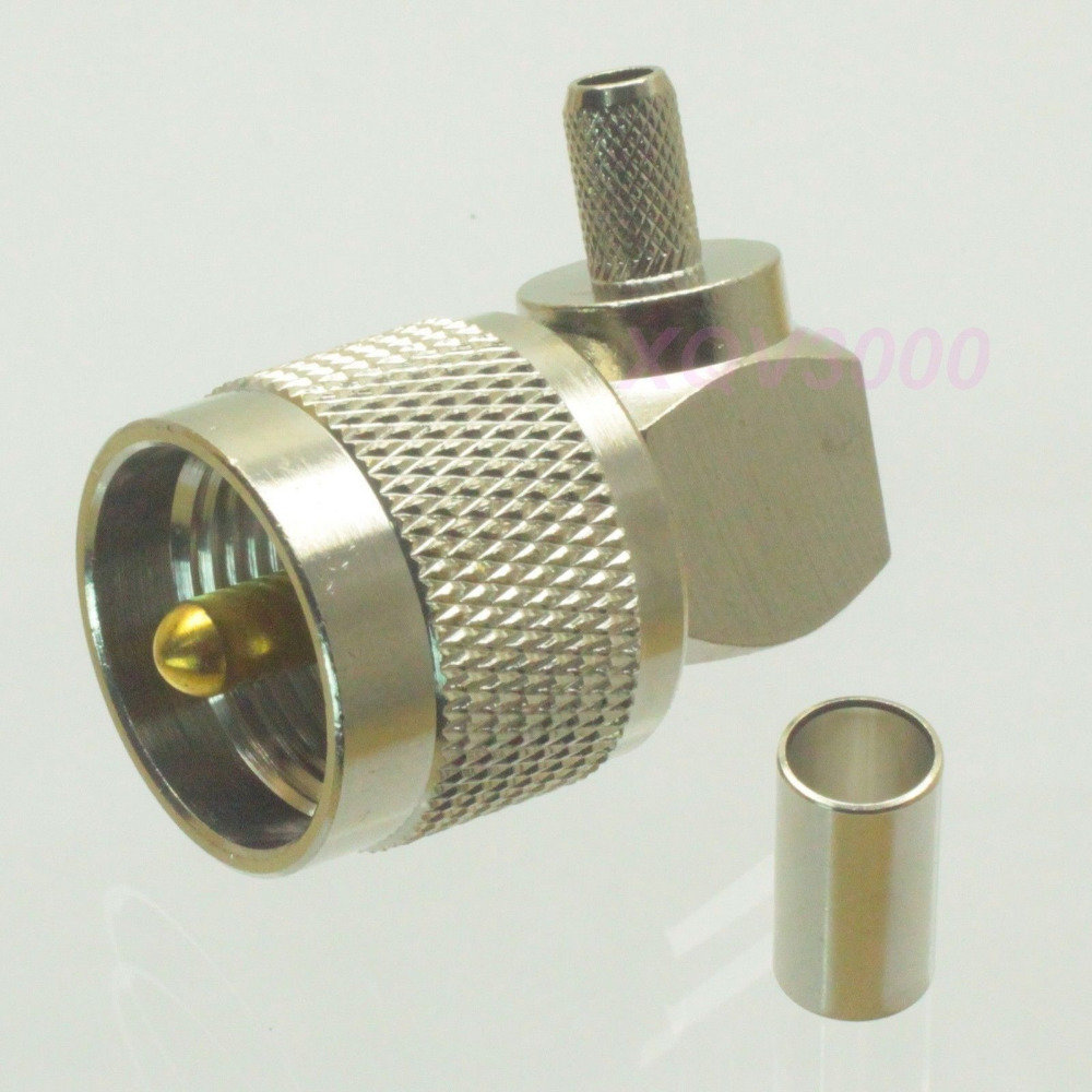

    I dremeled out the plastic in the back of the ashtray and removed the ashtray bracket to get it that far. Then i made a custom cable Using a right angle crimp on pl259 connector such as this image without having the need to heat up the air duct behind the ash tray. You can probably find a premade cable somewhere on ebay. As for mounting it in the ashtray i used a few zip ties and 3M double sided sticky tape, Its not ideal but it survived the summer heat.
