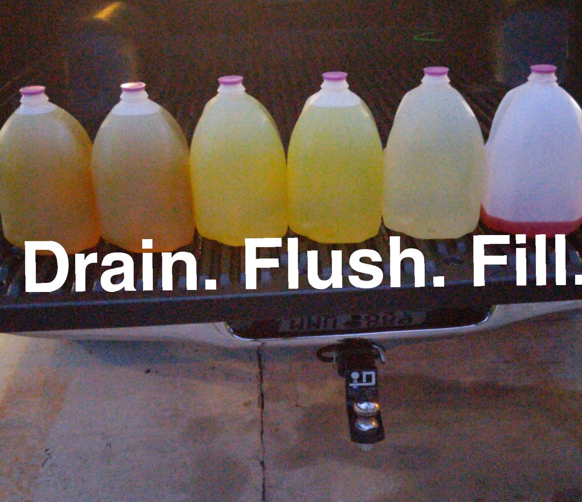

    Removed old green coolant(it wasn't me) and added Toyota long life. Drained transmission fluid and added Redline MT90.

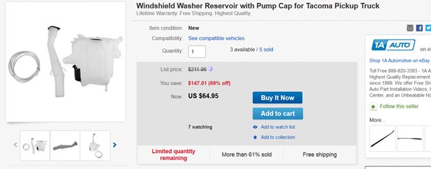

    I need to do this too( i need to relocate it). With the new bumper installed my stock one is peeping out just waiting to be punctured.

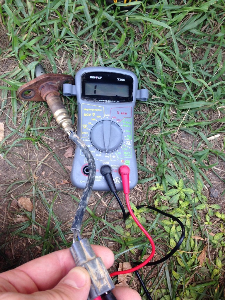

    Unplug the sensor and check it with an ohm meter. you'll know right away. It seems like the ohm were 13 or so.

    A picture or two O2 sensor & new cat ...I put my old heat shield on the new cat. You can do this

    I think ill go with the Kia sportage reservoir bottle or try the ebay listing posted here. Someone here did a write up showing a 93-94 Kia reservoir fits where the empty void is near the airbox.
