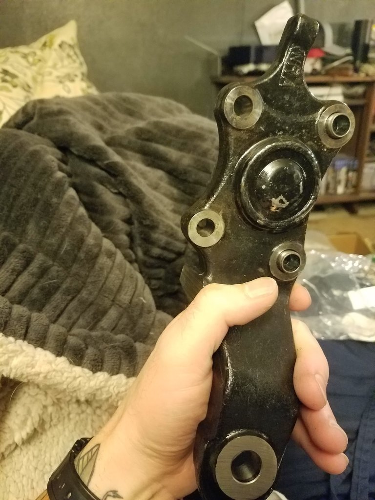

    Not sure what you mean by machined out? Hopefully this is oem and in decent shape.

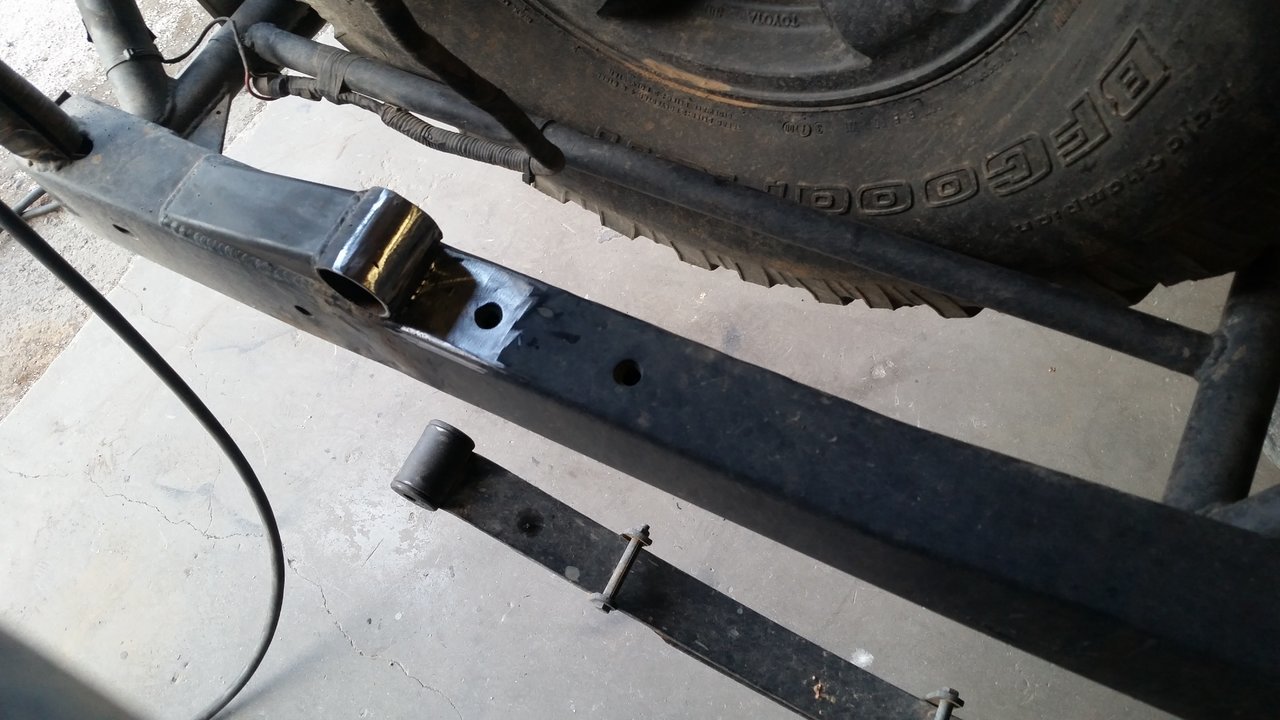

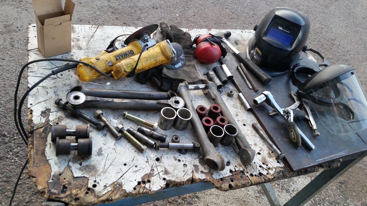

    Today, after work, I moved the shackle pivot closer to the magic number on my 96 LT 4x4. It has f55 pack with 3 leafs out to soften it up. Just bed cage and 2 spares. It basically worked out that if I just put a new tube in front of the existing tube for shackle pivots, that the new centerline would be in the magic spot.
    So I cut some metal, ground off the paint and welded the new mounts on. Nothing crazy, just some Mig welds. I greased and re-assembled it. Rear now sits lower than before and feels softer on the street, havnt been to dirt yet. Probably throw a few leafs back in or go to f67 pack for ride height. I'll play with the shocks after that.
    Couple pics. Table with goodies and the preped frame area for new mount. No finished pic.

    Well I'm glad I made that change, it's a much nicer ride now. A little too low in rear tho, very raked. You wouldn't think moving the pivot a little would make a noticeable difference. Rear was harsh, beat your lower back to death. Now it's much better, I can go fast enough now the front needs work, ha!

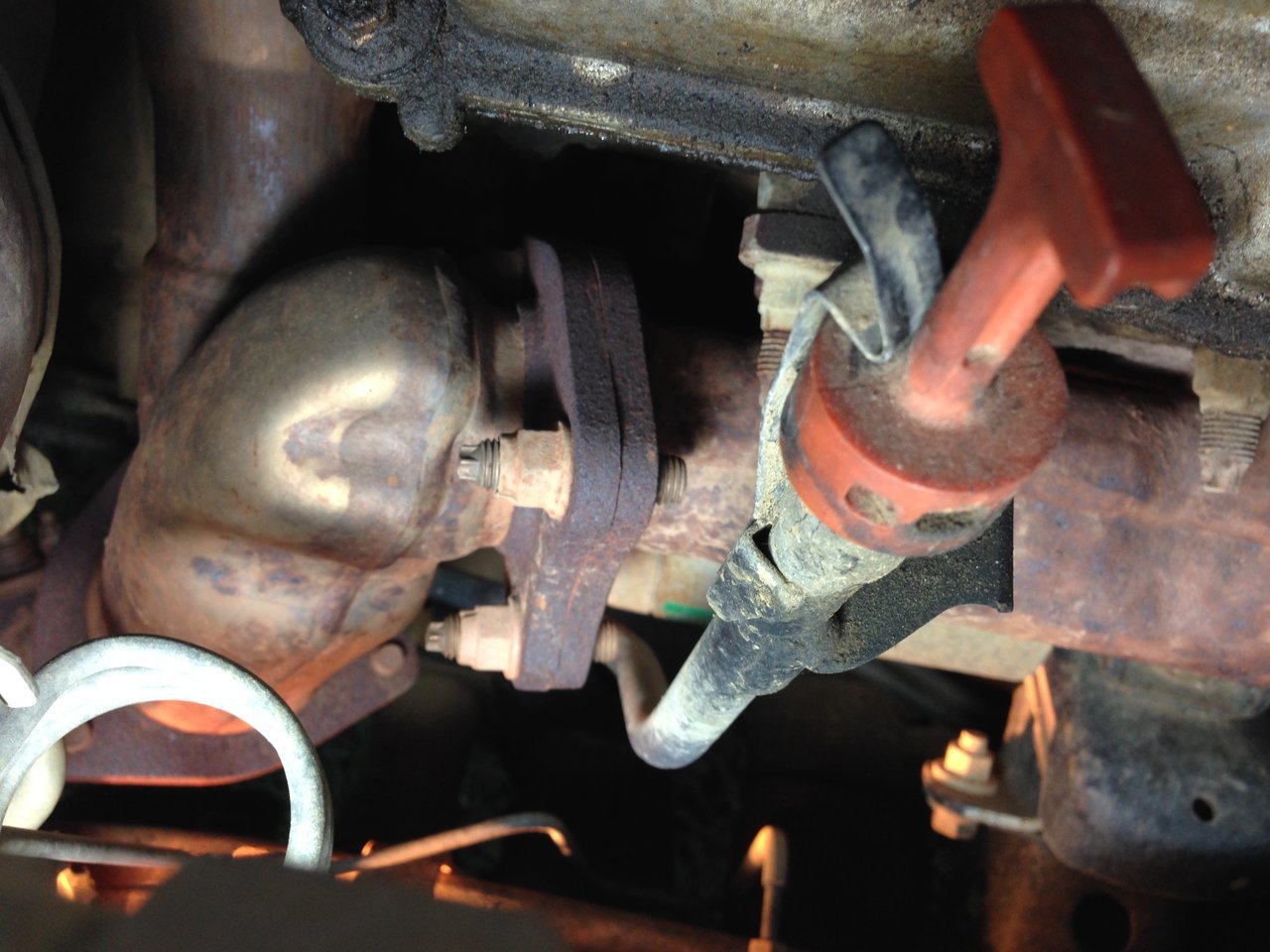

    Replaced both valve cover gaskets. Ran it a while, then found more oil dripping onto the manifold. Took off the passenger side again, and found a hair-line crack by the last bolt hole. Bought a new valve cover gasket and everything is slick now!
    I have one pic(not the best, but you can see where the oil was coming from)

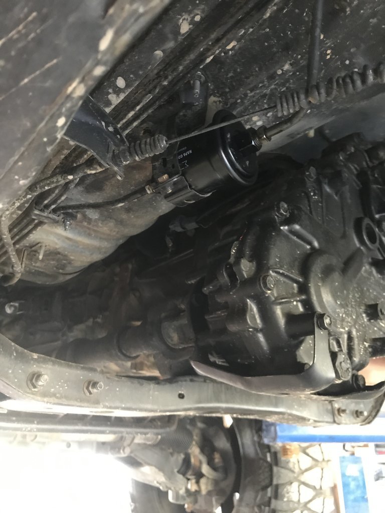

    Hahah, OMG man right.
    Did you see the fuel filter I pulled?
    LofL
