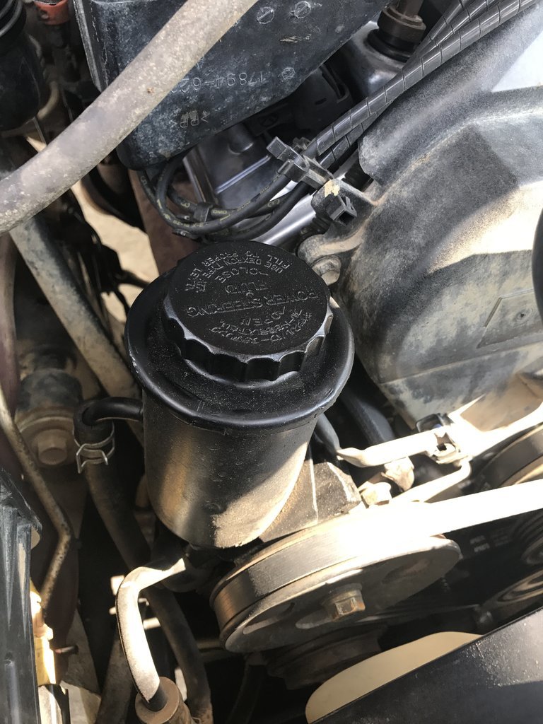

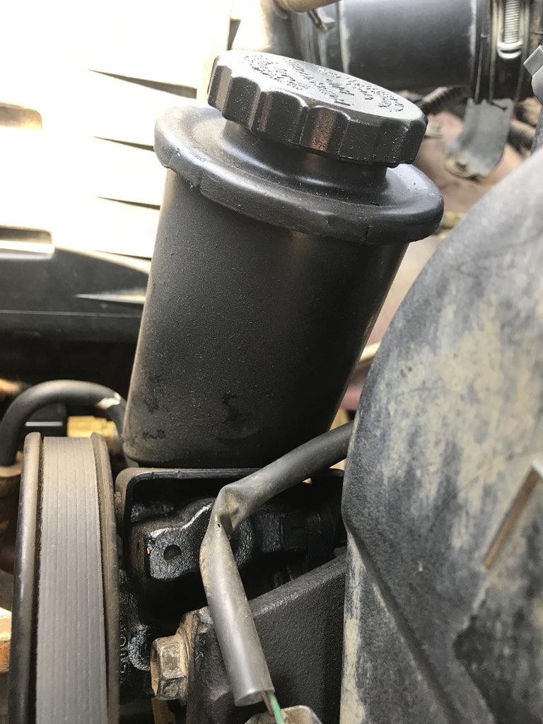

    Mine stopped building up after we flushed it, and cleaned the strainer. The fluid level was building up to high because my strainer was gunked up. Make sure to check the seal on the cap, fluid can slosh out if the seal is bad.

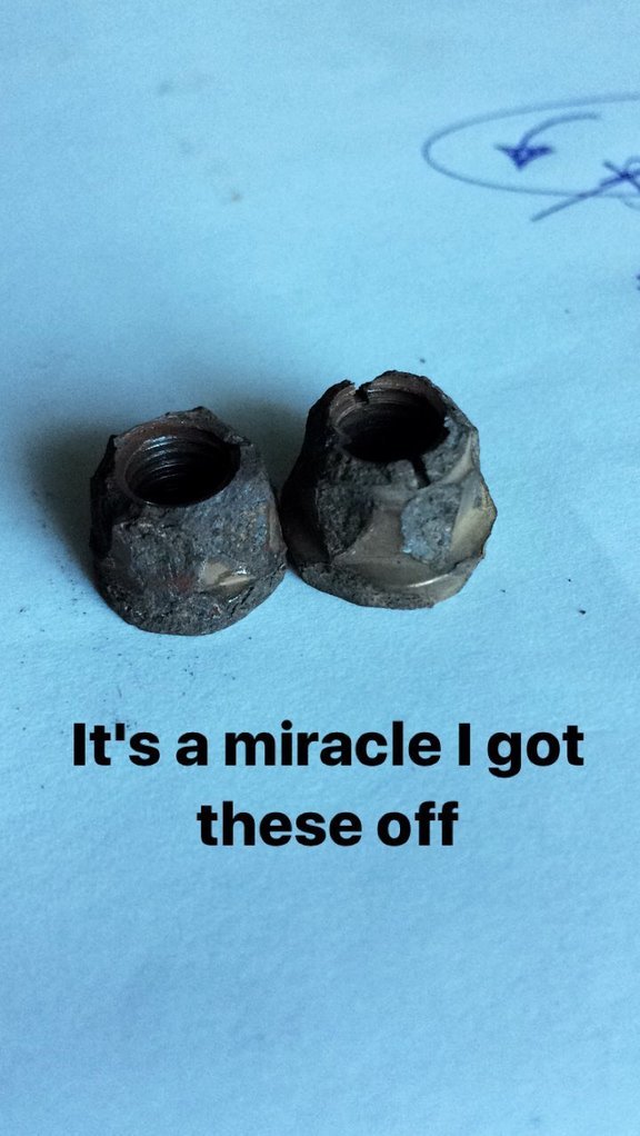

    Here's what the nuts on the o2 sensor looked like
    Thank god for this thing
    Can I just replace with grade 8 nuts?

    would u believe if i said my studs looked 50x worse? i picked them off with my fingernail.

    Clean the threads real good. They'll (grade 8) hold up. Just don't put any generic nuts on there. The high heat will seize them. Also, keep in mind the common cause for an upstream to fail is a stopped up cat.
    It seems like the threads are 8mm x 1.25, and the OEM is a locking nut. You can match it up at the parts store.

    yeah sure. Just use anti seize on them.

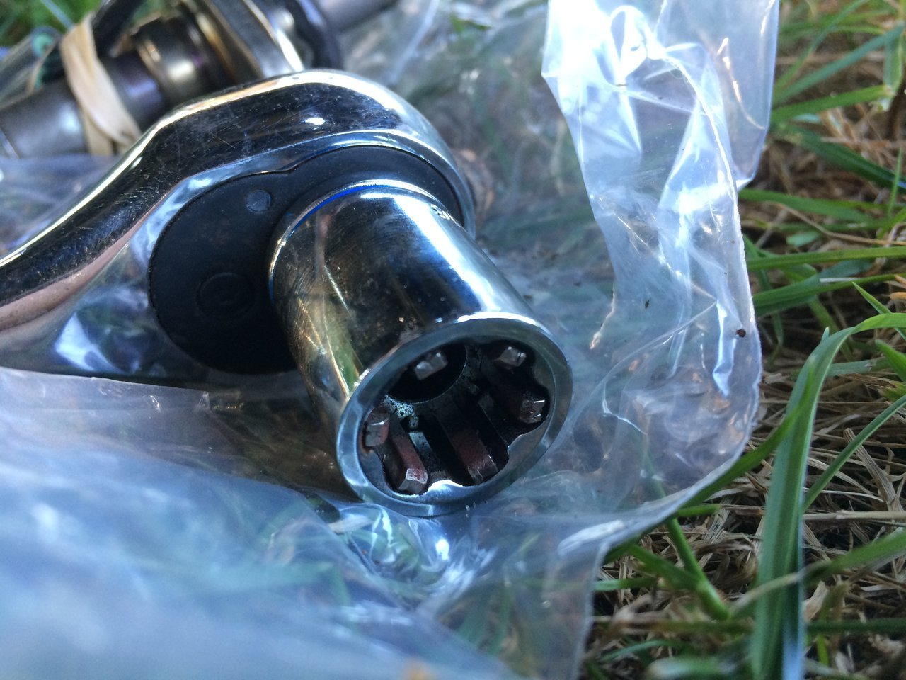

    What kind of socket is that? Looks cool.

    I think they're called steel grip sockets, kobalt. I thought it was kind of a gimmick honestly but it actually worked so can't complain

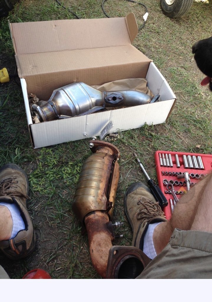

    I bought a new one from Autozone, look on their website. You can take it off and clean it. I just went new. They sell direct fit (it cost a little more, but it bolts on), or a universal that you can cut old one off & weld new cat on. If you take your cat off, pick-up two donut gaskets and new nuts & bolts. My old bolts were in rough shape.
    I spent so much on that darn O2 sensor I didn't want the cat to overheat it again.
    If weldings not your thing, some local welder can do it for 1/2 hour labor(I'd take my on part and just pay them to weld).
    Good luck!
    Here's a pic of my catalytic converter...

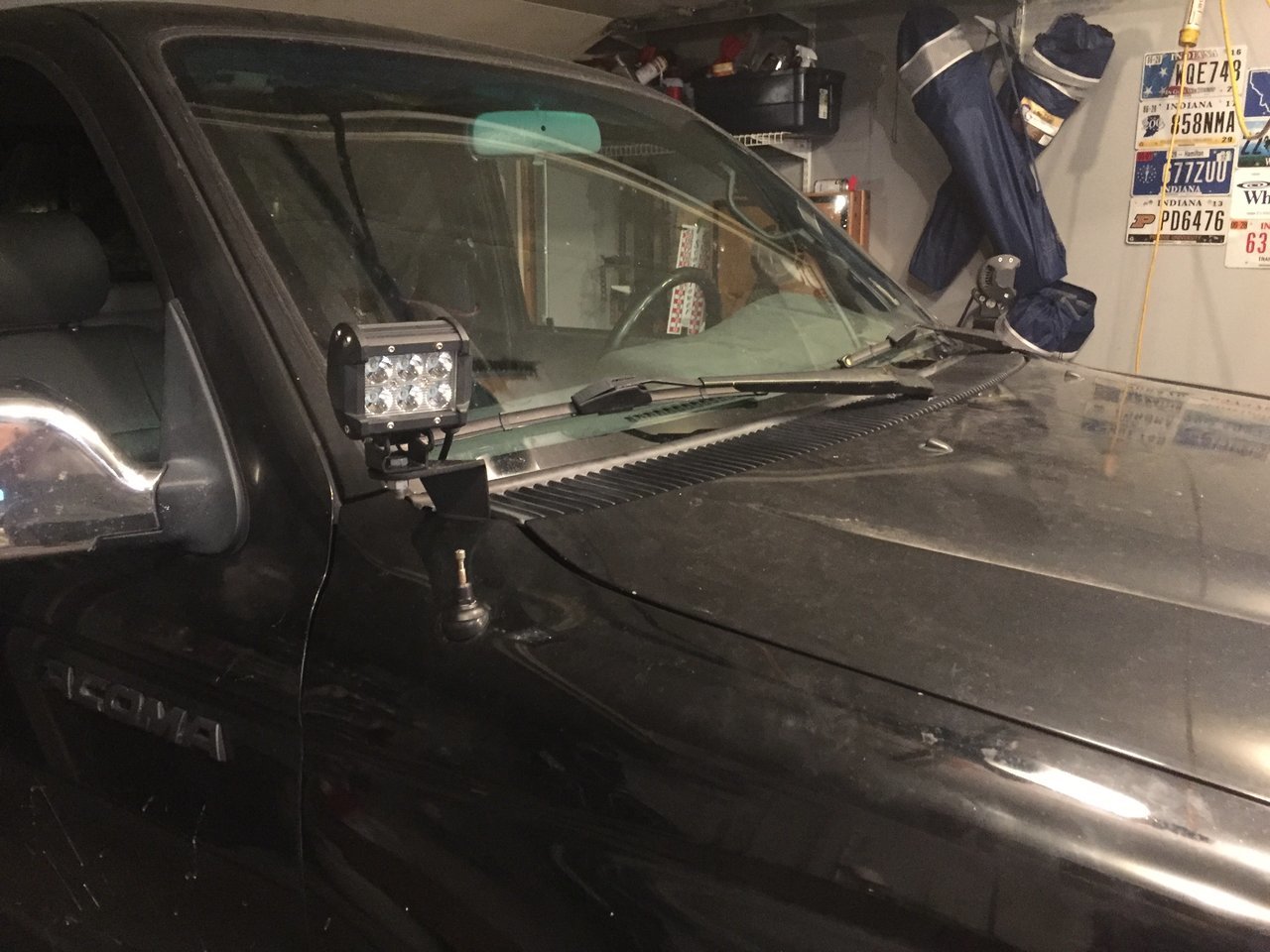

    Finally got my CBI ditch light brackets mounted up and pods wired up. Not too bad.
