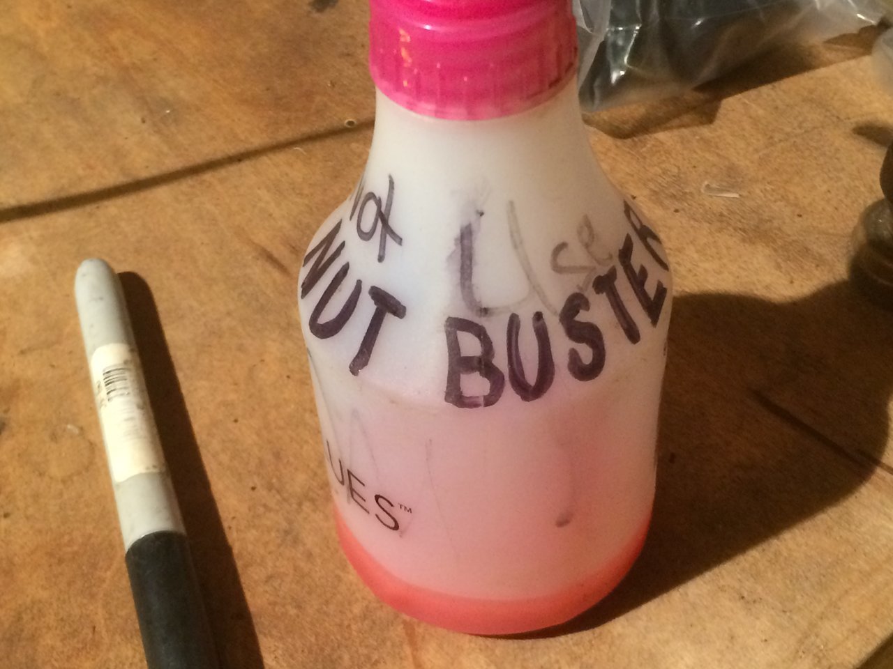

    I made the solution, hopefully it lives up to its name

    50/50 acetone automatic transmission fluid.

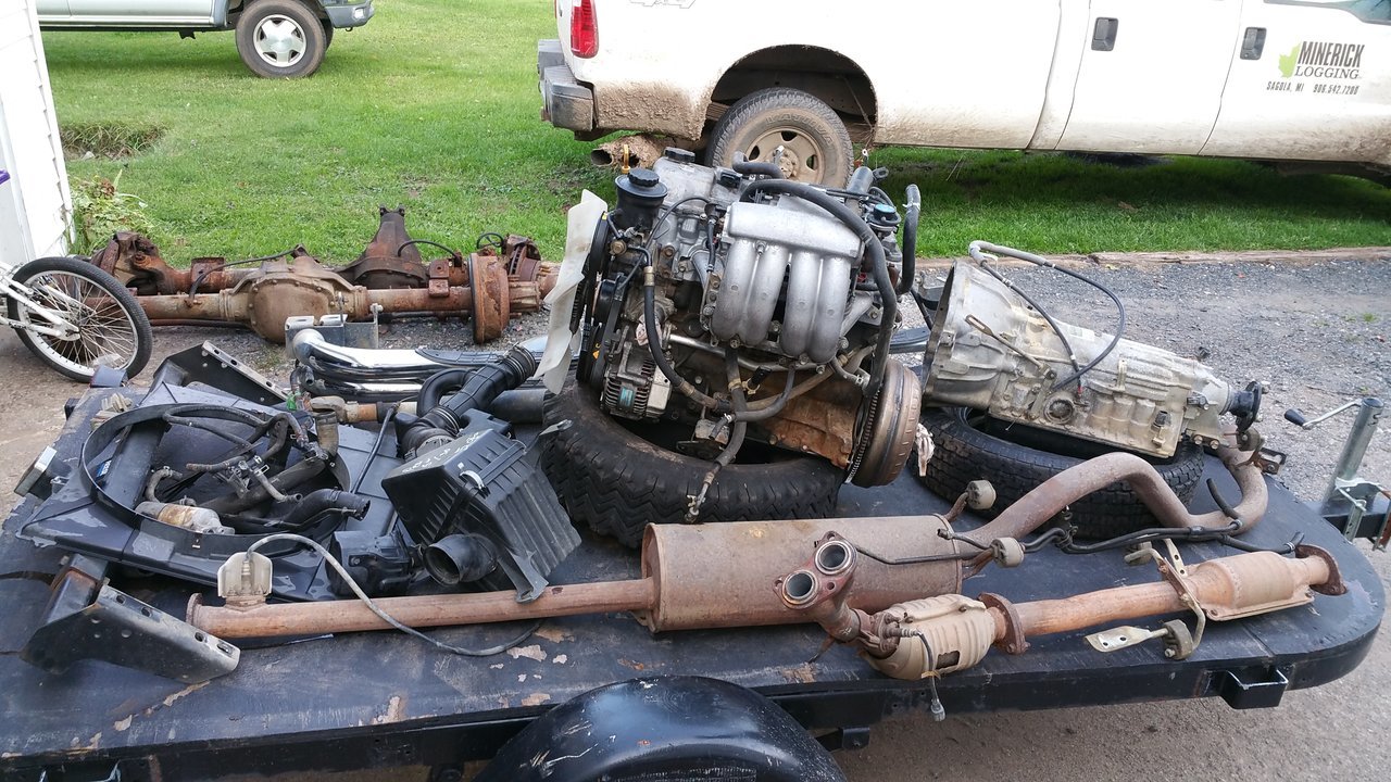

    Pulled my motor and trans in prep for sas and v-8 swap. parts for sale are in the marketplace.20170910_183442.jpg

    Not yet. It's a really slow build. still acquiring parts and doing more research. found the truck I wanted after I had to sell my last taco and then things just kept falling into place parts wise. just work to much to be able to get it done. probably wont be done till next fall.

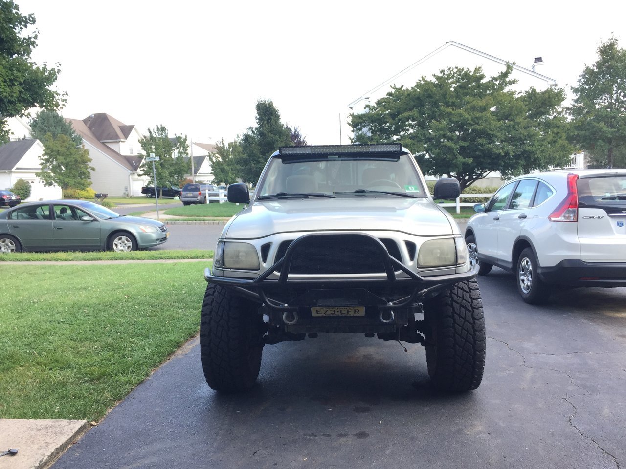

    Mounted my bro bar this weekend.
    Gotta figure out something for the hood glare though.

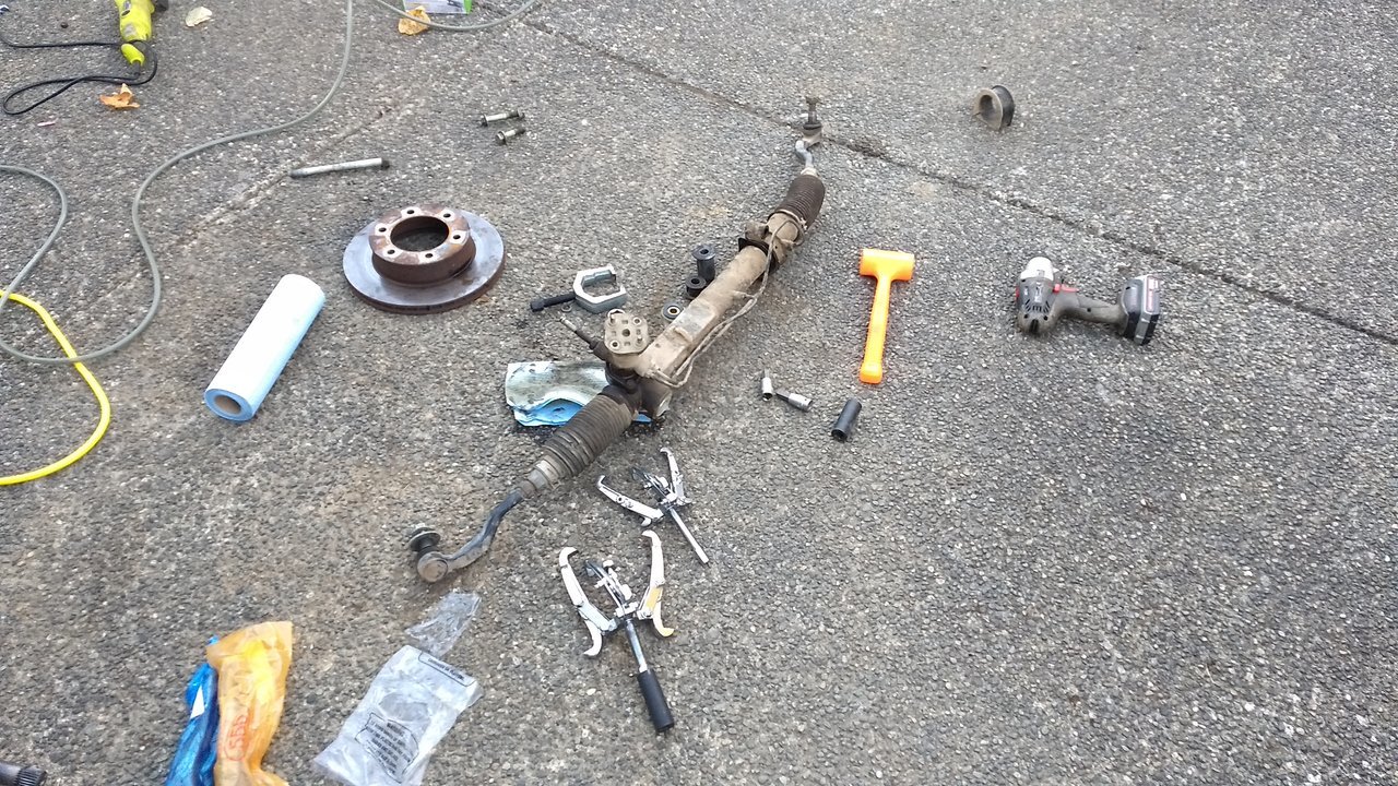

    Been at it hard today... Installing the green trucks steering rack tonight maybe putting the green trucks spindle on then maybe I'll put more of the engine wiring and components in. Gotta make it to "The Tour"
    Did the steering rack bushings too, man that's an easy job if they aren't in the truck.

    Those headlights are FOF! Can you see with them at night? Or do you just use your light bar instead? I took my light bar above the windshield off because of so much glare. I even Raptor lined my hood. What's your solution for the glare? Prop up the light bar more? I tried that, but the the heat sinks on the back of the light bar started to hit the roof.

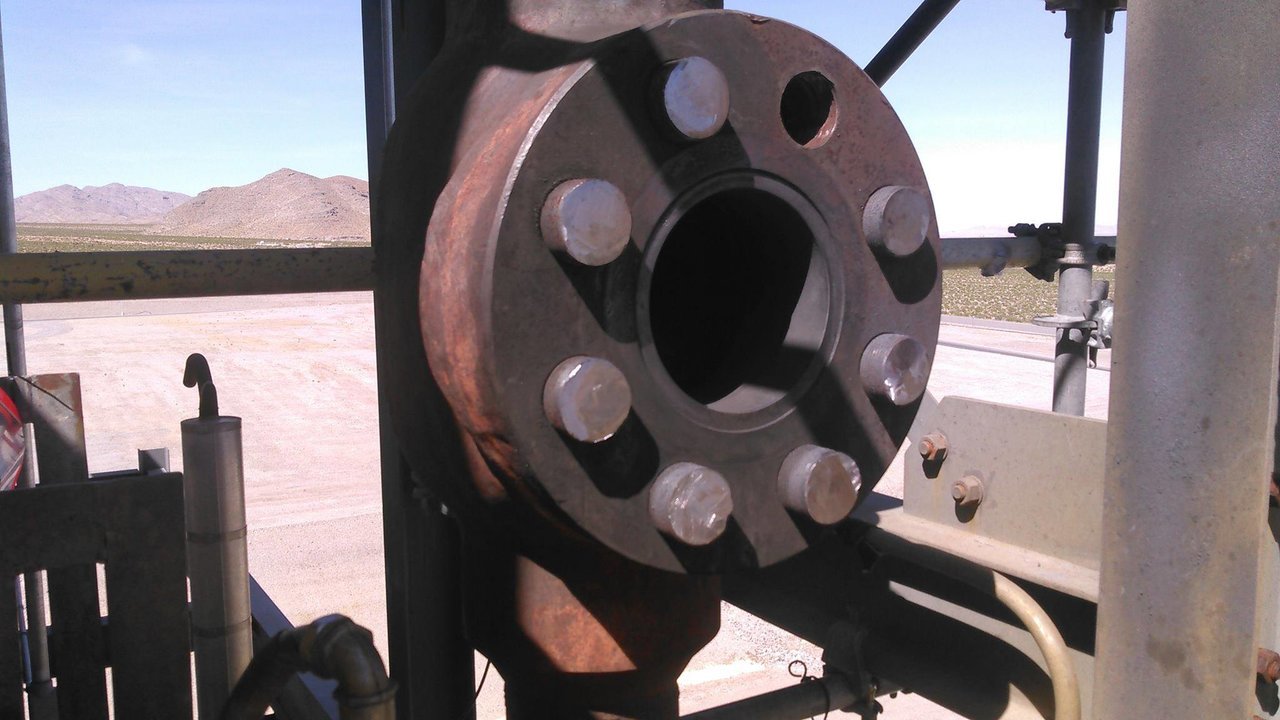

    If I can get these 2.250 bolts out are completely seized, you can do this.
