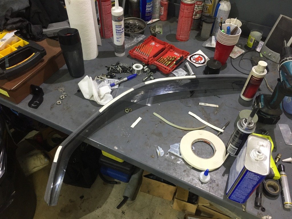

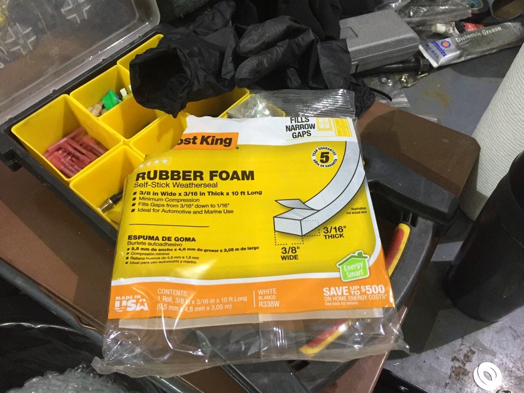

    Also I forgot I added these to my window deflectors today to hopefully get rid of the annoying whistle I get when the window is cracked.

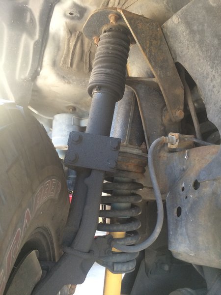

    That looks pretty darn close.
    At the top where the strut mounts is a rubberized bushing/mount thingie that keeps ripping out. Doesn't seem to matter what side either. Thinking about going back to a UCA setup or having a buddy make a mount using 3/8 steel plate with a uniball welded to it.
    POS is what it is.
    Edit: Do you know the mfg of the setup?

    whatever this thing is, it looks dangerous

    It is very dangerous, uses a VW MacPherson strut in place of your UCA and loads it laterally without a top brace like the VW had.

    That strut / UCA looks real whacky.

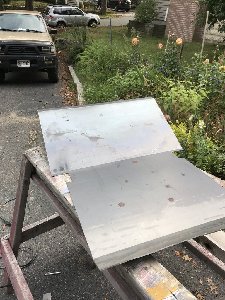

    Started cutting up a skid plate. It’s only 10 gauge, but it’s what my broke *** has laying around, so I’ll try it. Gonna brace it w some angle and hope for the best.
    If anything, it’ll be a nice practice piece and I’ll replace it next year when I buy 3/16” plate for a front and rear bumper build.

    Okay then, looks like I'll have some work to do while he's TDY. Got some stock UCA's with new UBJ's and bushings from @DukesTaco yesterday, so that's a start. Thks Duke!
    It's really too bad that this setup was even put on this truck. When he bought it last year the guy had just replaced the steering rack, front axles/CV's, carrier bearing, all fluids, headlights, and a host of other things.
    Has 2.5 Icons, Bilstein's in the rear, Tundra brakes, Dakars (with 3" blocks :facepalm:), bumpers, skids, compressor setup, etc already done, so that's a plus.
    So, what am I looking at, work wise, to rip out the drop bracket and associated nonsense?

    Oh god trail master...

    Well drop brackets unfortunately cut out part of your frame in the process so you can lower the differential. So to get rid of this demon spawn of poorly engineered dumb fuckery you'll need to source or make a new crossmember where the original goes. Otherwise you have nothing to add rigidity or pose as a differential mount.

    Were there actual cuts to the frame or was the original crossmember just removed?

    I'd suggest you post a pic, but the front of the truck has no bolt in frame crossmember so it was likely cut, but they might have left you some to work with if you're lucky.
