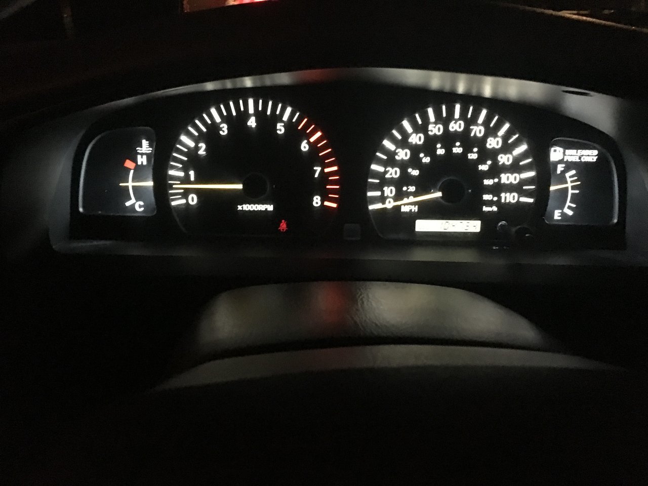

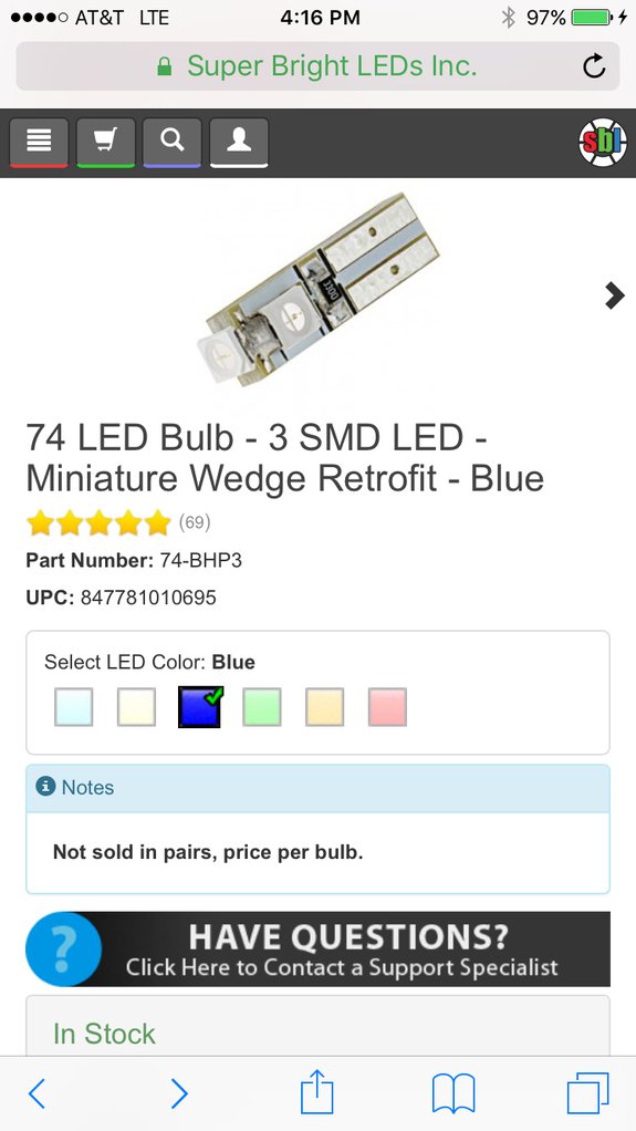

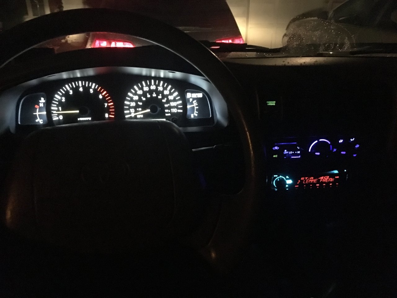

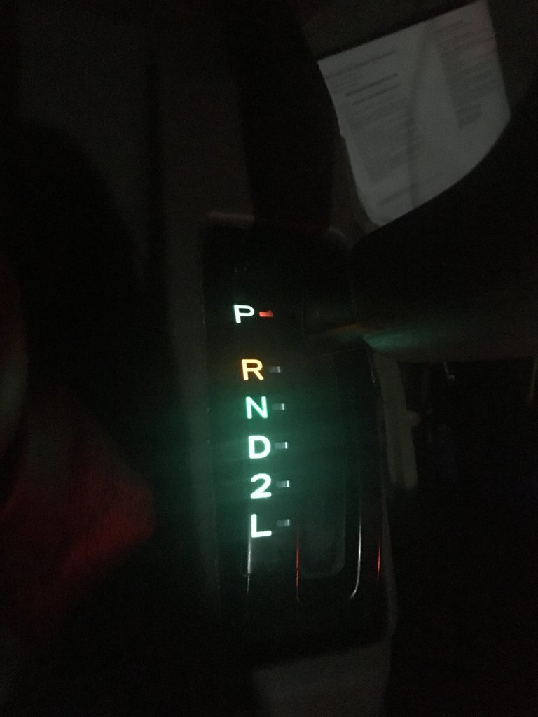

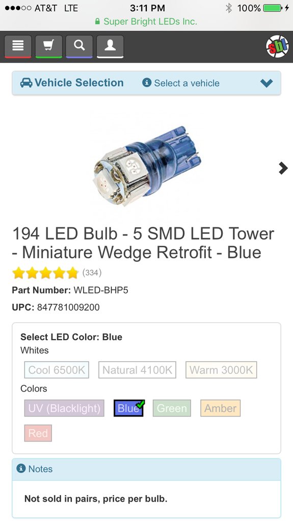

    My 04 took 4 - 194's, HVAC took these and glove box, gear shifter, and ashtray all took #74's.

    Hmmm I wonder if the pre-01 dashes used the same bulbs. I want to change the lighted ring around the ignition too. Anyone know if they are supposed to stay lit the whole time you drive or if they shut off after the key is turned (mine does this).

    Exactly what lights did you use? I'm afraid if I use too bright LED's there will be some light bleed

    my 95.5 had the little 74 style bulb in key ring, ac controls, and shift indicator. key ring light stays on for a set period of time i believe (nvr payed any attention to tbh)

    Does the dash dimmer switch work when you put new led's in?

    leds work with the dimmer.

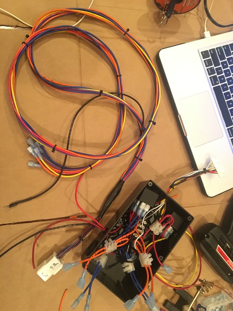

    Super easy to wire up mirrors only. You can get everything you need from a 4Runner. Just a matter of 8 wires, 6 for signal 2 for ground and power. Power locks, on the other hand, is a whole other pain in the ass.
    Making another retrofit system for a buddy right now. I've narrowed it down to a science, I already drew up all the schematics and did the testing so now it's a breeze. My personal system took me a good 6 months to figure out with a LOT of help. I got this system finished in a little under a week.

    So what would be the correct size replacement updated bulb? Got most of the interior taken apart - I guess now would be a good time to do that too.

    I bought a illuminated key ring out of a 4Runner to install in my Tacoma since it didn't come with one and a #74 worked. Not sure about your truck though

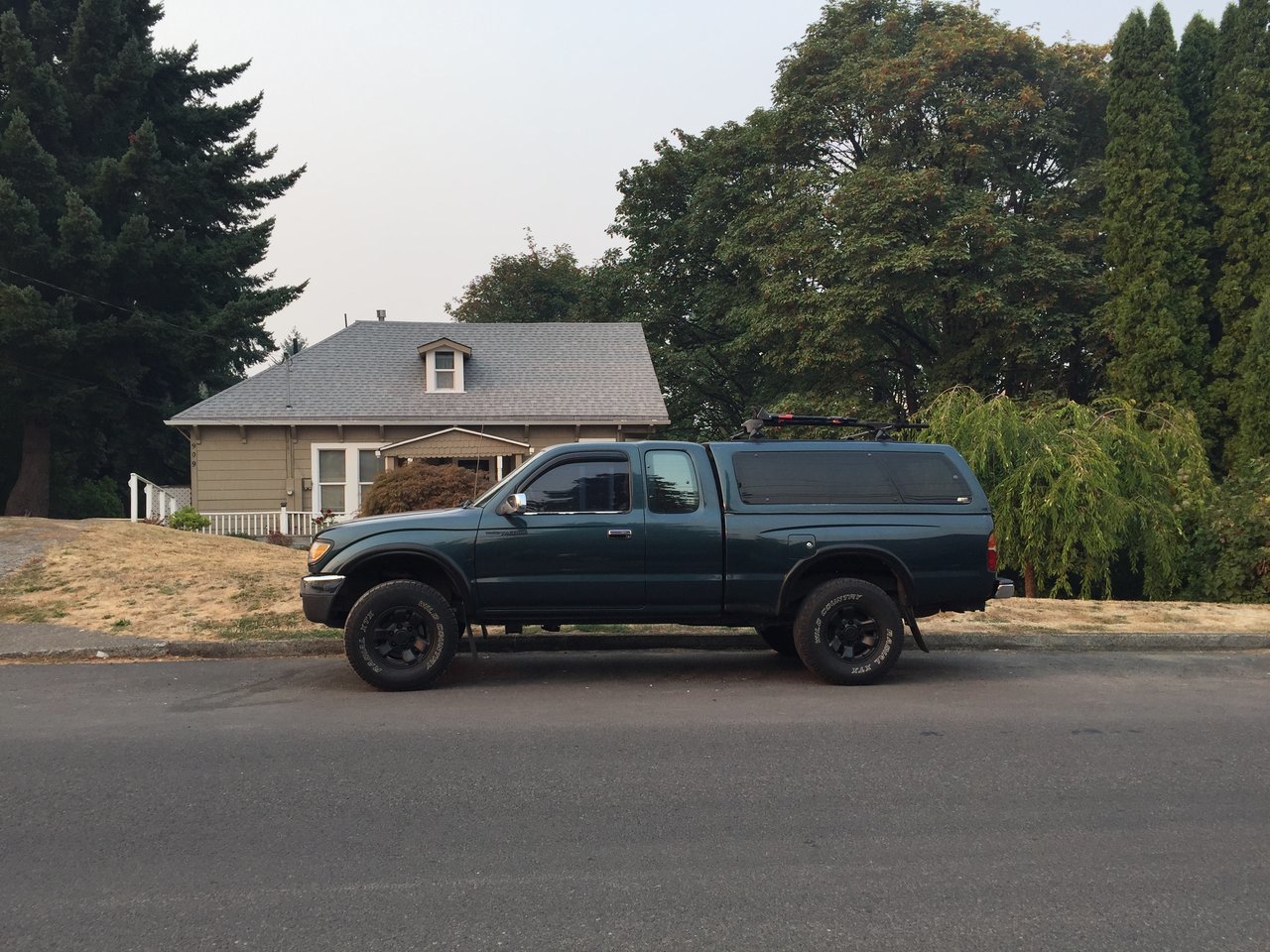

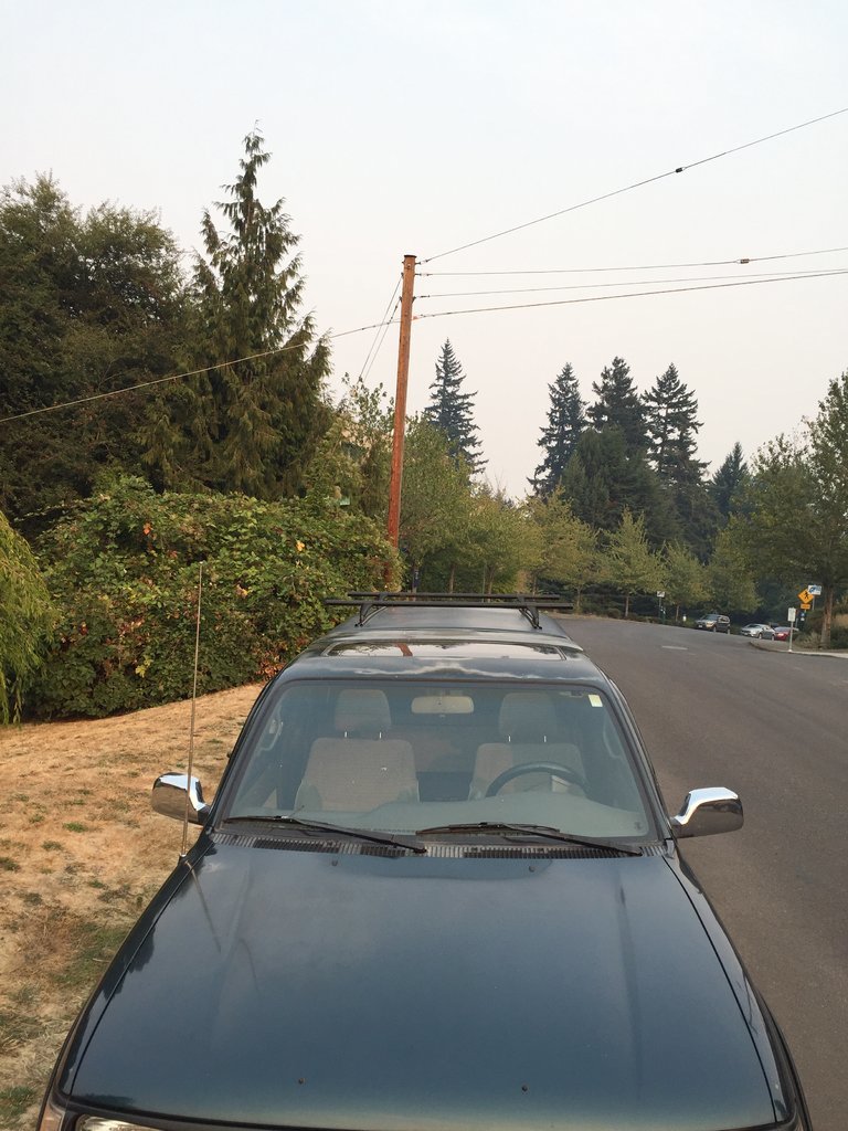

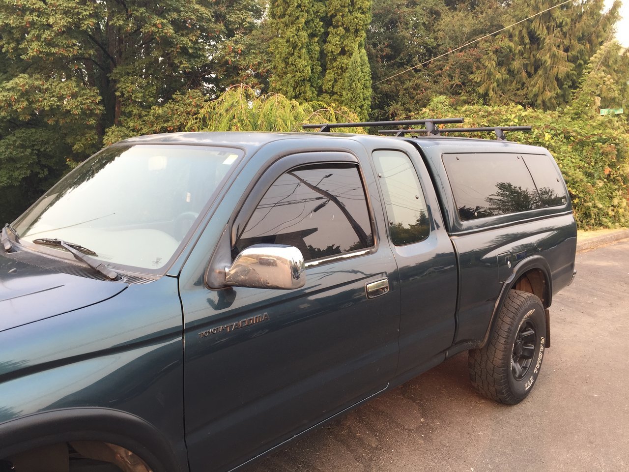

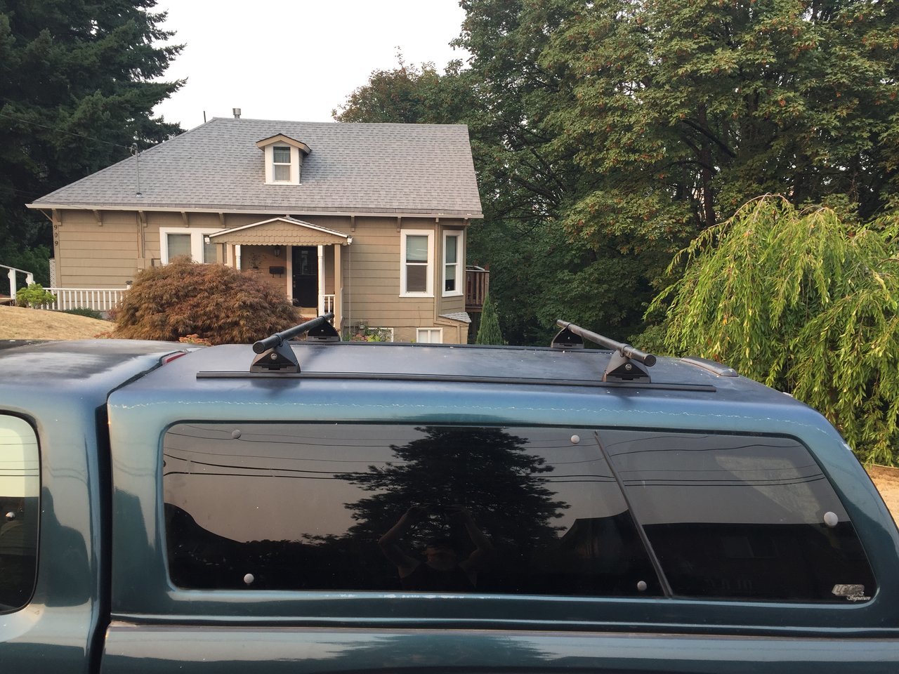

    Threw on some tracks and cross bars. Now to find a thin cargo box...
