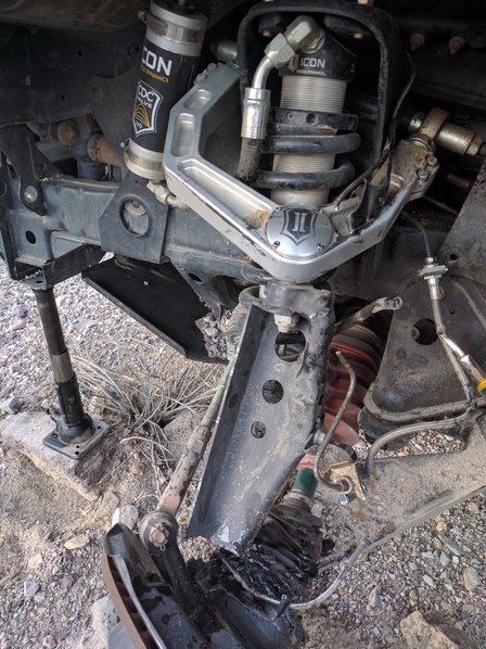

    Not sure about rules on posting other forum links here, but : My .02 $ : There are reasons both for and against it. I have seen stock BENT spindles on Tacos and other trucks. The only spindle FAILURES I have seen have been ones that had been gusseted. I would tread carefully here.
    https://www.tacomaworld.com/threads/another-spindle-failure-backcountry-dv.473931/
    This is a personal decision you have to make- if it were me I would run a fabricated spindle and do away with the LBJ at the same time. I'd rather spend some bucks up front than roll or wreck a truck due to an avoidable failure. I have repeatedly jumped my truck on stock spindles and they're fine. I would not do the same on a truck that had spindles gussets welded on.
    You're altering the composition of the metal in the spindle by welding/ heating on it and introducing the rod material. Having a welder doesn't make someone a metallurgist.

    Dude, we've been through this before. Stop spreading this kind of misinformation.
    Regardless of whether they are cast or forged, not pre- and post-heating the spindles will introduce massive amounts of residual stress to the base metal (spindle) as it is being deformed by the non-uniform heat input. The more residual stress is locked into the fabrication, the less additional stress it can handle before reaching its yield point, and then fracture.
    @Shubin you can do it however you want, the best and strongest (and most reliable) way would be how @Adude described above. Removing the hubs would make it easier to fully pre- and post-heat, but if you could find a way to localize the heat away from the hubs, like a torch, you might be ok.

    So I called total chaos and there professionals say they don't pre heat any of there spindles when they add the reinforcements. And the ones that do break are more then likely because of a hard impact that would more then likley break the stock one before it would the reinforced one.
    @Adude, how hard was your hit? And do you think if you didn't have the spindle reinforcement you'd be better off without it?

    That wasnt my truck its another members. I was using the pic in reference to make the point that modifications are not always benifiting. I have yet to brake the spindle on any of my 23 toyota trucks.
    Having delt with welding cast iron steel alumimum, along with forged steel parts, and machined. I leave some stuff alone, i would rather have a bent spindle to limp home then a broken one. Just because it works on paper doesnt mean it works in life.
    Just my opinion on the matter, I was not trying to set T.W on fire, or ruin or insult any persons.

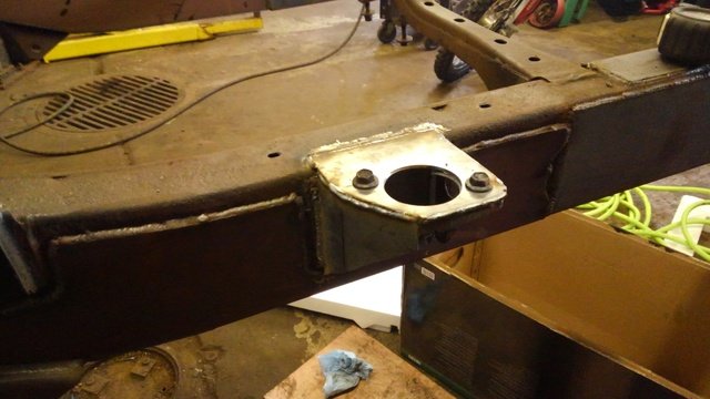

    99 Tacoma under construction
    Finally got the frame done today and sprayed with another coat of Corroseal. Now it's ready for paint and start the reassembly.
    Had to rebuild a cab mount.
