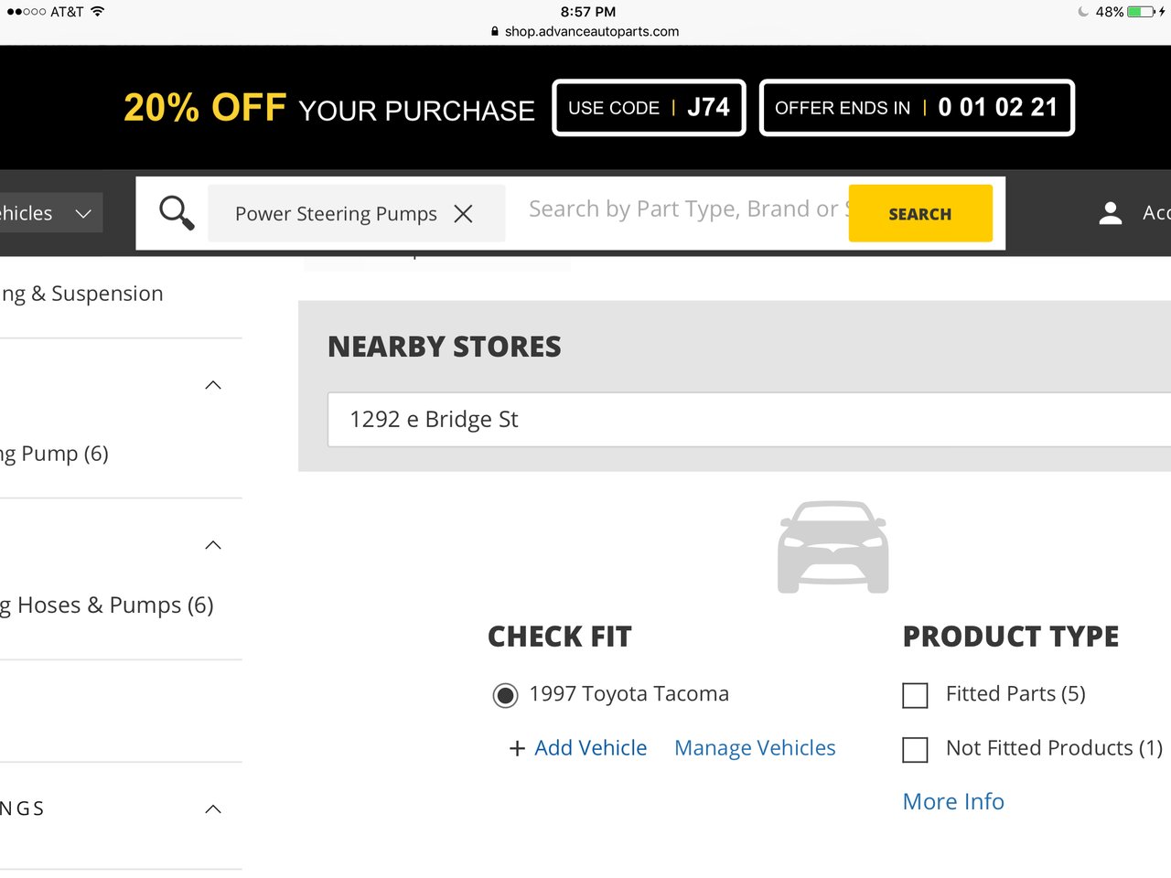

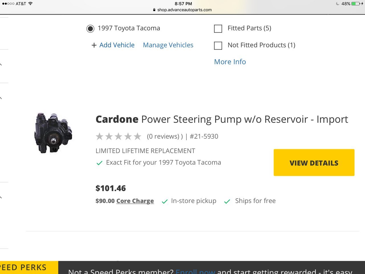

    Advaved auto has the pump for 101.00 minis a 20 percent discount from online purchase with lifetime warranty, will take u about an hour and a half to do.

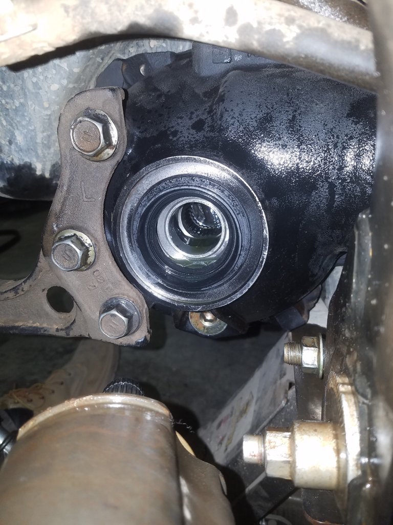

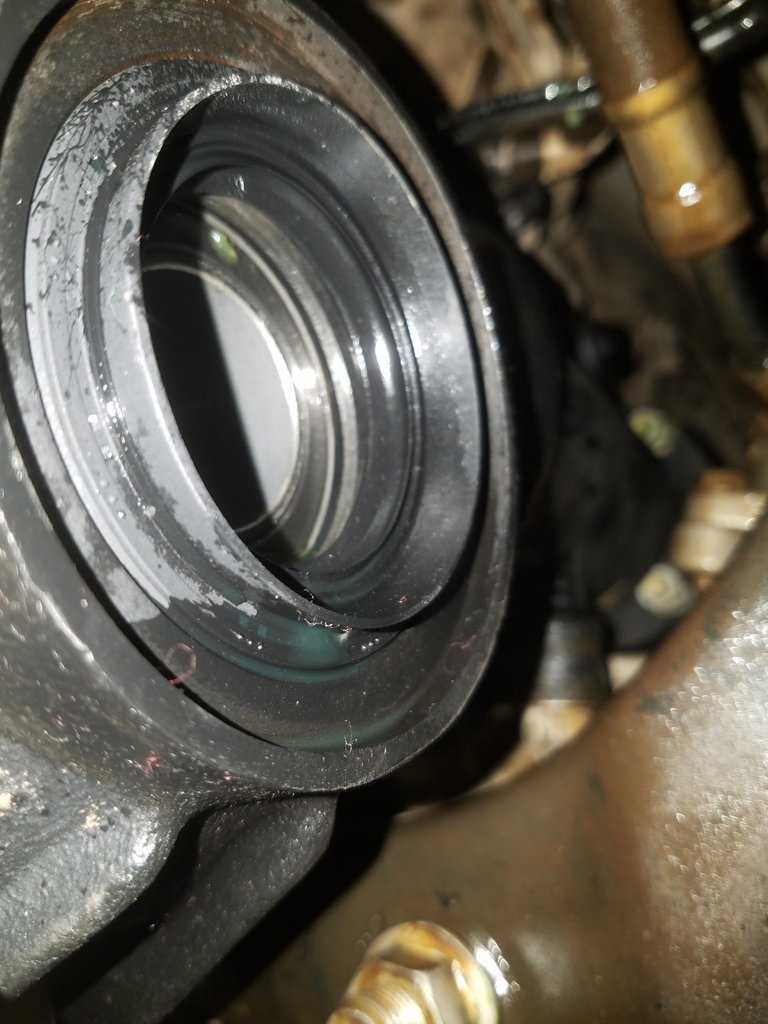

    After putting the front diff from ECGS yesterday I noticed it is leaking where the drivers side axle goes in. I pulled it out and everything looks ok. I cleaned it up and put the axle back in. I'll see what it looks like tomorrow and will call ECGS.
    Does anyone have any other suggestions to look at anything else?

    Depending on the drive train you have. Im a 6 cyl. The 4cyl had different pumps.
    Use the vin check.
    6cyl shaft 4431206010 its $16.35 from toyotapartsestore.com
    Take a picture of the front face of your pump. I dissasembled mine v6 2004 and it uses the p.s o ring kit for the 95-04 2/4 wd 4 cyl. Not the V6, the v6 kit didnt have the proper O rings.
    When you dissasemble it remove the fluid drive blades and flip them so the fresh edge is out.

    Is that seal worn out?
  17. Sep 24, 2017 at 8:23 PM
    stumbles
    stumbles 1 eye
    Aug 18, 2014
    #136442
    4,391
    bryan
    mesa
    2002 White Double Cab
    I don't think it is. Could be.

    Are you absolutely positive that you fully bottommed out the CV when inserting it, it is really easy to only insert it most of the way and it'll wobble.
    stumbles[QUOTED] likes this.

    I am hoping that is what it was after the late night yesterday. I made sure to really press it in tonight. I also cleaned the area up real good and will know more after I take it for a spin tomorrow.

    I always have to use my prybar on the lip and tap the prybar with a mallet to get them to seat fully.
