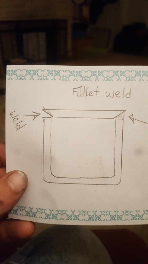

    Beveling the flat bar allows you to keep a nice straight edge, putting a fillet weld in allows you to keep that 90* edge. No cutting except for length. Then flapper wheel the slight convex high of the weld down and done. Clean edge solid weld. :cheers:

    wow great idea, hadn't thought of this!

    This is a good example. Just remember, bevel does not need to be perfectly 45 degrees. Grind a bit of an angle and weld it.
