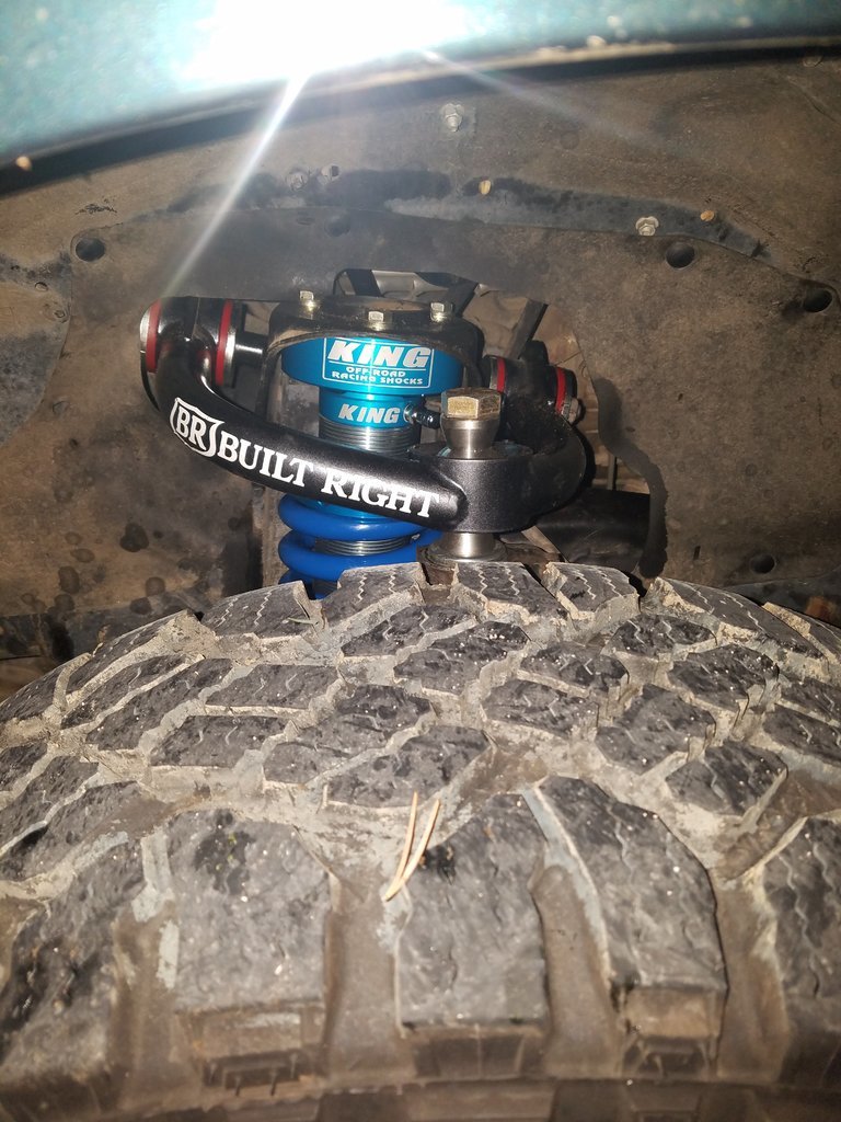

    20170929_211737.jpg 20170929_221519.jpg 20170929_221529.jpg Did my front suspension today!
    - New oem otre's
    - New oem lbj's
    -Built Right Fabrication uca's
    -King extended travel coilovers

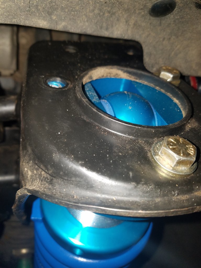

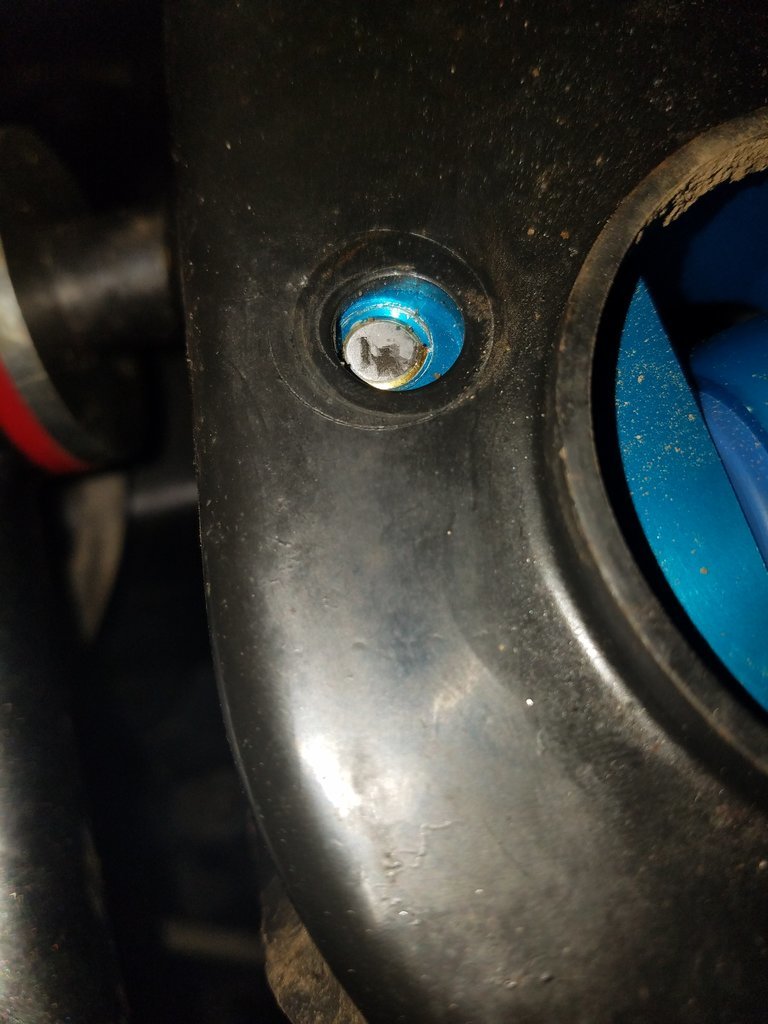

    Everything went very smooth until I decided to check the torque on my passenger side top hat, I snapped a bolt inside my brand new kings! :annoyed: Does anyone have any good ideas as to how I can get that sucker out of there? Also what should the top hat bolts be torqued at? 20170929_211737.jpg

    Looks like a nice setup! Don't forget to get an alignment... Bummer on the snapped bolt, there should be zero tension on it now so it'll be easy to spin out with an easy out or similar screw/bolt extractor, just make sure you drill a little starter hole so the easy out doesn't try to walk out on ya. I don't reef down on those bolts, they aren't under massive tension because the spring pushes up, they are there to locate and keep the shock from falling out under full droop. I'd read to see what King or Icon, or even SAW says in their instructions if you can't get it by feel. The top hat is aluminum so usually the threads in that would give before the bolt does, that's the weird part to me, that was a nice zinc coated high grade bolt. It should have ripped the threads out of the alum first before shearing off.

    Thank you, yeah I was going to try an extractor I've just never used them on aluminium before. I had planned to get an alignment tomorrow, but now I might be fighting with that bolt instead.

    Pull the coil/shock assembly first so you have room to work on it.
    Small punch and a hammer, light tapping, might just walk it right out. There shouldn't be any torque on the remaining threads, just maybe a burr, so to speak, at the point of break that will need to rise above the female threads. Might spin out from there.

    Tap it lightly from the top to try and get it out the bottom or tap it lightly from bottom?

    He means tap it in the direction of loosening it, from the edge with a pointed tool.

    ^^This right here. Tap from the top where it's broken.

    Cool that makes sense, I was over thinking it. Hopefully I have enough bolt sticking out to mig weld a washer and nut on there and get it out that way.

    Question, A)what type of bolt and coating is it, ie galv zinc stainless. B) is the housing aluminum and does it have never seize on the bolt if so.
