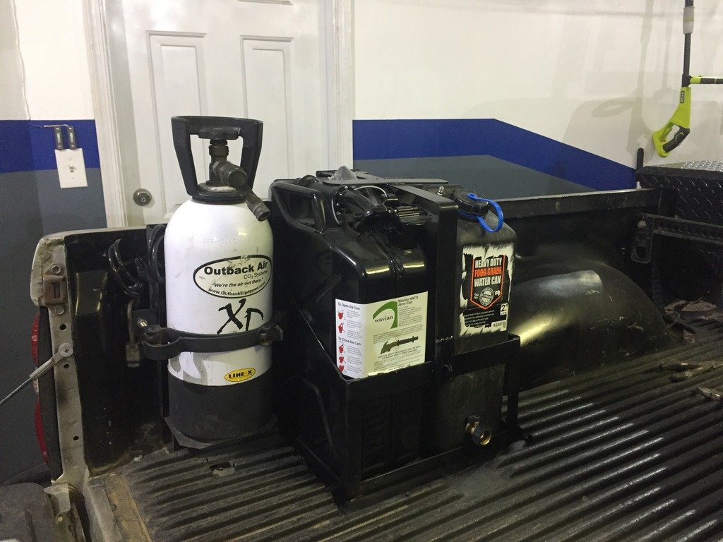

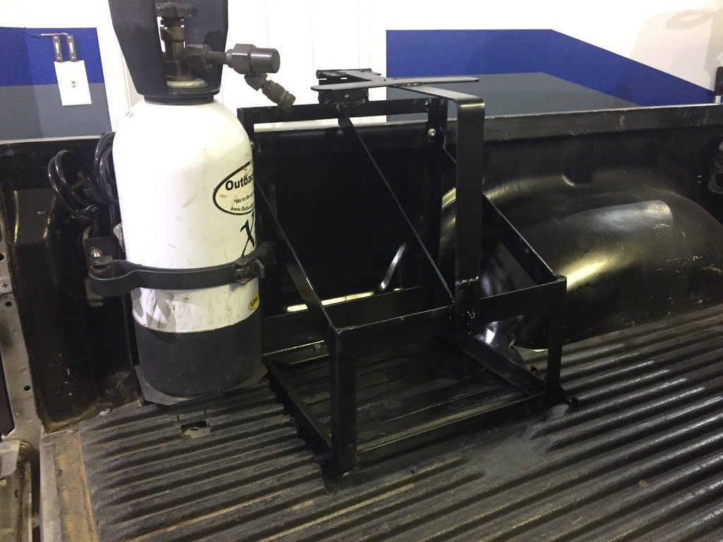

    Fully installed the jerry can holder I made:
