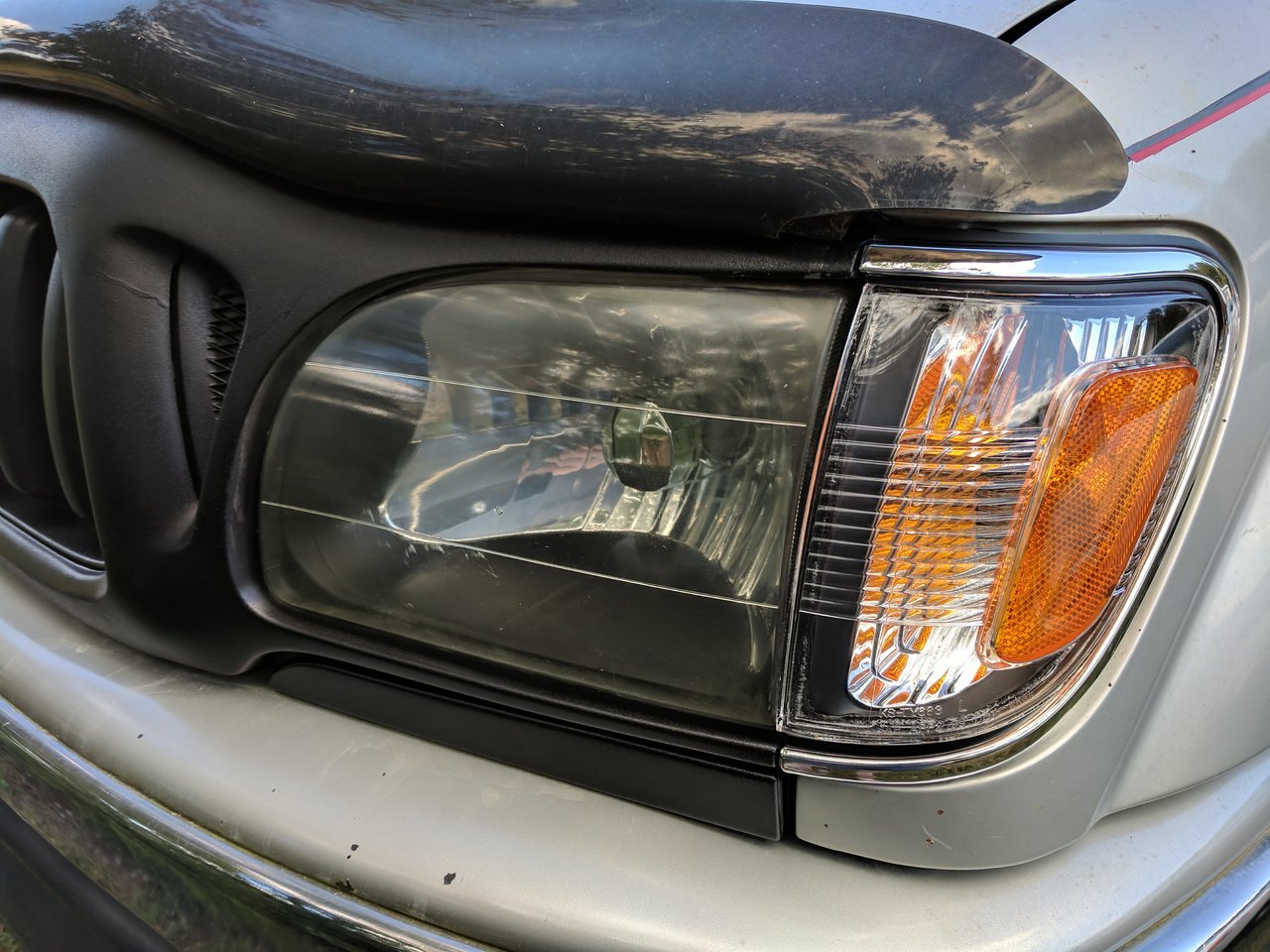

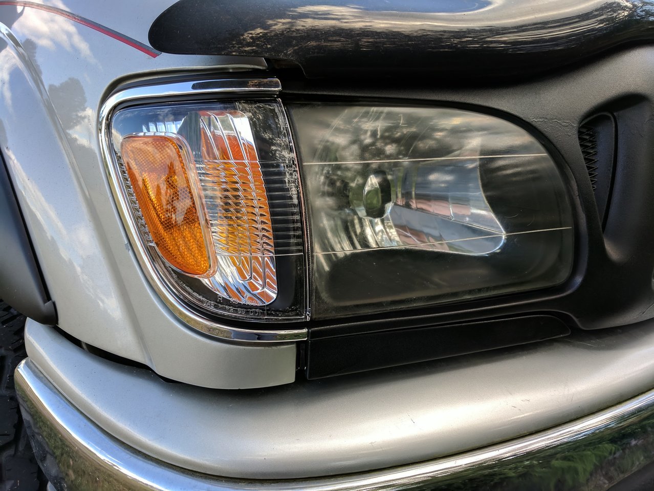

    Kind of a weekend of work but here goes.
    Cleaned headlights and I finally feel safe to drive at night again. Also, added new side marker light housings. Also replaced all bulbs since some were out.
    Spray on bedliner on the front grille...No reason in particular other than I was bored.
    Bolted down my Allpro bed rack and got rid of the vise grip temp holders.
    Ripped out the antenna mast completely and clipped the antenna wire because I just got frustrated with it. Now I get to pull the radio and re-run the entire deal :-/

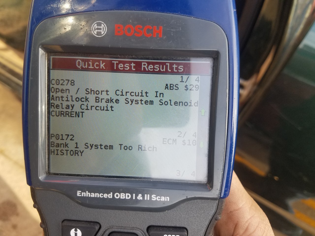

    Had oriellys do it. Didn't tell me the codes
    Went back by and got a pic

    Does anyone know where the abs solenoid relay is?

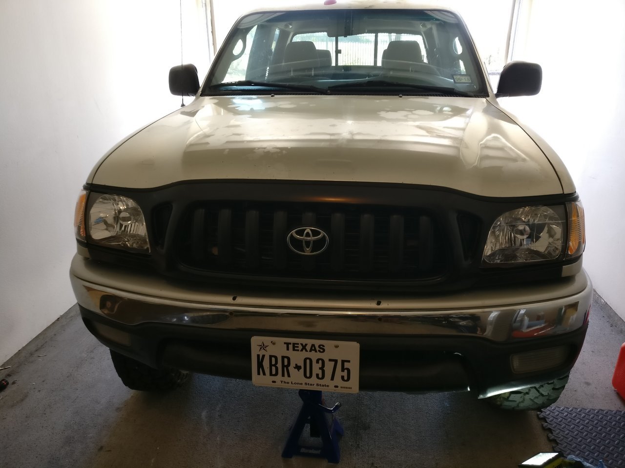

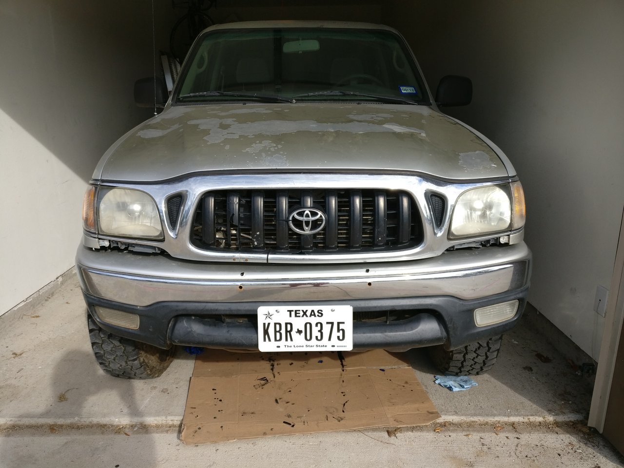

    New grill and light housings
