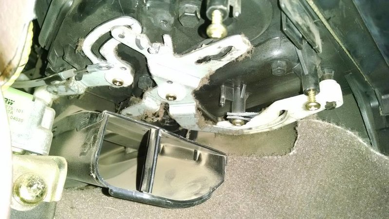

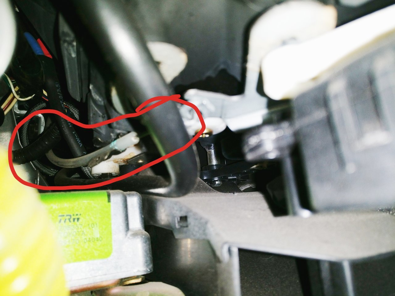

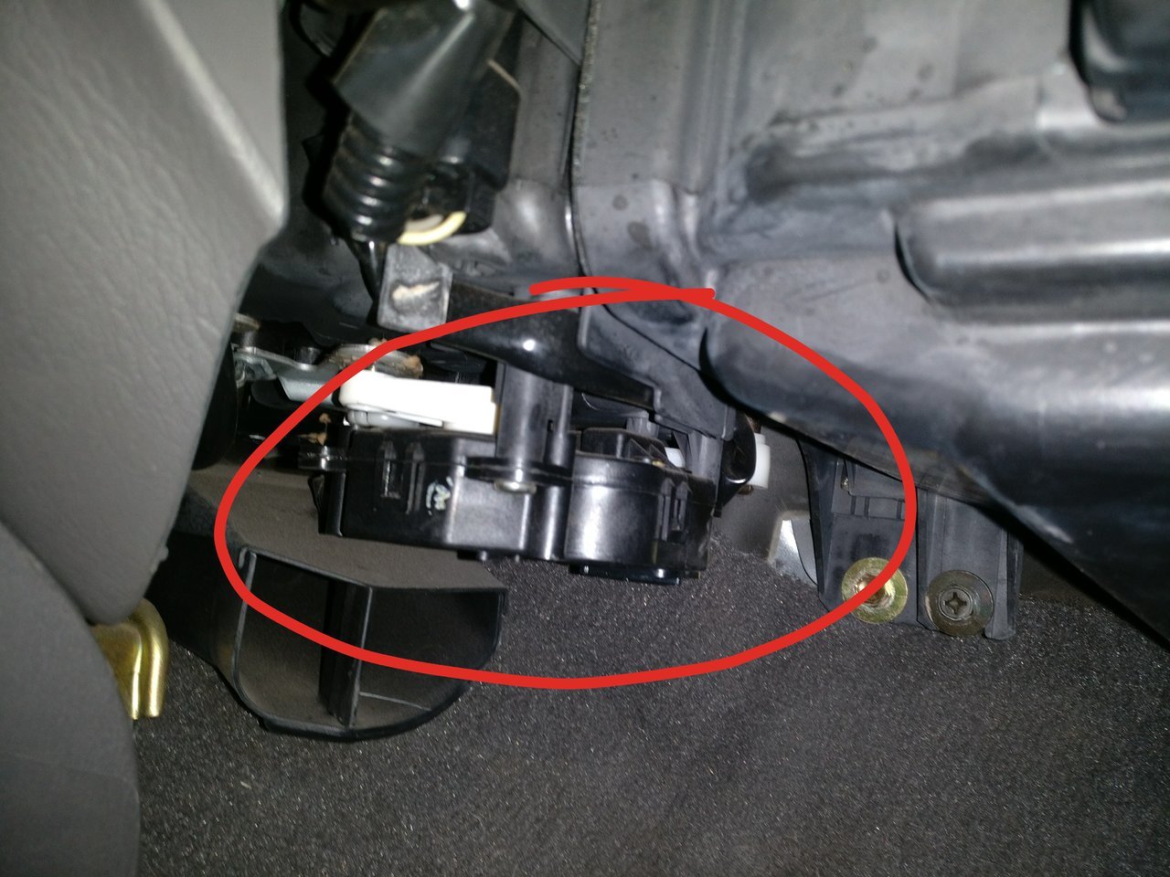

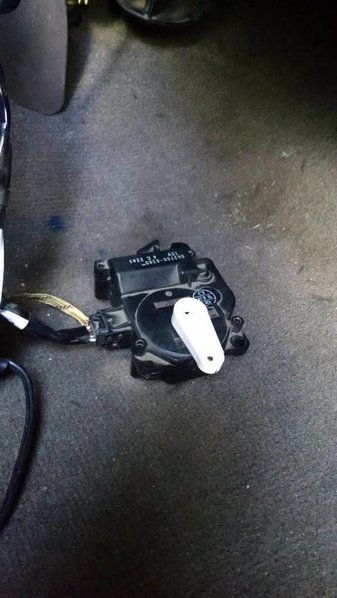

    Does anyone know what this does? While driving it now seems like it's moving every 2 mins or so when I'm sure it wasn't that way before.
    I watched it while it would adjust and it doesn't seem to move that much... It's located under the passenger side dash. Any ideas?
    Seems to move this white cable...

    Vent control unit.
    Here is one that is fubar.
    This is what it's controlling.
    It's actually called a blender unit, or servo.
    Not my pic , but this is the internal guts.
    On his, some of the teeth stripped on the gears and it wouldn't allow the heat to be turned on. It also kept trying to move and made a clicking noise as well.

    Thank you!
    Edit: just went out and checked to see if it would go all the way to heat and all the way back and it seems to do so with no issues... I'm not sure why it keeps randomly slightly adjusting

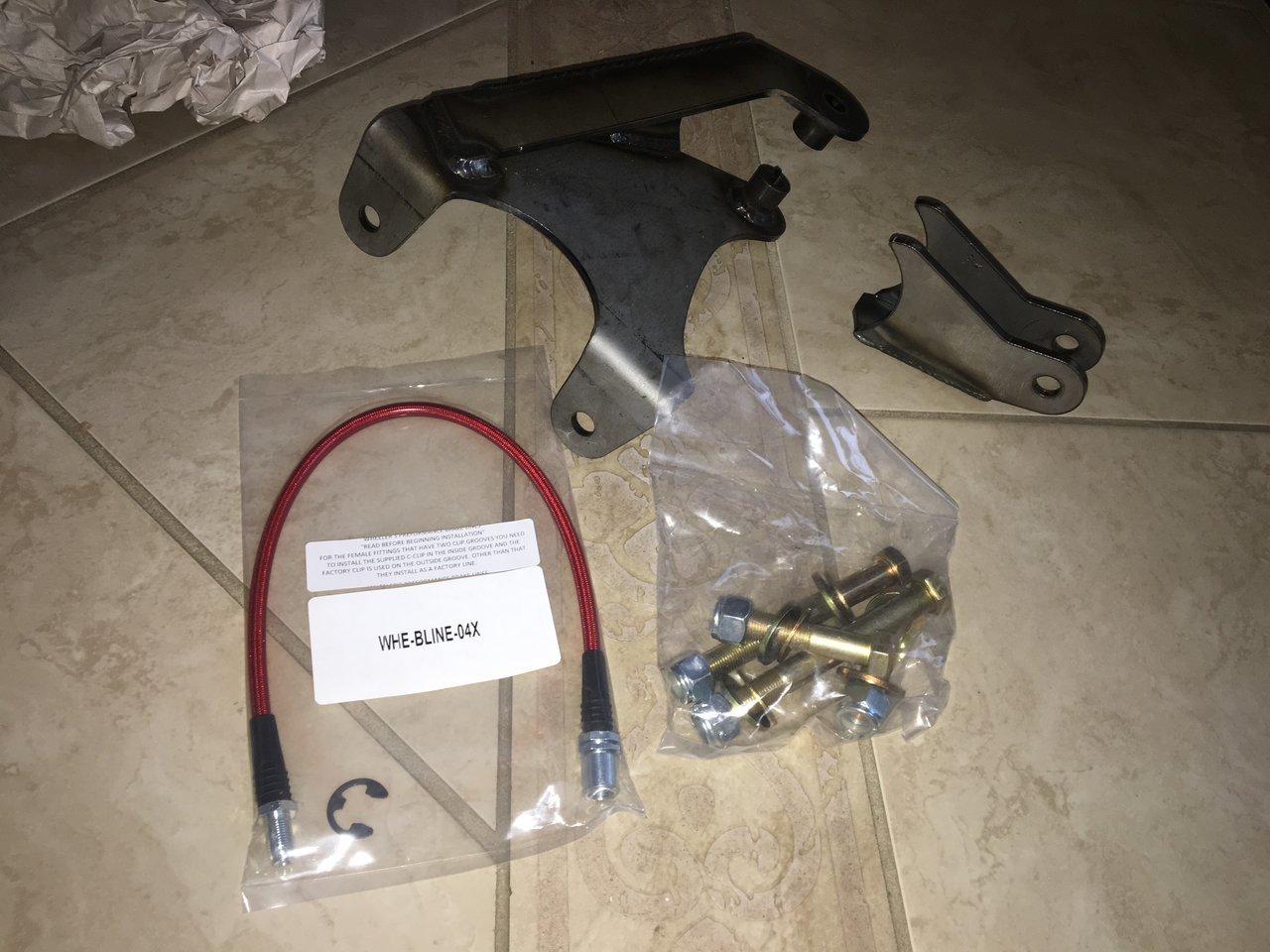

    Who makes that kit ?? I missed the post somewhere.

    Total chaos. Requires wheel spacers to run or wider axle

    I read an article about the pins that touch an element on the back of that big gear you see. I am not sure what site it was on....however there are pins that ride on the inside of that big plastic gear. the article says you can bend the pins up to make better contact. I took mine apart last week and tried it however it still clicks and moves a little bit. I am just going to order a new one i guess. I didnt see any gears missing on mine.... The screw that is furthest to the back is a bitch also. Get a little stubby screwdriver to remove it.
