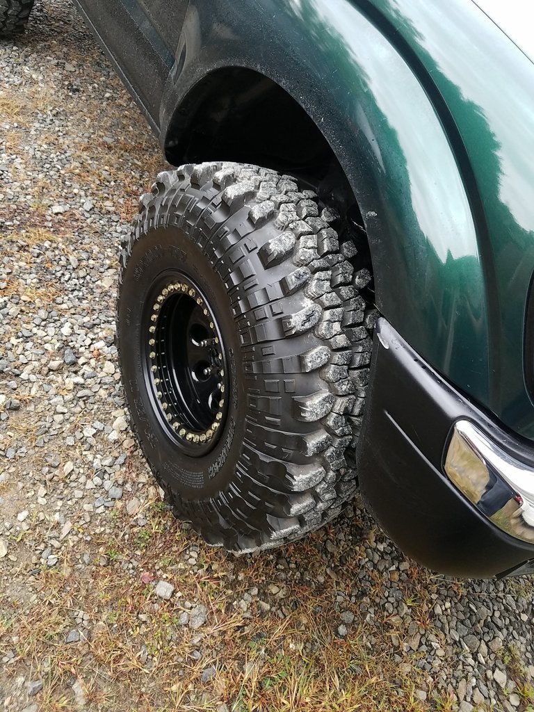

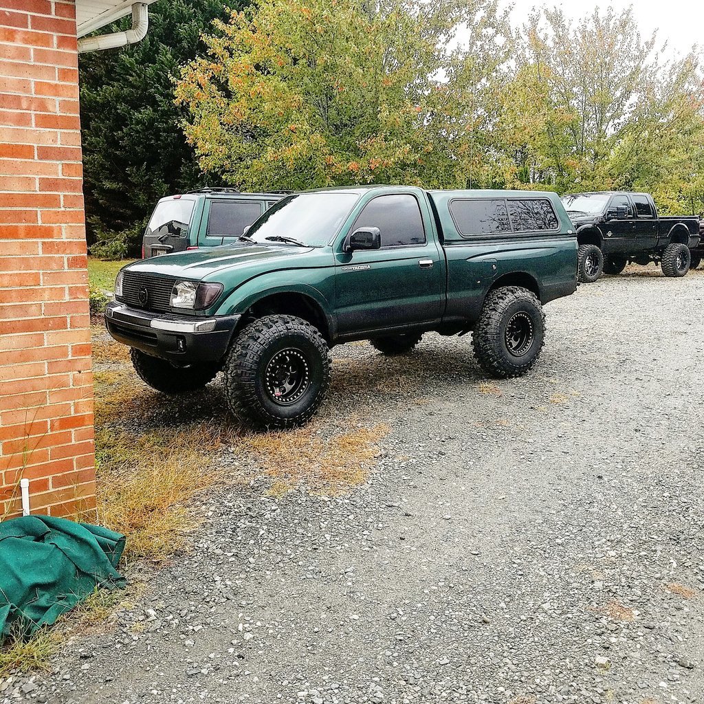

    I took it out this weekend and the only place it rubbed was in the rear where the bed is close to the tire. Other than that it was awaesme!
    These are 35x10s on 15x8 with 3.75 back spacing. Its just a toytec 3 inch spacer lift and it honestly barely rubs. It rubs more on the back of the bed than in the front. It already had the bumper and fenders trimmed for 33s on 12 inch wide sheels. All i did was some sawzaw and hammer work to the inside of the fenders. I took it out this weekend on a decent run and it did awesome. My 33s rubbed more than these do and they are a true 35.

    You havent tubbed?

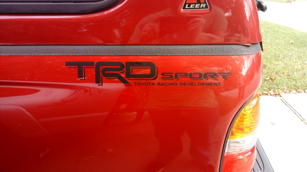

    Spacer lift is limiting your uptravel in the front. Probably why you're not rubbing to much.

    Nope

    Drop bracket lift and booger welds
    This combined with the increased BS and narrow tires for sure.

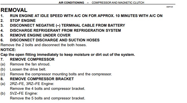

    FML and this truck.....ac work is in order now since I punctured the damn condenser. Well, Fall is coming so I probably can hold out for now.
    edit: so this is what the FSM has to remove the compressor. Its VERY detailed

    Pretty easy to remove it really. It's the condenser on the inside that sucks

    So does it come out of the bottom or the top?

    Hmm I think I pulled it out the top by pushing it forward..or out the bottom..can't remember. :oops: but I pushed it to the front of the truck and then it came out. Took some fanageling but wasn't bad
