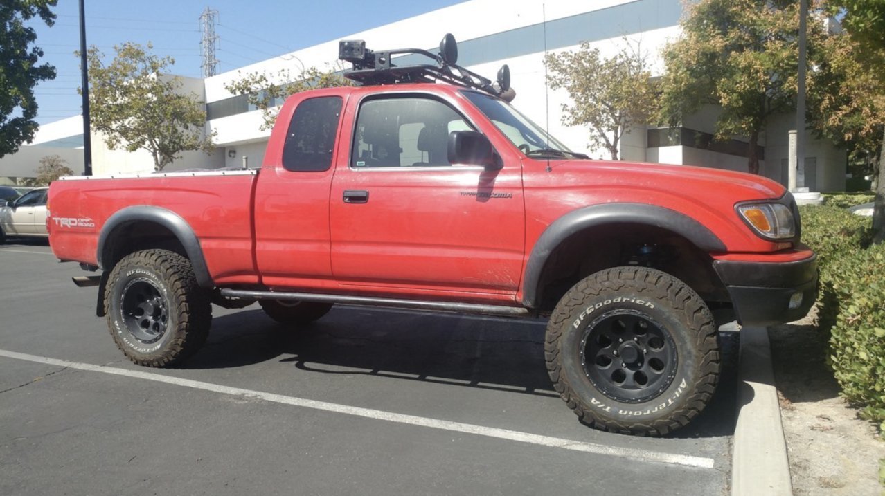

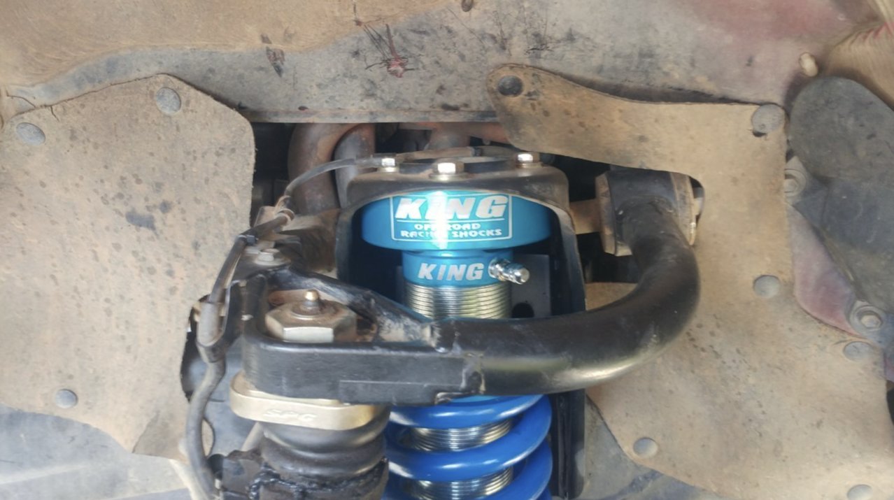

    Looks perfect
    How is CV angles ?

    Thanks! They're good but I wouldn't go any higher than I am now...the fins are just a hair apart in some angles. Going to keep a close eye on them

    I had the front lifted about 2" with my previous setup and the angles were still good; no rubbing at all

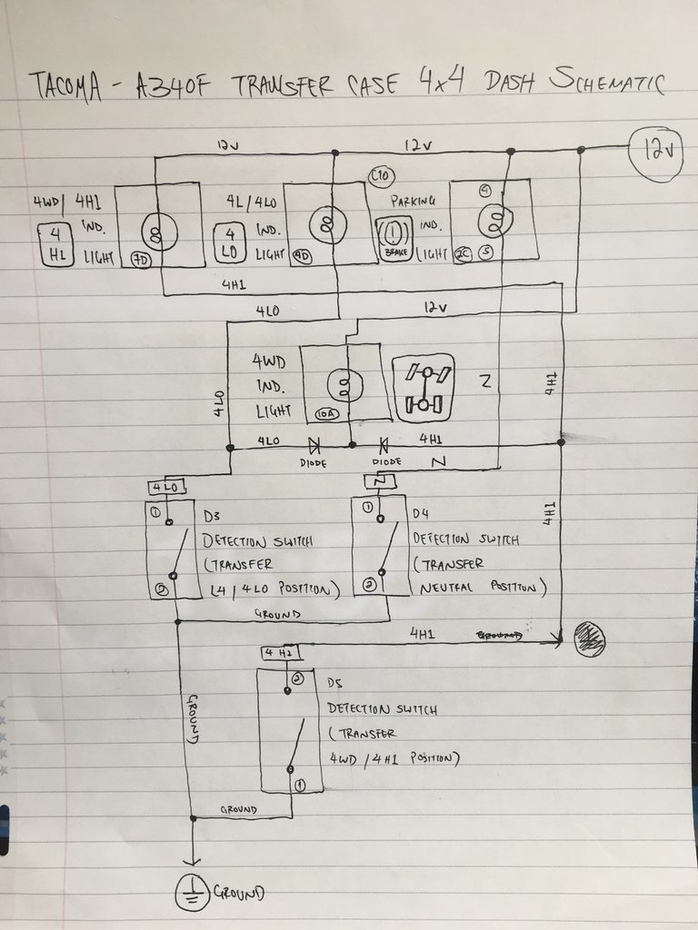

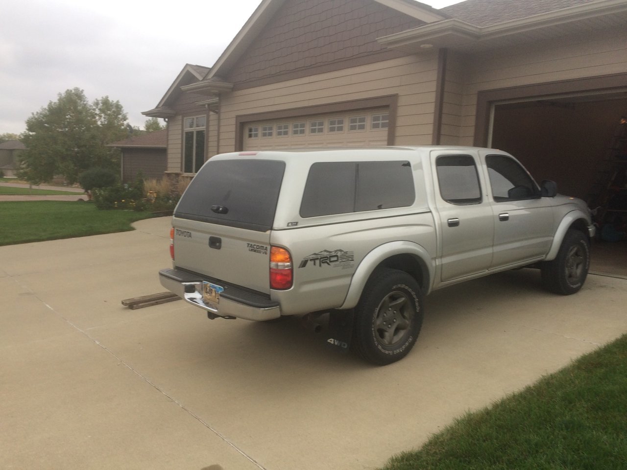

    Anyone good with electrical? For my 4x4 PreRunner conversion I'm trying to be extra and utilize the 4HI/4LO/Neutral detection switches on the transfer case and wire them up to unused dash lights, specifically the RR DIFF LOCK and ABS lights as well as tapping the BRAKE light for transfer neutral.
    Can anyone spot anything wrong? I'm planning on having a custom transparency printed for the 4 HI and 4 LO lights.
    So for example if the truck is in 4 HI or 4 LO, the 4WD symbol as well as the 4 HI symbol will both light up. If the truck is in transfer neutral the BRAKE light would light up.

    seems like a lot of work for something that just a glance down at the shifter will tell you or just touching the shifter would..
    But yes, just tapping the 12v and sending it to the lights would work just fine.

    Ah ok
    What’s the total lift now ?
    2 inch would be limit for oem like cv angle ?

    I'm at 3" with the Kings. Seems to vary by individual setups but I think most people running 2" of lift or less don't run into CV angle issues.
