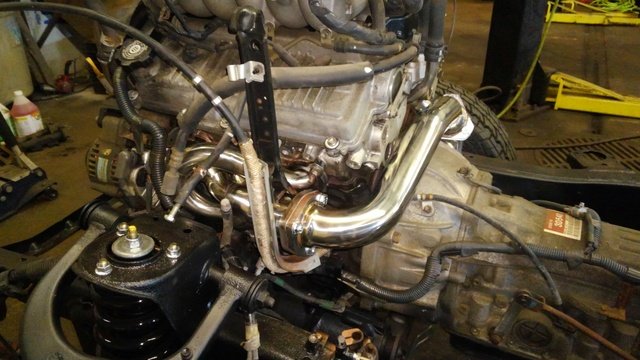

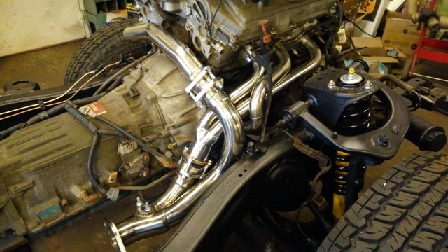

    Can't imagine putting these headers on with the cab on, as it was there was a fair amount of tweaking. Had to grind a bunch of material off the flange on the y-pipe where it mates to the right side header as it wouldn't turn far enough to index and the bolts would've been at quite an angle. Next up timing belt which should also be much easier with the cab off.

    The engine, tranny, and chassis reminds me of a 4wd dune buggy I had years ago. That thing was light and would scat!! :burnrubber:

    Well that looks pretty neat.

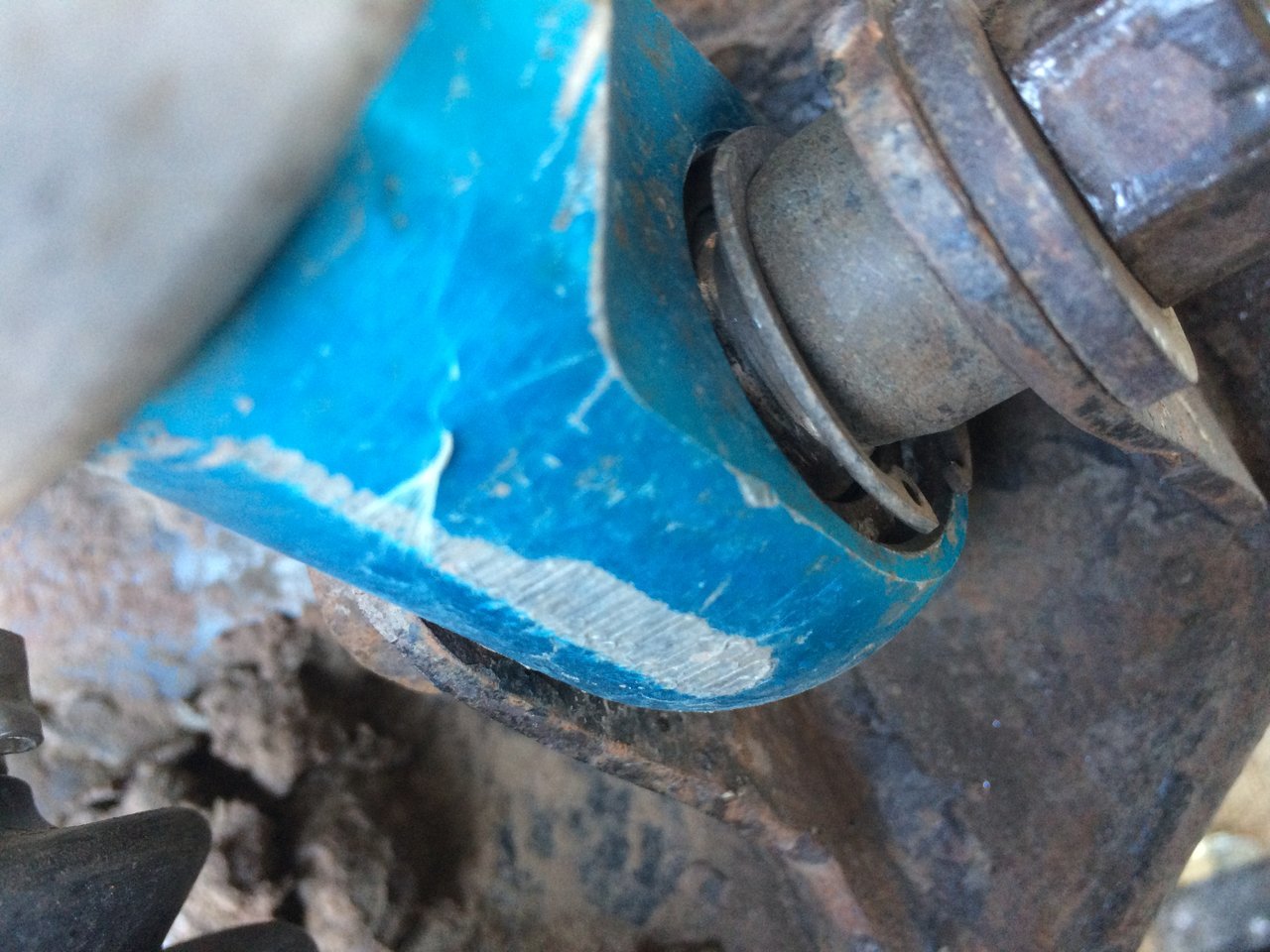

    Not good!

    Still gonna send it though

    Were you sending it?

    No, I just noticed tonight looking for a noise. I dunnno how long it’s been like that.

    Gotta send it harder then bud:p

    I know a 285 on stocks will fit but the frame and UCA don't like them haha
