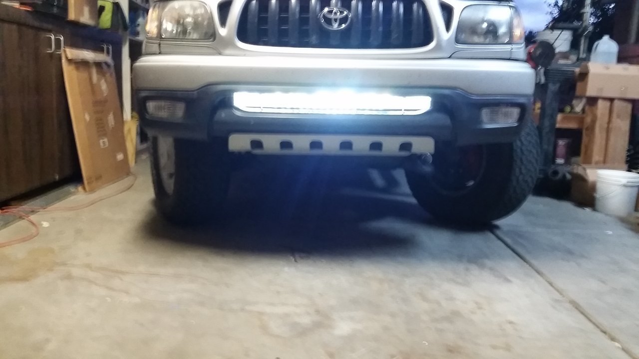

    I got my winch mounted to my bumper, then called it quits for the night.

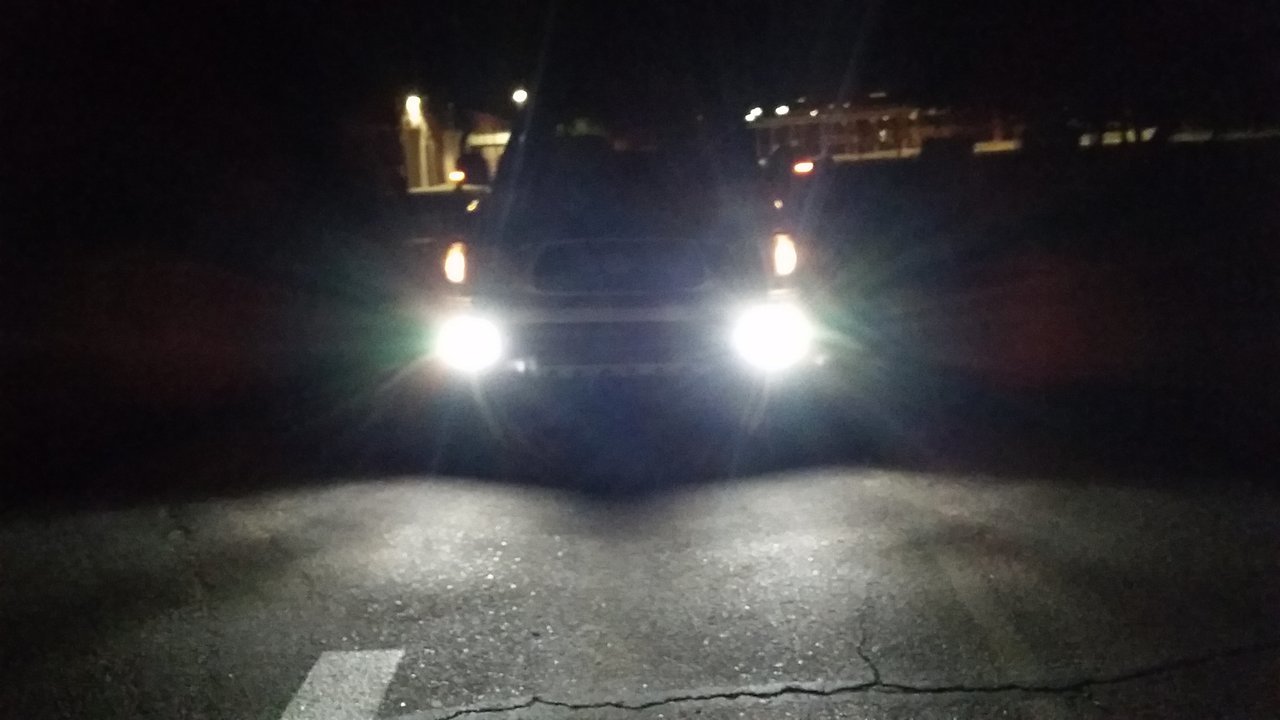

    Dude, can you link the LED bulbs you got for the overhead cabin lights and instrument panel lights? I have a blown light on my fuel gauge so I might as well replace it all. Looks good.
    edit: nevermind, found the link in the description on youtube (doesn't transfer when embedded here)

    Who made the bumper that you are running? How tight is the winch in it?

    @mechanicjon the lights look awesome. The final look is clean. :thumbsup:

    It's the all pro apex bumper. Winch fits good and tight!

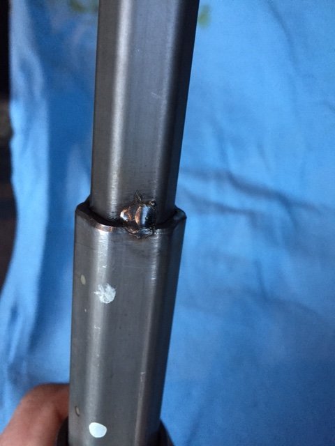

    I was getting a strange click/clunk in my steering wheel when I went over speed bumps or backing out of a driveway at an angle. Turns out, it was the steering shaft just behind the steering wheel.
    Where the shaft is meant to collapse in the event of a crash, it had developed a bit of play that was amplified through the steering wheel. I pulled the shaft, tack welded a couple spots and reinstalled it.
    No more noises or clunks and it's 100% again. #feelsgood
    Shops were trying to quote me huge money to fix the "front end" when it was this all along.
    30 minutes total time (1 bolt, 2 allen screws, 2 springs and 3 phillips screws.
    My buddy did the tack weld (took the most time)
    The tack welds "should" break in the event of a MAJOR head on. It's merely just to take up the minimal play
    (not my pic, taken from net)

    @indetrucks were you feeling it in the steering wheel? Any pics of where you tack welded...thanks

    Oh yeah, I could really feel it in the steering wheel. I thought I had some major suspension repairs ahead of me. I have an 03 with 140k on it, so figured I was in trouble.
    After searching and reading , nope. Easy fix... (pics in that link as well)
    I have heard however, having tilt steering makes this a 30 minute fix. Otherwise, it's a PITA.
