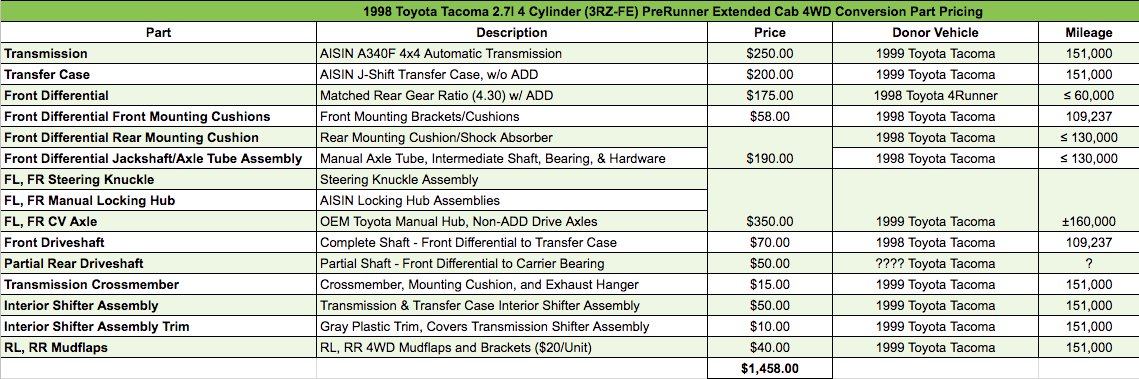

    I just got my last PreRunner 4x4 conversion part in the mail last week, in case anyone was curious here is a price breakdown of each part and what you need. I read through a lot of write-ups on here and none of them had a comprehensive parts list and price cost.
    This list assumes you have a 1995-2002 mechanical throttle drivetrain, and you will be using a J-Shift T-Case, and manual hubs along with a manual hub axle tube/jackshaft. I could have saved a couple hundred dollars using ADD. 2003-2004 trucks are a lot harder since they utilized an electronic throttle with a kickdown cable.
    All in all I'ver paid $1,458 so far, I expect to pay a couple hundred more in new ball joints, oil seals, a transmission fluid service, and an alignment. Not a bad price if you do all the work yourself.

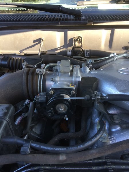

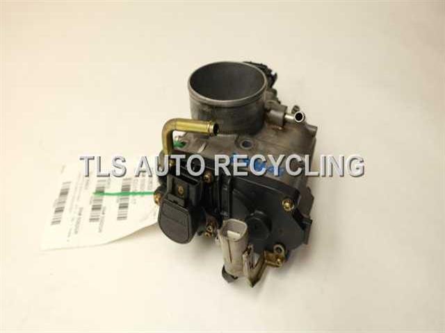

    easy. Open the hood and look :)
    Mechanical will look like this:
    Fly by Wire like this:
    The difference is a mechanical setup is just a cable that is connected to your accelerator pedal.
    Fly by wire is electronic. So a sensor senses how far the pedal is down and sends a signal to the actuator that is mounted in the throttle body that tells it how far to open up.
    A fly by wire setup will have two electronic plugs and no cables. One for the Fly by wire, one for the TPS. Mechanical with have the cable, sometimes two if there is cruise control, and one electronic plug for the TPS.
