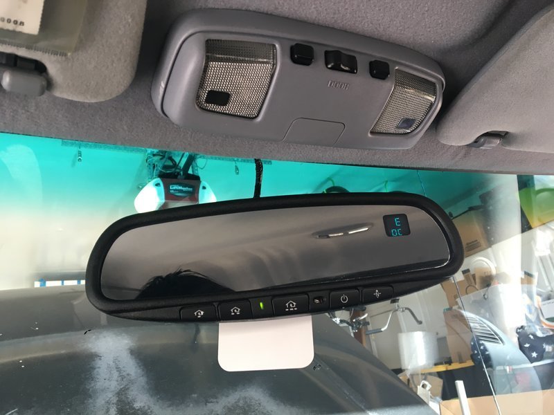

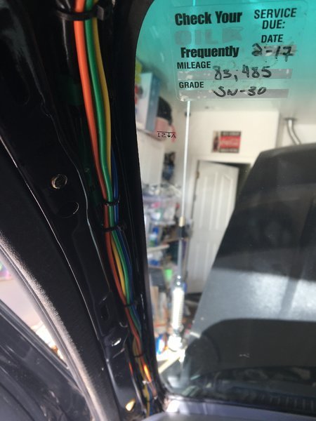

    I used a Homelink/Temperature/Compass/Autodim mirror from a 2012 Nissan Titan. I wanted the garage opener and it was hard to find in this configuration. I think the 3rd gens have this mirror as an option.

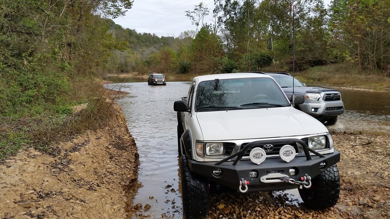

    Tennessee Dirt Devil Trail, yesterday

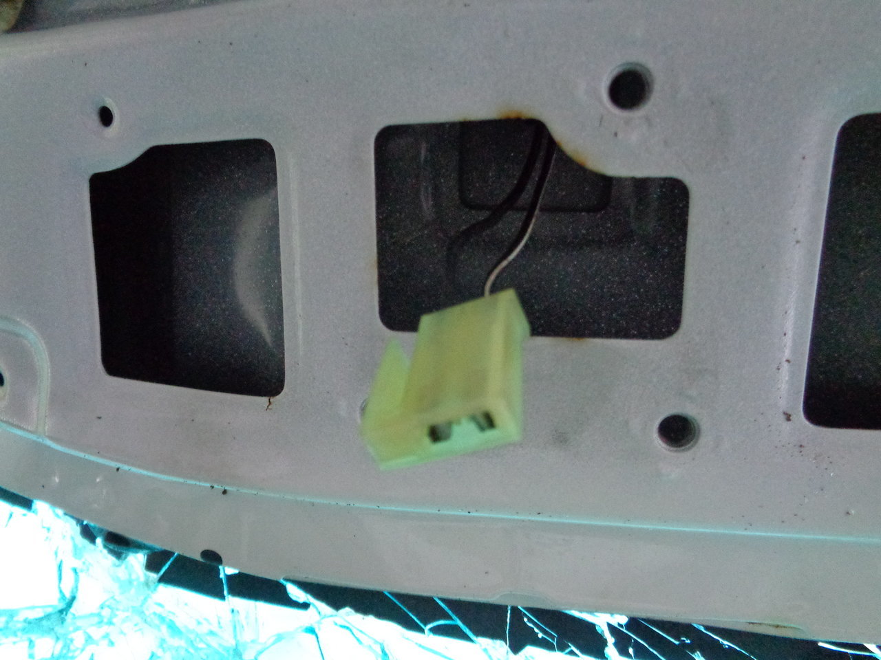

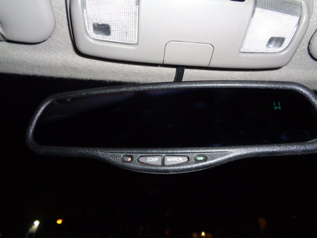

    Under the mirror bracket is the power plug (I16) for the dome and map lights. There are one or two wires, black and black with a white stripe, depending on what options you have. I would find a mirror at the junk yard and get as much of the wires that where attached. The black wire is for the map light, this would be your positive. you would then have to tap into it. Then attach this black wire to the black with yellow strip of the power mirror. Then you would need to make a ground and attach it to the metal were the mirror bracket mounts. This ground would then attach to the white with black stripe of the new mirror. The black with with white wire has power only when the door opens. It is just a power and ground is all that the new mirror need to work. To answer your question, I have all tundra wiring in my truck with the Tundra v8 that has provisions for the stock automatic mirror.DSC00348.jpg
