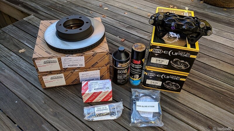

    Nearly Tundra brake'd today.
    Actually, everything's installed except for one @Wheeler's Off-Road Inc front brake line, which was defective (couldn't move the middle support bracket on the line to the necessary position). Called up Steve and he's sending out a new one. Hopefully it gets here tomorrow. Or Friday at the latest. 'cause man, I don't want to have the truck just sitting out there all weekend... (c'mon Steve! :))
