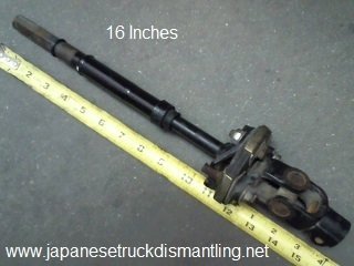

    Anybody help here..... can you center the steering wheel by loosening something on the linkage? Mine is off center now.

    The shaft coupler right above the rag joint can be loosened and rotated a bit. Pretty easy and should only require a 12mm socket.

    Thanks buddy! Is that just aft of the firewall where the linkage runs down to the steering rack? I looked up there and saw a few different bolts. I had to pull the linkage sort of off before I forget why.

    Let me go take a picture... it is easy to adjust that one from your picture looks like it isn't adjustable.

    Alright, see the bolt on the coupler in the red circle. If that is loosened enough you should be able to turn the steering wheel independent of wheels on the ground, once centered tighten it back up. You should only ever use this to make really small corrections. I only had to use it once to get my steering rack in and out so I'm not sure if that is it's proper use but it worked easy enough for me.
