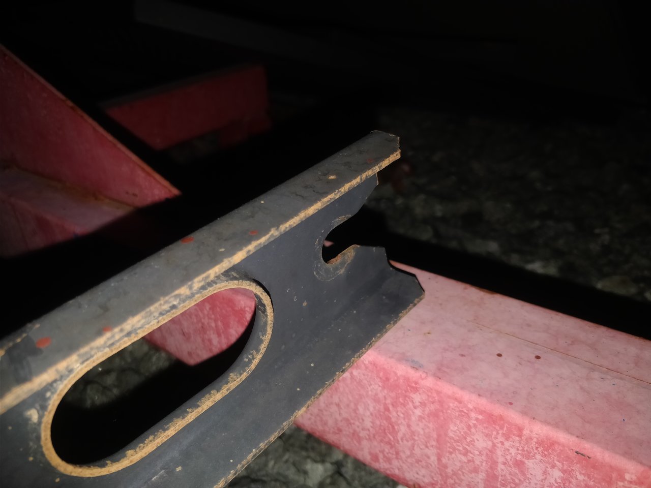

    Wut, pretty sure you have to remove all four bolts

    Nah, he's right two of the holes are slotted so you can just loosed those bolts and pull the bracket out from under them.

    Are they an L slot?

    straight

    I'm confused on how it slides out then?

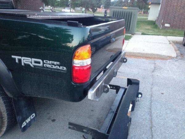

    I don't have an easy way to draw a picture, so I stole someone elses pic. Yes I know it is an aftermarket bumper but the stock one mounts the same way. See, a slot and a hole, remove the bolts from the hole and loosen the ones in the slot.

    Oh I see, I think my bumper is different? I don't remember that. Hold up lol

    I'll be damned! Had to run outside and see it lol
