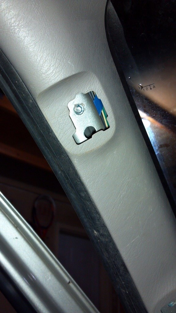

    Installing the bluetooth mic just now and I loosened the oh shit handle to tuck the wire behind the plastic. Went to tighten the handle back in place and the damn bolt broke. :anonymous:
    Best way to get it out?

    Same happend to me i drilled the bolt out and retapped the threads.

    You will need, if you don't already have one, a screw extractor tool. Basically you will drill a pilot hole in the center of the broken screw (or bolt in your case) and then take the bolt extractor bit (which has counter clockwise threading), lightly tap it into the pilot hole with a hammer and with downward force hand tighten in the pilot hole counter clockwise and it will eventually grab the broken bolt and will start rotating the bolt out.
    See here

    Thanks guys, I've never had to use a screw extractor so it never really crossed my mind. :facepalm:

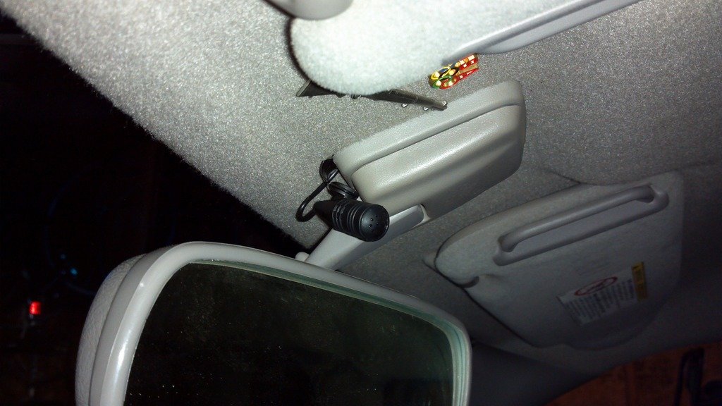

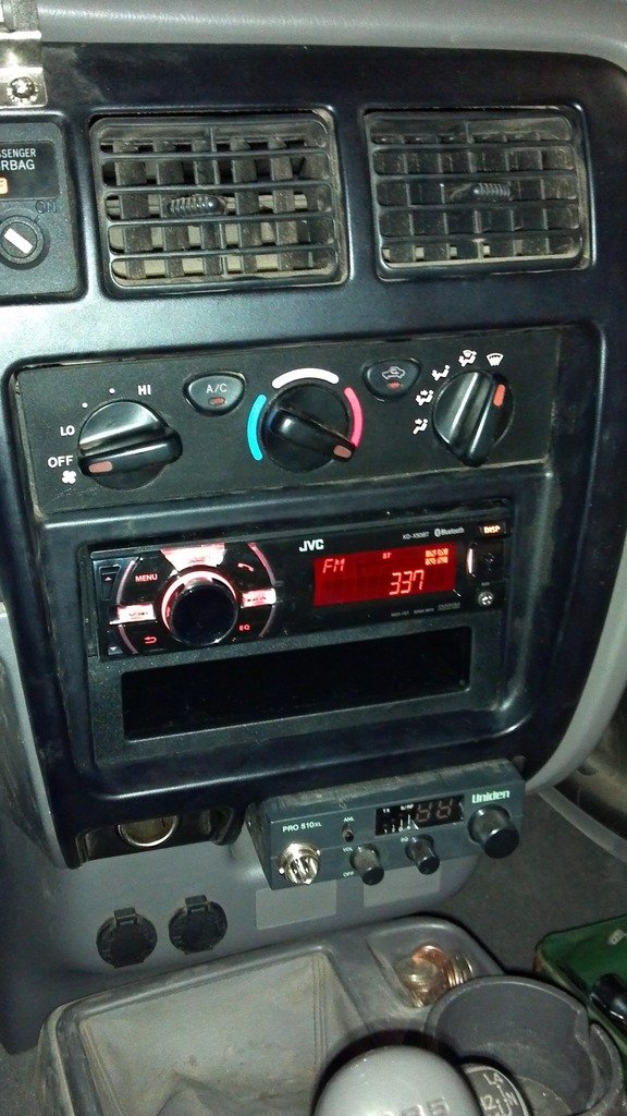

    Finally got the Bluetooth thingy installed

    Nice. If u dont mind me asking.. How much and what unit?
