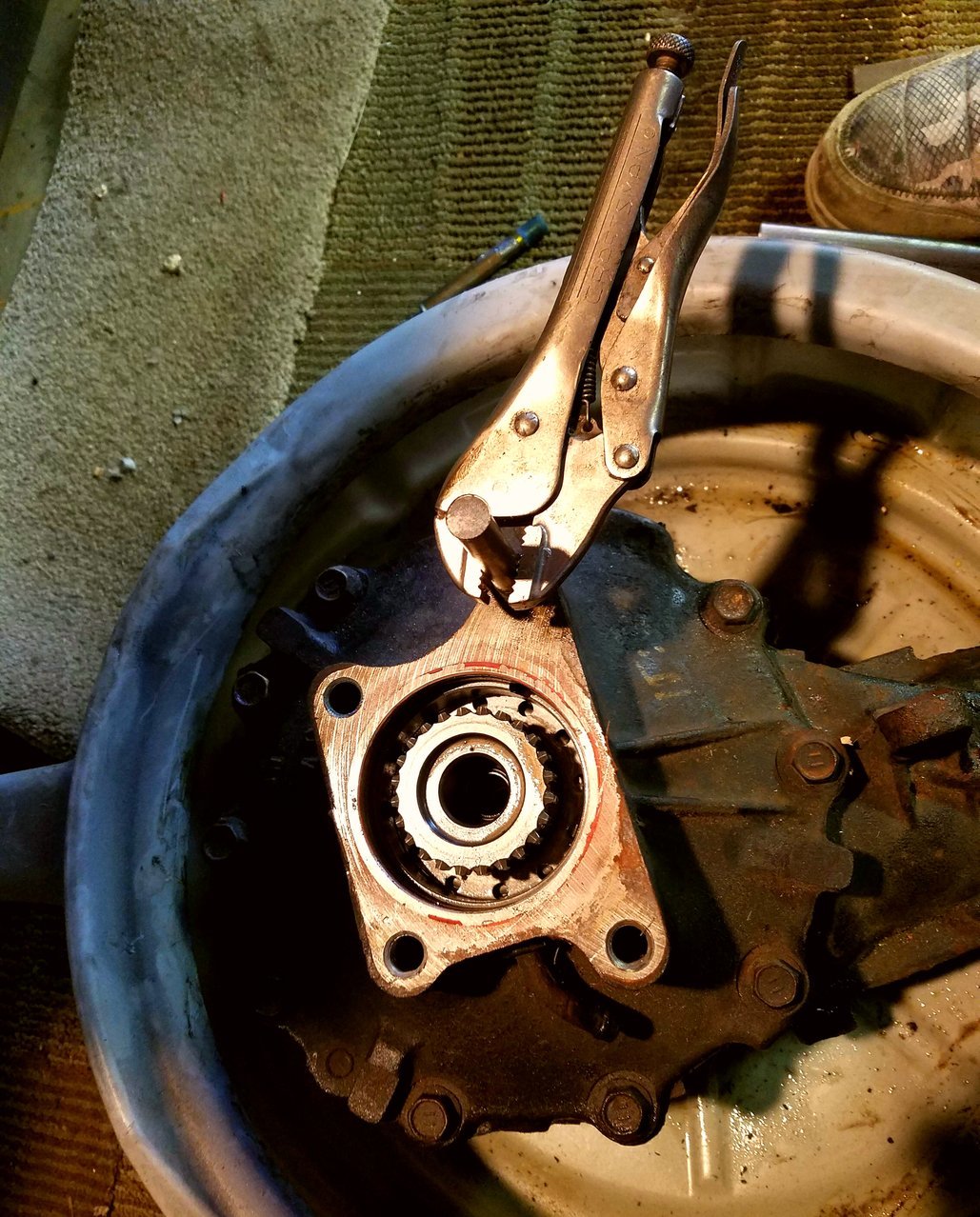

    @BartMaster1234 Give this a try with a disposable wrench:
    jubei, Adude, jjsul and 3 others like this.

    Another possibility if you haven't cut off head. Clean slag off of bolt head and drill the smallest hole possible through the bar so it will fit over what's left of bolt head. Knock bar down onto bolt head remainder then run a weld bead all the way around. This method should allow good weld strength. Also before trying to loosen, use the torch on the case (as suggested by @Speedytech7).

    I think another issue was that the welder wasn't getting enough penetration - I only have a dinky little 120v Lincoln Electric MIG welder. I ran out of shielding gas and haven't been able to get more gas so I've been using flux core wire.

    Just went through this but with 2 of the 4 bolts.
    Grind the tops off
    Pull the stub shaft off
    Grind 2 sides flat and remove with a good vise grip

    Not surprised someone else had to go through this! Unfortunately the stripped bolt I have is the really short 1 inch one, not the long ones. There's still some bolt shaft but not much.
    Why'd you have to remove the axle tube?

    I feel like the method I posted still might work even if you aren't getting the best penetration. This will essentially form a socket around the item with molten metal. At least that's the theory.

    I would drill and tap it then.

    Ah I see, so drill a hole in the angle iron the size of the bolt head into the socket, weld it down, and use it to break the bolt loose?

    One of the reasons why the bolt is harder to remove after welding on it is because you're adding heat to the bolt, and not to the surrounding diff housing. This is the opposite effect of what you want to do, and actually makes the bolt tighter in the threads. If you do weld it, wait until it cools completely, then heat just the outside of the diff housing before trying to remove the bolt.

    How would you weld one? They're mostly plated with something like chrome

    a 6011 @75-90 will burn thru all the rust/coating, as long as the metal is steel. If you have DC you can burn 7018, these are full grown men though :welder::sawzall:
