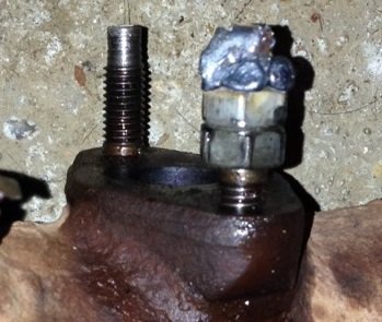

    yea...:fistbump: I had an exhaust bolt that never came out, turns out toyota made it out of stainless steel :annoyed:. The bolt is still right there...yours on the other hand will come out, there's some solid ideas posted. Good luck with it!
    Here's one pic of the two nut stud removal...this works with the right weld

    set the lincoln handy mig as hot as your flux core wire will handle...bump it up to 8, 9, or 10, then test weld on scrap. If the wire vaporizes, ease the setting down and test weld again. I think the max is 70-80amps for your welder, so you're gonna need to crank it up as much as possible to burn into a grade 8. :transformer:
