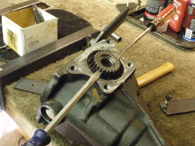

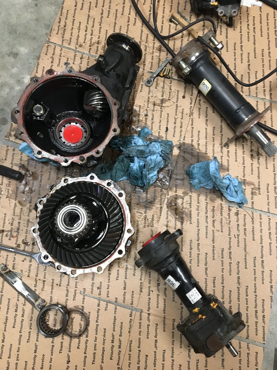

    That cheap harbor freight tool set was the best $30 I have ever spent. I welded the 1/2 inch drive wrench to the Bolt and welded the everliving hell out of it. They're so cheap they didn't even have any coating or plating on it so it worked to my advantage - nothing to burn off. I heated up the surrounding area with a torch too so that helped.
    Now what sucks is the damn manual jackshaft doesn't even fit! The ADD shaft uses a gear drive while the manual tube uses a shaft with splines. Anyone know how to make it work?

    the add stub can be pryd out.

    No snap ring or anything? I just pry it out?

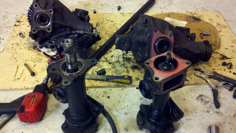

    Take a look at this thread: https://www.yotatech.com/forums/f120/front-differential-swap-auto-manual-hubs-246850/
    From what they have said you should be able to just pop that gear out and the manual hub will fit directly into the diff.

    Looks like the stub shaft has a circlip on the end but it would be like a CV, just pull till it lets go.

    Well after all that hard work with the stripped Bolt, the front differential isn't even the right gear ratio. I counted 41 teeth on the ring hear and 10 teeth on the pinion. 41/10 is 4.10 - my truck has 4.30 in the rear.
    Should I buy a front differential with 4.30 gears, or replace the rear differential with a locking 4.10 one?
