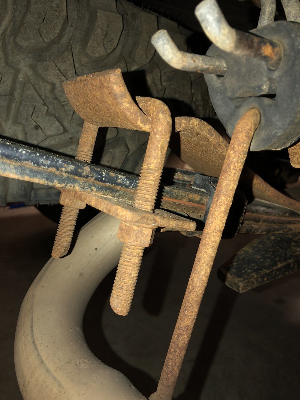

    Question: see photo please. Looks like a helper leaf. Does that stiffen up the ride or have an effect on the ride while bed not loaded? Thanks for your help! image.jpg

    It'll stiffen it no matter what, but you'll feel it less unloaded.

    Cool. So can I take this off then. I am not planning on loading it. Thanks again!
