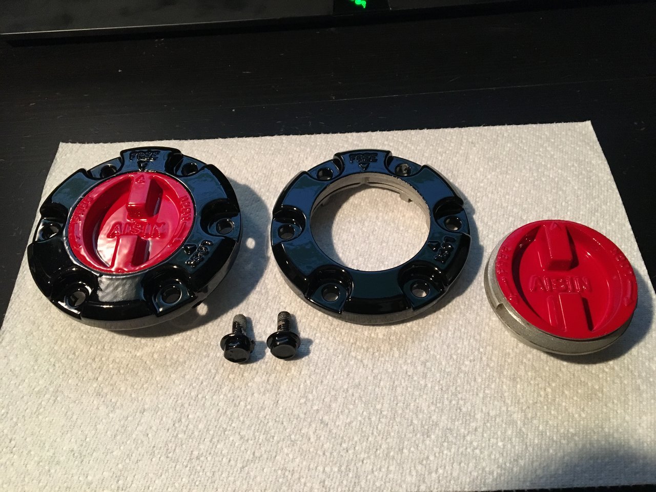

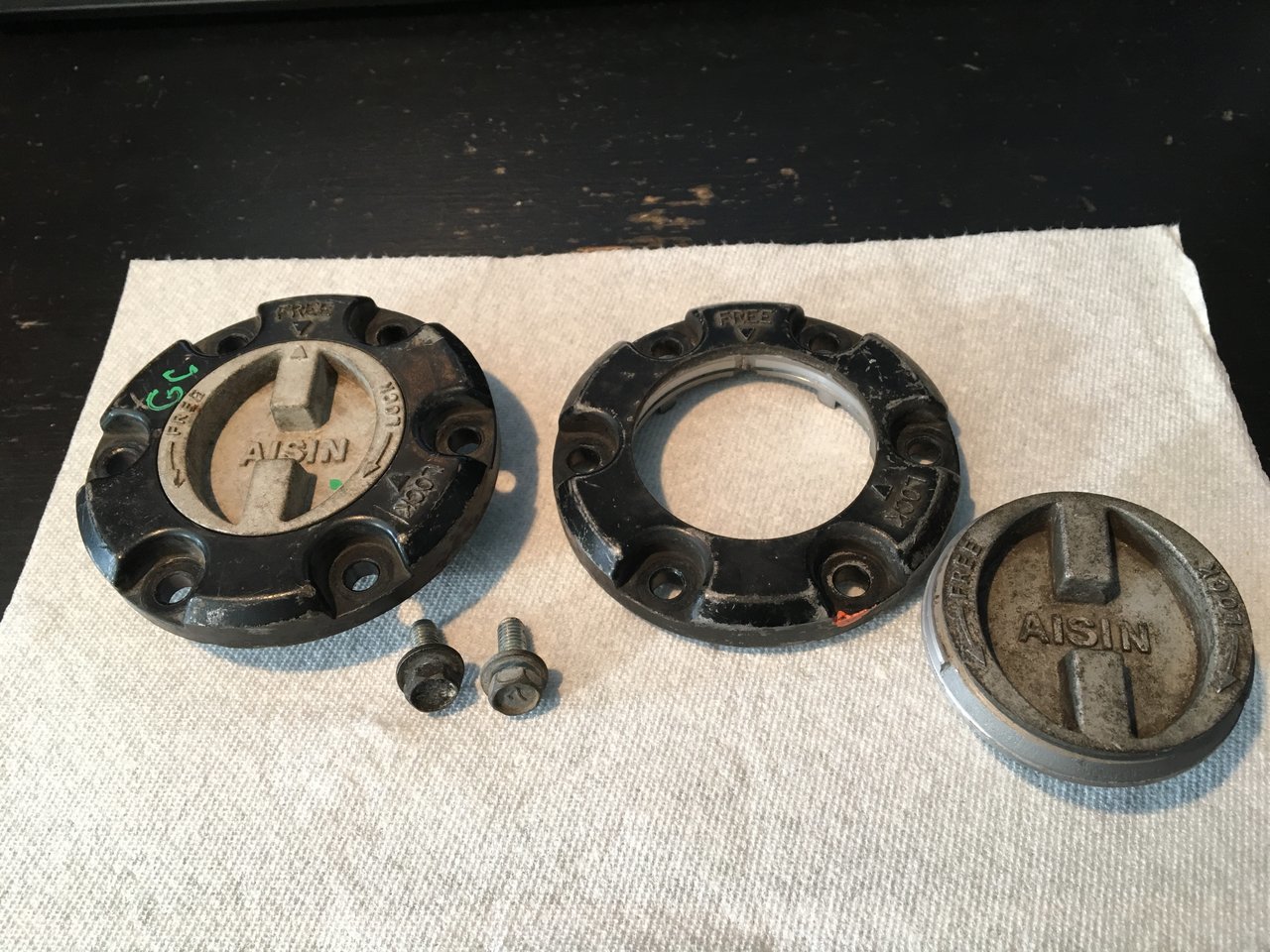

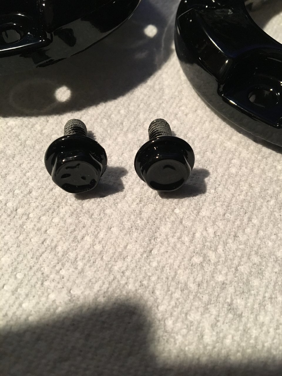

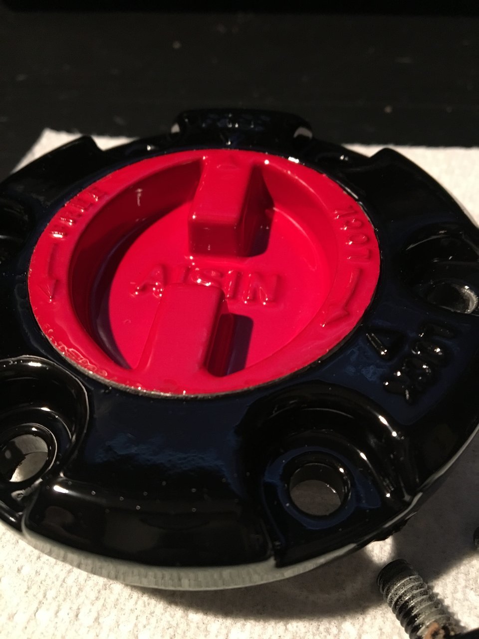

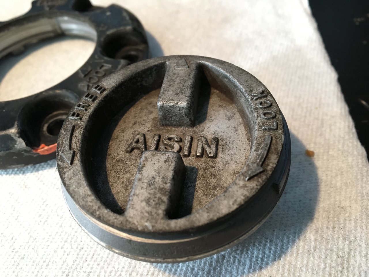

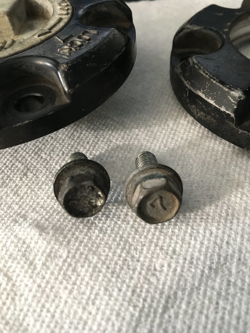

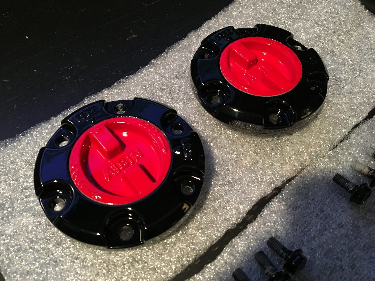

    I had my AISIN Manual Hubs powdercoated black/red in preparation for my 4x4/PreRunner swap. Paid a total of $115 for both hubs and the bolts to get sandblasted and coated.

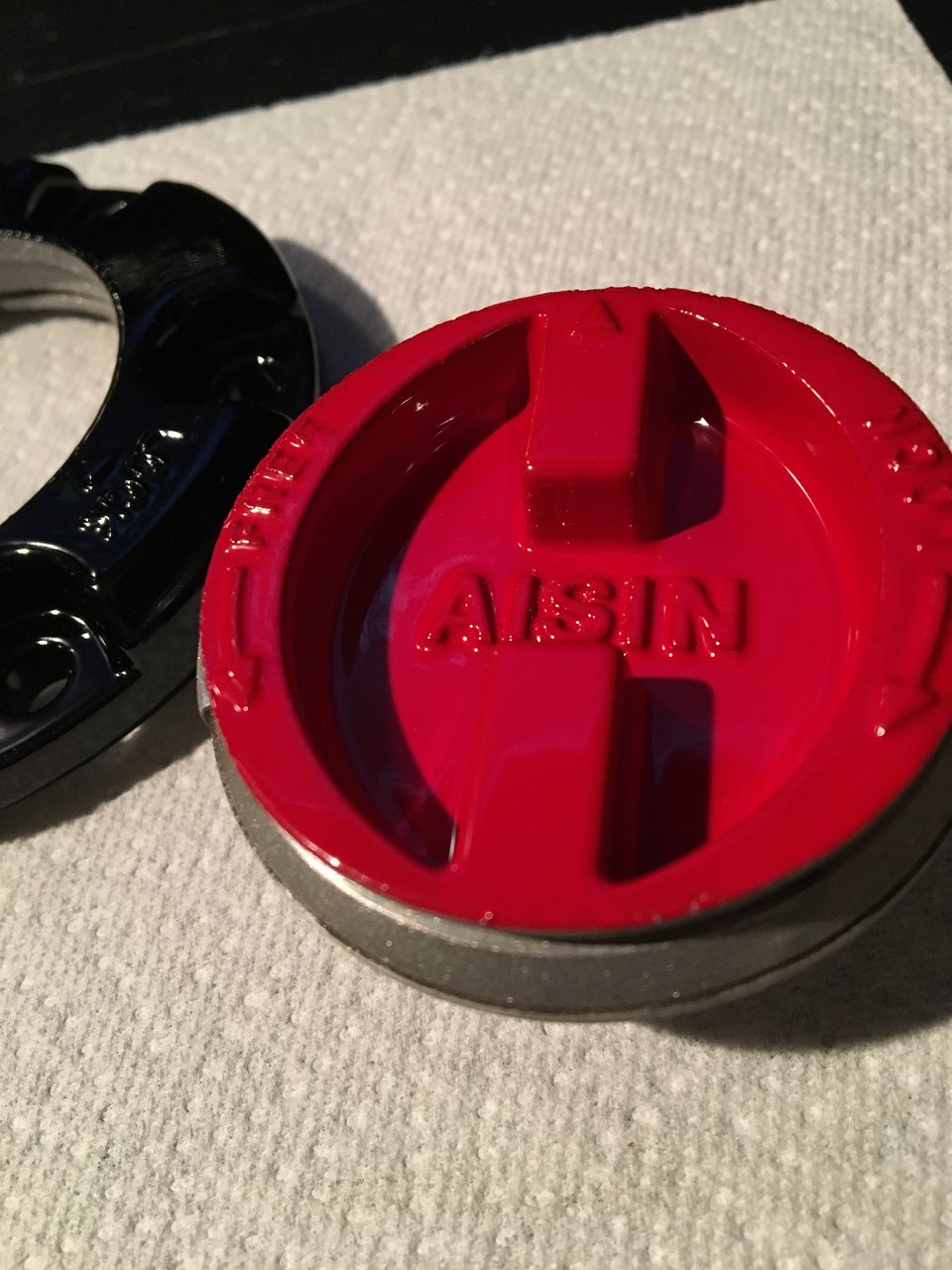

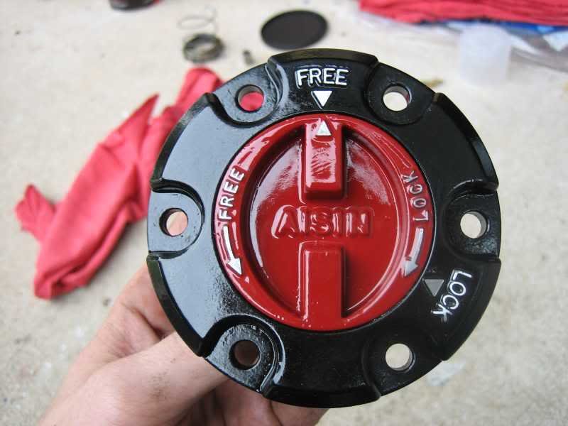

    Those came out really nice! I would take some sandpaper after masking around the letters and then sand the letters to give them the nice machined aluminum look. Like this...
    182073d1501885158-aisin-locking-hubs-tea_b9ce2ce49711bbeeb439877d6c2880df44f4e314.jpg
  16. Nov 23, 2017 at 1:34 PM
    BartMaster1234
    Aug 21, 2016
    #195197
    45,868
    Tyler
    Pittsburgh, Pennsylvania
    Flux Capacitor
    Yeah! I wanted to got for that look. I was going to try my hand at paint, but brushed aluminum looks a lot better. Don't know how easy it would be with Powder Coat though.

    Should be as easy as making around the general area (not each letter that would be insane) and then turning them upside down and rubbing back and forth on some sandpaper.

    Think I might do it to the AISIN logo too. That would look awesome.

    That would be possible if you have an ultra steady hand and a dremel

    That'll be a little nerveracking since you can't fix powder coat. Oh boy.
