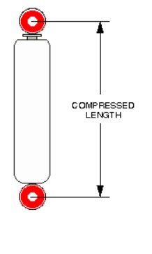

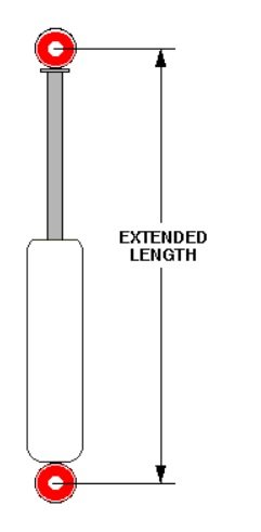

    You will have to disassemble the leaf pack down to the main leaf to be able to properly cycle the leafs and get the collapsed measument. Make sure to add a block/spacer to a count for the springs you take out. You don't have to take them apart to droop the axle out just to jack it up. I like to go a little negative with my leafs but others will say no negative. Where your happy is where you put your bump stop compressed.
    Just put jack stands under the rear bumper/frame and take the tires off and lower the axle for the extended length.
    The measument you need is from the middle of the upper shock mount to the middle of the lower/axle shock mount. One when the suspension is all the way down and one when the suspension is all the way up. That is collapsed and extended measurements. Look at the measument on the shocks you want and you'd rather have them 2 inches to long than short so you don't over extend the shocks. But you don't want to big of a shock or else the shock body is to big and won't compress enough.
    So with all that said you need to have an idea of where your shock mounts will be to be able to measure for them if your doing new shock mounts

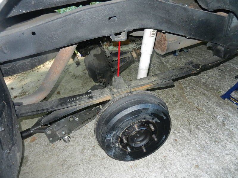

    In the picture below measure were I drew the red line on your truck and then measure from shock mount to shock mount. Take those two numbers, subtract the measurement where the red line is from the measurement of your shock mounts and that number will be the shortest length your shock can be when it is collapsed.
    For the droop length jack your truck up and set it on jack stands on the frame so you rear wheels are off the ground You may have to take your wheels off so they dont touch the ground. Then measure the length between the shock mounting points and add at less a half inch to that number and that will be the number for the fully extended length.
    Take those two numbers and find a shock that is shorter than the small number when collapsed and a little longer than the longest number when fully extended.
    If you use the super bumps that will make the distance of the red line measurement shorter so you can run a longer collapsed length.
