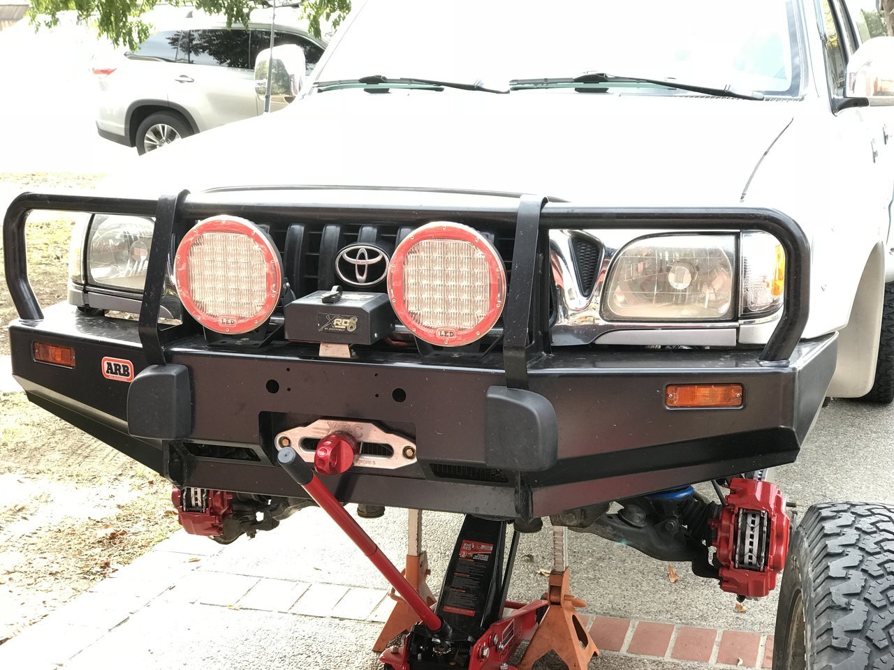

    Painted my tundra calipers red this morning

    I want some tundras! Lol I ordered brake lines yesterday. Now the hunt for some calipers for a good price

    You should try to get some I feel a difference right away in stopping power on my 17’s

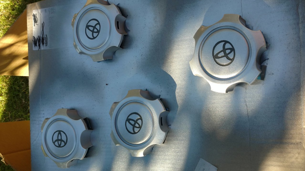

    3. I also decided to repaint the center wheel caps on my stock 15" alloy wheels. The paint around the lug nuts was completely gone from Discount Tire using the pneumatic socket wrench without taking the time to remove the caps. I sanded the parts with 600 grit sandpaper to remove some of the old paint and smooth the plastic where it was bare. I put down 2 coats of flat grey Rustoleum spray primer. I put down 2 coats of Rustoleum metallic "brilliant metal finish" spray paint. I got a small sample of dark grey paint from Home Depot and used a 1/8" detail brush to paint in the logo by hand. It's not perfect, but it's good enough. Then I put down 3 coats of Rustoleum satin clear enamel. I'm quite happy with how it came out! In the future I shall remove the caps prior to taking it to Discount to have the tires rotated.

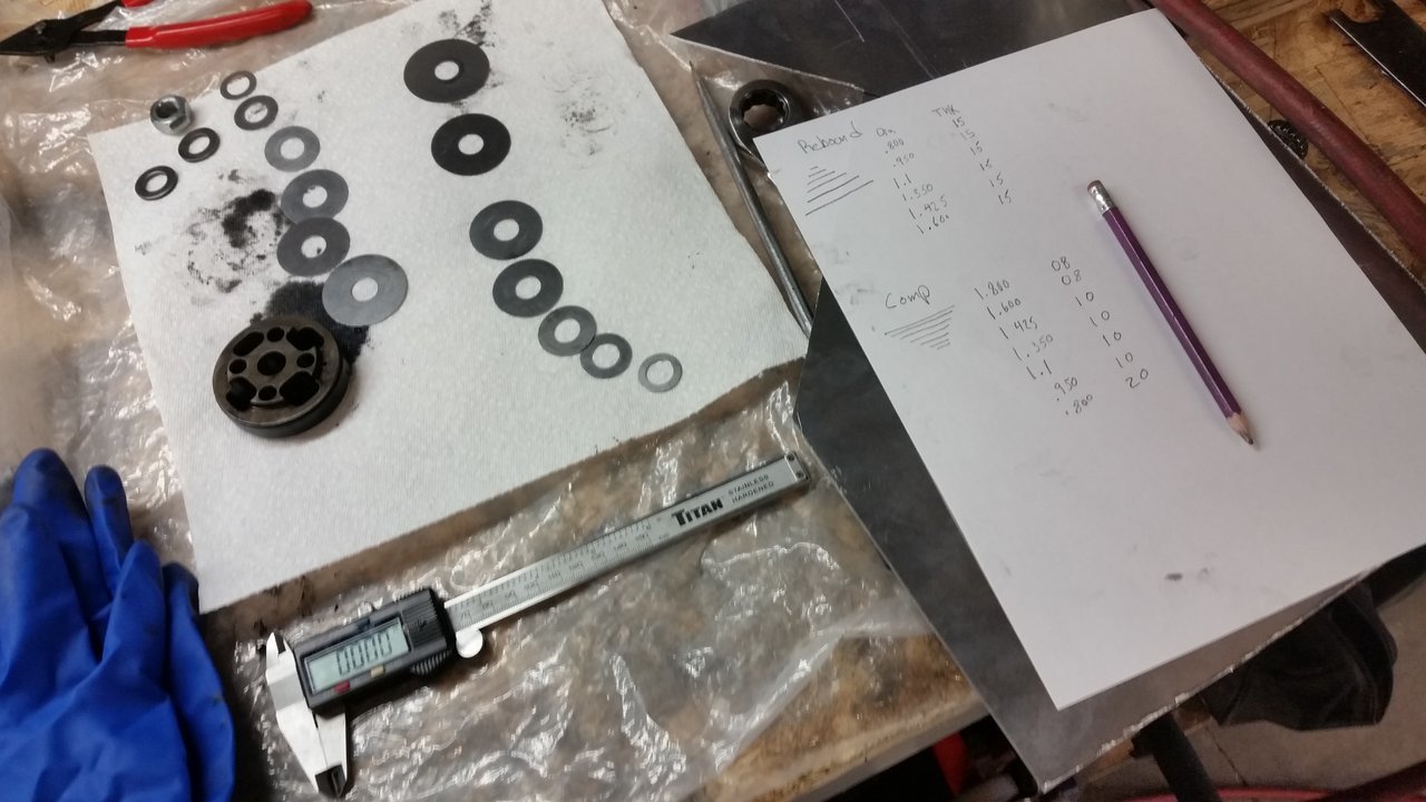

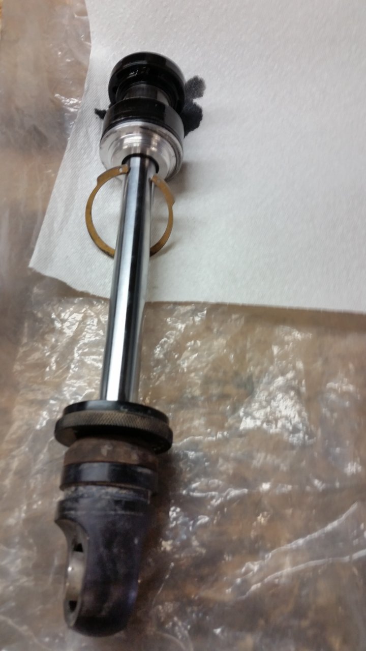

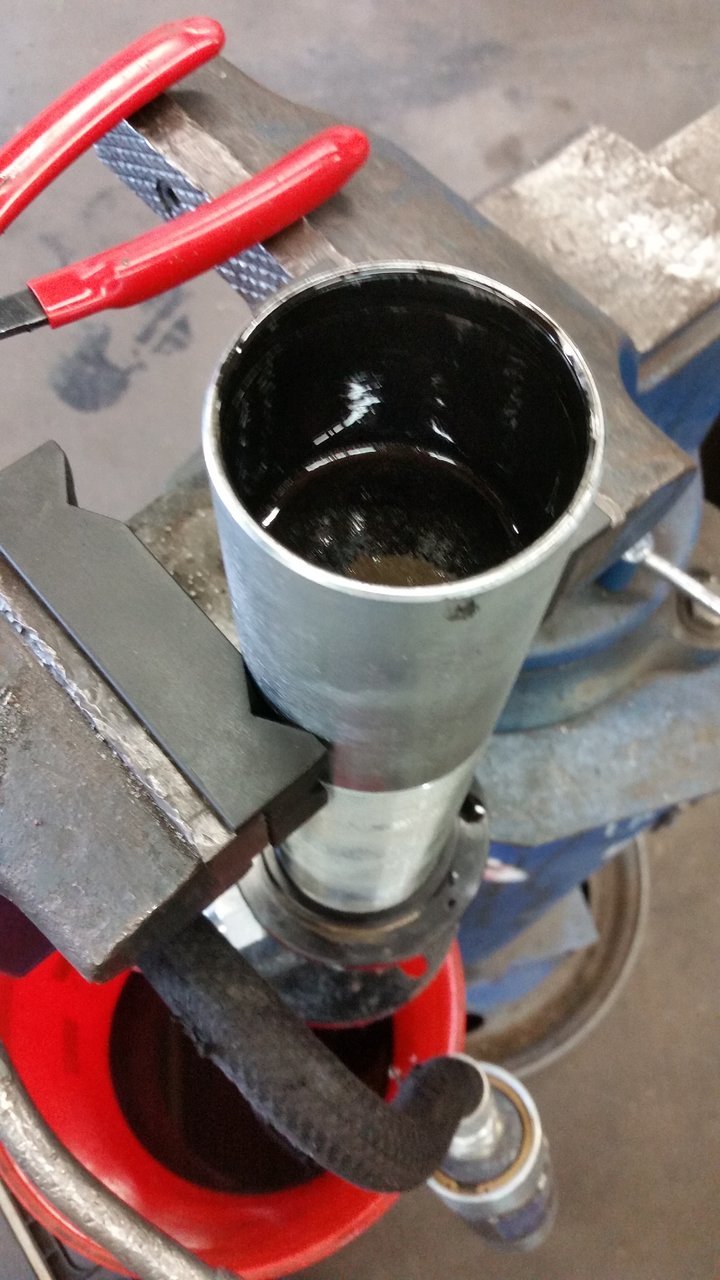

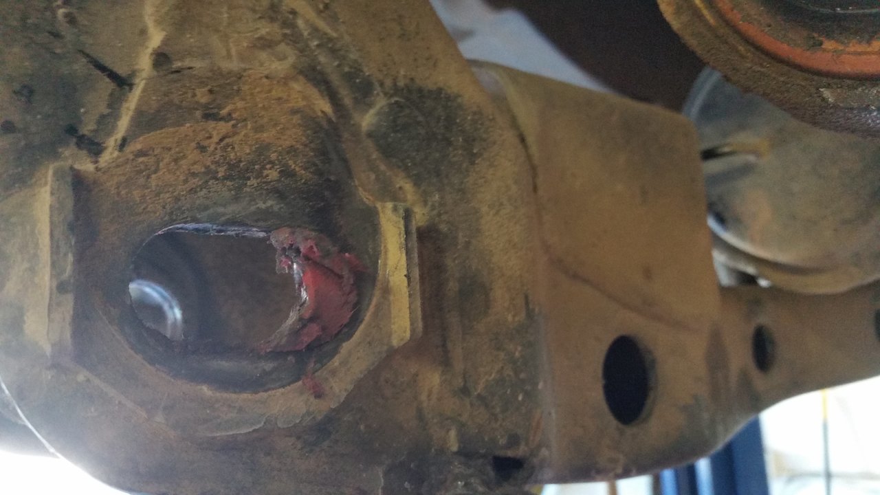

    Today I continued pulling parts off the Taco. Pulled apart the shocks to assess the current valving. I have enough left overs that I can revalve without buying more shims. The shocks had #40 Comp and #90 rebound. The front of truck was bottoming out fairly easy, so I'm going to move to a #60 comp with 1 flutter stack. I drove over to Sdhq and grabbed the rebuild kits which have all the O-rings and bands. I'm glad I'm going through them, the oil looked terrible.
    When I took the arms off I noticed the bushings were pretty torn up, with alot of material chillin in the cam adjustment slots. Sdhq didn't have a full bushing kit available so I might have to look elsewhere.
    I have other plans this evening, so repairs will continue another day.
