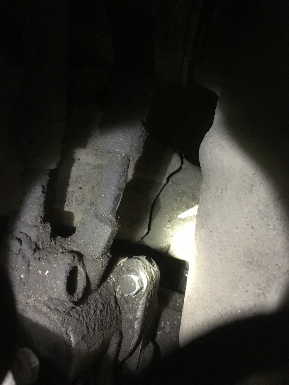

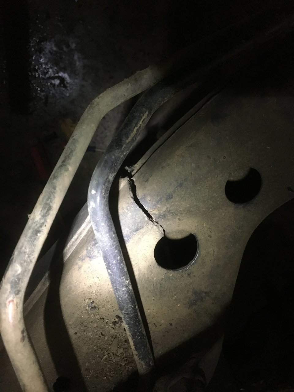

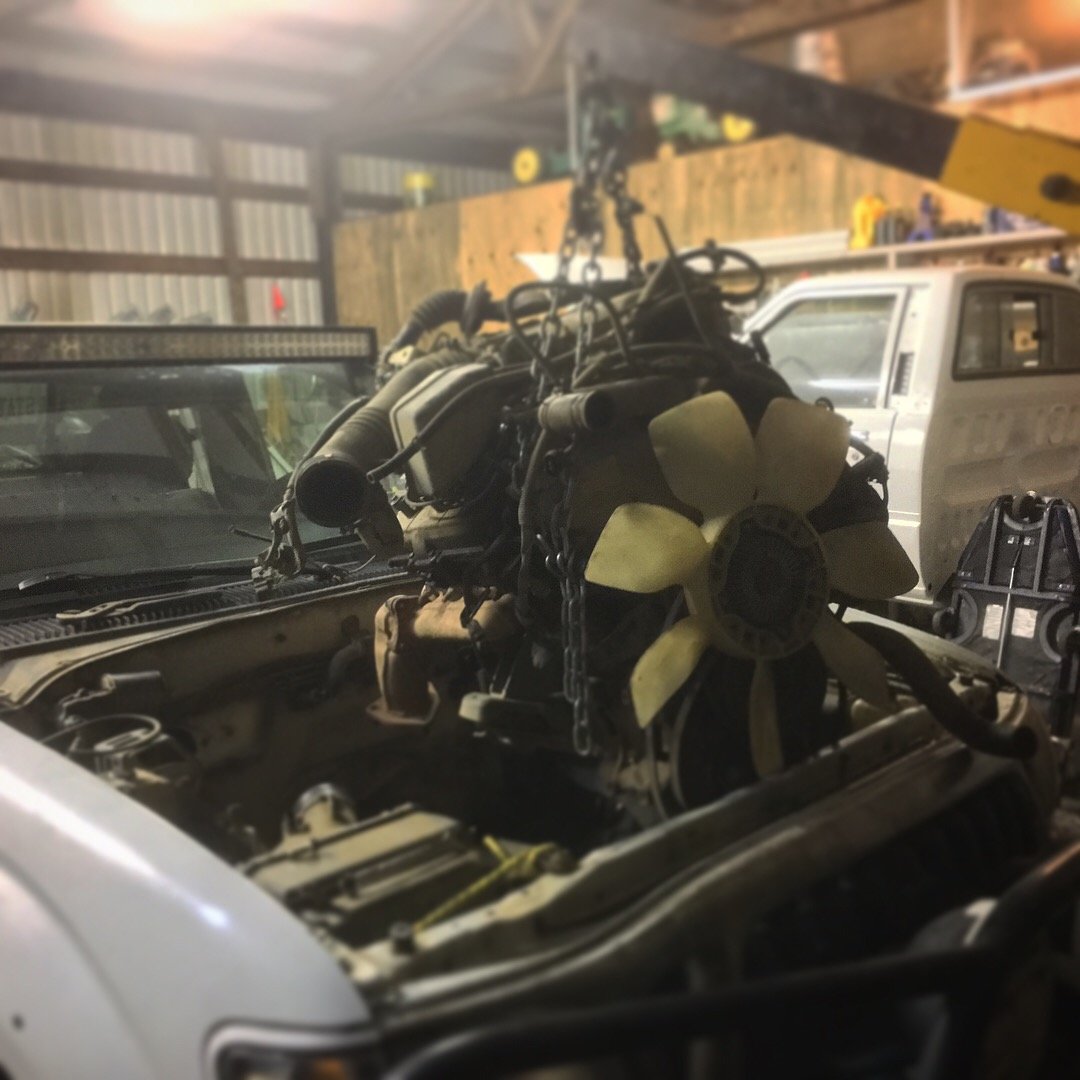

    Taco Tuesday engine pulling to get to my broken crossmembers

    Wow. That looks bad. Was the truck making noises before you were aware of the cracks?

    Nah, I sent it. Cracks immediately happened.

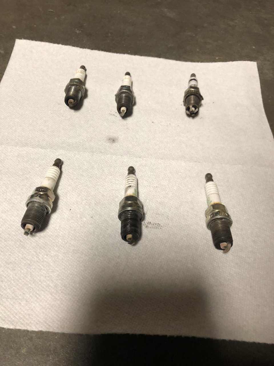

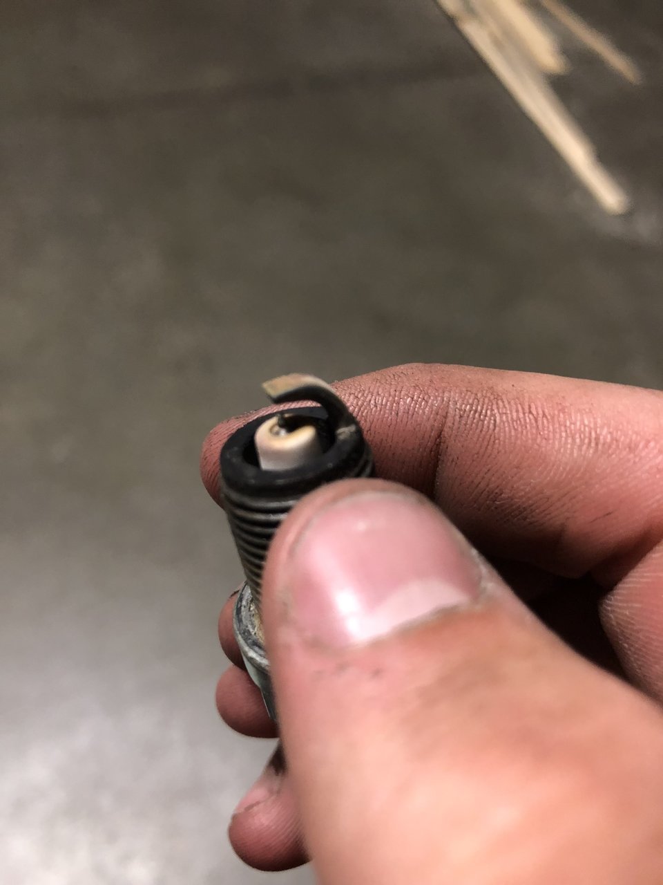

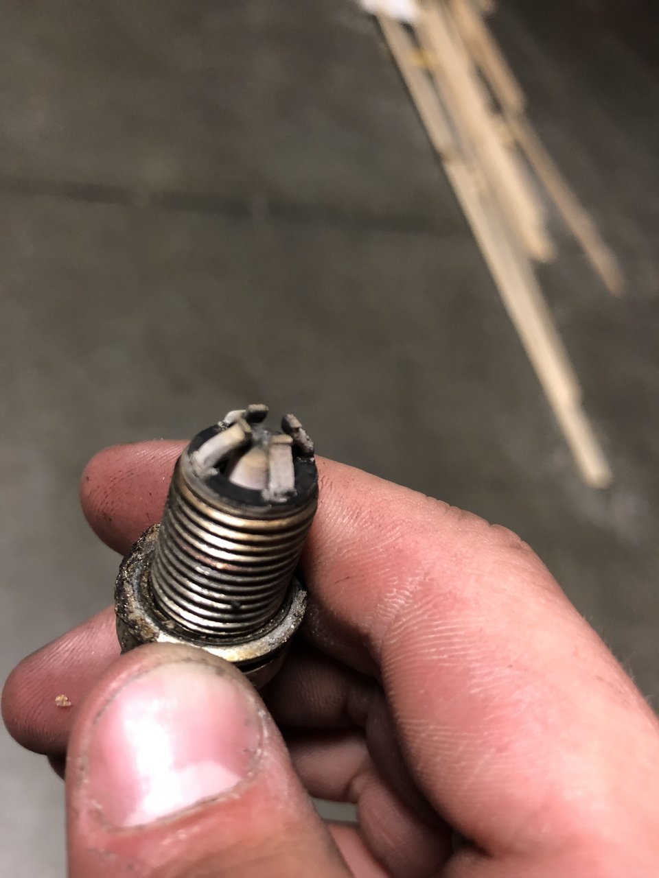

    Had to change spark plugs and wires today because it started to misfire (long story is below)
    For some reason who ever changed them last only did 5 of the 6. As you can see one of them is a quad electrode and the others are single.... :annoyed: And to top it all off 3 and 4 were super stuck in there and doubled the length of the whole project.
    EF732B3B-304B-4B80-9FFD-CE6A81070497.jpg 05F57A25-80D1-4520-AB17-56B4F557C642.jpg
    Long story:
    Dad called me and asked if I’d go to the parts store to pick up an IAC for his F150 and while on my way there my motor starts shaking really bad, no codes though. So I get his IAC, I grab a new air filter for mine and some injector cleaner hoping it was something dumb. Well as soon an I left the parking lot I get a misfire code on 2. Back to the store but of course they didn’t have any dual electrode plugs and said I’d be okay with single (I’m sure it would have been since that’s what came out of the truck). I got the wires there though. So I limped my truck home on 5 cylinders and waited for my dad to get home so he could drive me to a different parts store with the correct oem denso plugs, mind you this is all at 8pm. I got home and did the great car shuffle, we have 6 vehicles and only a 2 car garage which is also where I work on all my vehicles. Got the wires pulled and started working on pulling the plugs. Cylinder 6 was easy, 4 was a bitch, 2 wasn’t that bad, 1 was good but I somehow snapped the bolt that holds down the coil pack, 3 was a :censored:nightmare, and 5 was easy. Put the new wires in and started right up. Took her out for a 20 mike drive to make sure she was good. All in all took about 3 hours since it was my first time and some of the plugs were stuck, I could easily do it in under and hour next time.

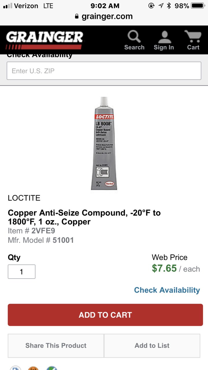

    I hit frame and rear axle with a pressure washer and a wire wheel to knock the big rust off then hit it good with some Fluid Film. I think I'll paint it when I do my lift but fluid film is nice and easy and protects really well

    make sure you put some anti seize on them!!!!

    Ehhh I’ve heard mixed things about that whole deal. I’ll probably just change them out more often since it’s super easy to do. I’m assuming the guy I bought it off of didn’t do them and he got the truck at 167k and it now has 257k.
