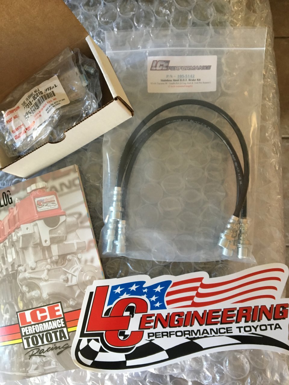

    Got these babies in the mail from LC Engineering today! Doing my Tundra brake upgrade this weekend.
  7. Nov 29, 2017 at 1:30 PM
    Blackdawg
    Blackdawg Dr. Frankenstein
    Dec 31, 2010
    #48500
    81,652
    Monte
    Wyoming/St. Louis
    The Trifecta of Taco's
    your aware that the LCE tundra kit is the 199mm ones yes? And that is why your front brake lines don't have banjo bolt ends because the 199 calipers use a small hard line that comes out of them.
    I think those will be too short to use even with an adapter.

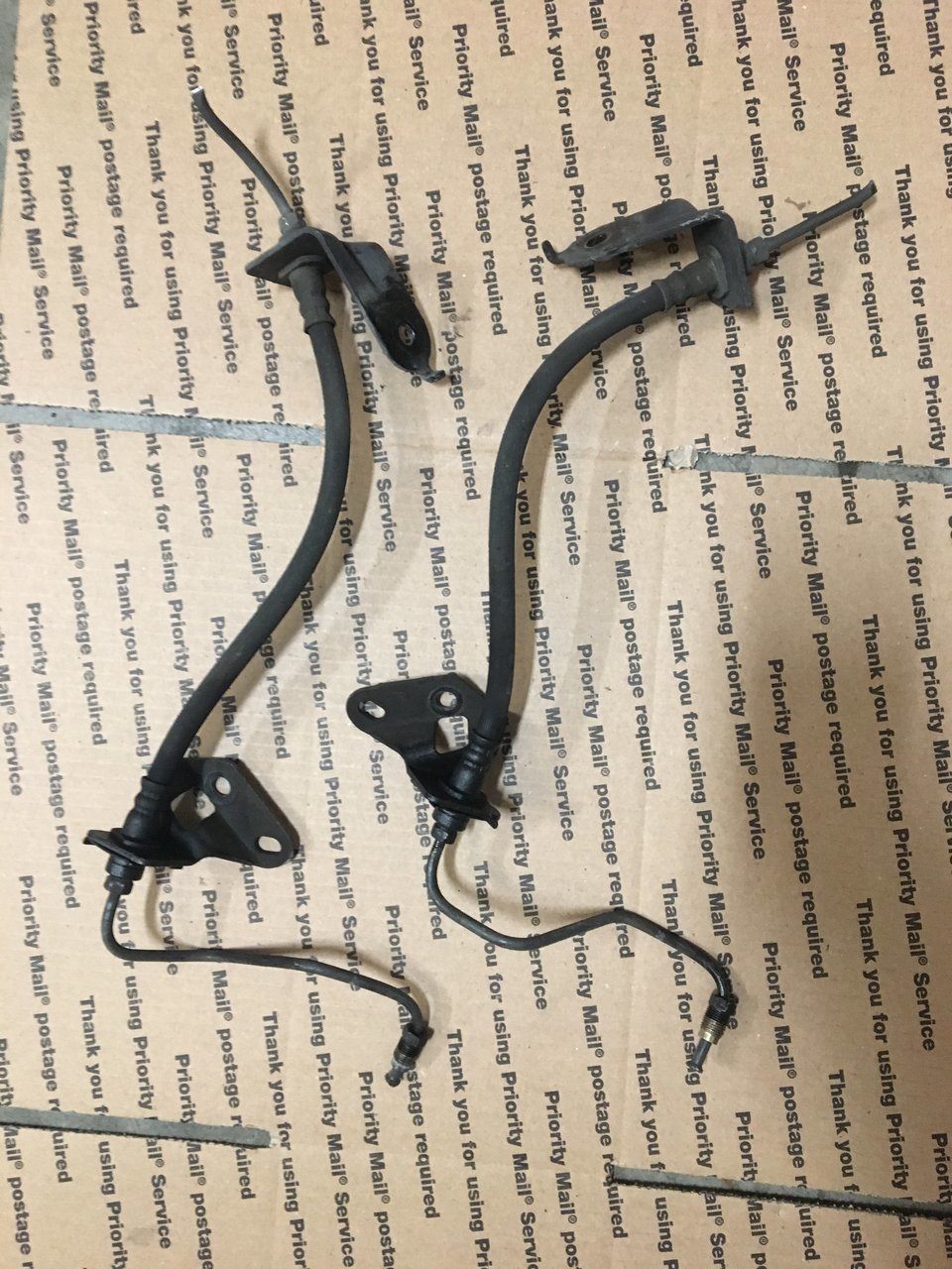

    Don't the 231mm calipers use the hard brake lines too?

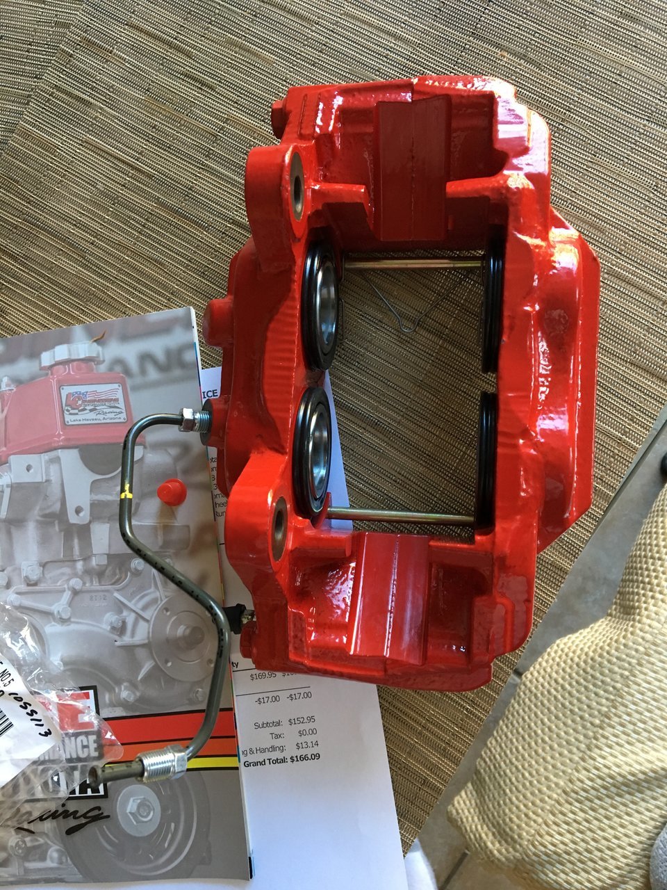

    These are the brake lines I took off a Tundra with the 13WL. They look the same to me.
    I just tried it on the caliper. Seems to fit fine, the bolt is a little too long but that's how it looks on the stock 13WL lines I got from a Tundra.
    13WL Stock Tundra Brake Lines

    The 13wl calipers technically should use a hard line as well, the larger banjo bolt just happens to work. Those lines do look awful short though.
    Edit: just saw that he got the hard lines as well.

    I have no idea. I bought them from LCE with the 'added 3" length option' so the lines are a little longer than stock length. I sold a pair of Tundra brakes from a 13WL truck last week and the hard lines look identical to me. Can't speak for lengths since I don't have them anymore.
    The hard lines from LCE fit just fine on the 13WL calipers.

    If you have the hard lines you should be okay.
    But I seem to recall that there is potential for clearance issues depending on the wheels.
    Give it a go though!
