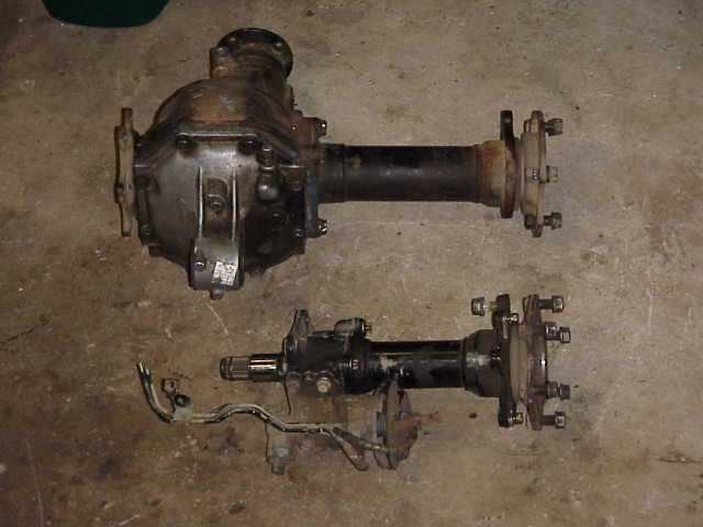

    As seen here, the diff sits on the passenger side on these trucks:
    vs our front diffs which sit on the driver side.
    [​IMG]Front Locker-11.jpg by Monte Nickles Photos, on Flickr
    This makes our diffs reverse cut gears. Because the rotate the opposite direction.
    So no, the ring gears are not compatible.
